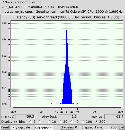

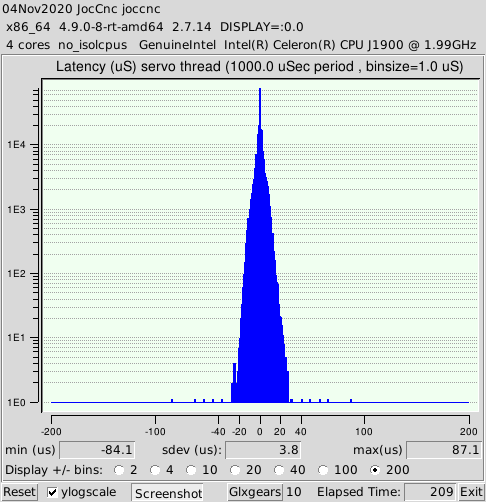

04 Nov 2020 10:41 #188321 by Jocman
Replied by Jocman on topic Joint following error
I tried both commands
The first gave me a Max Jitter of 22845; then when I started the browser to write this post, the value raised up to 168149 (no glxgears instances)
The second command (with 10 instances of glxgears): 1st test without browser, 2nd test with browser, 3rd test only browser (no glxgears instances)
