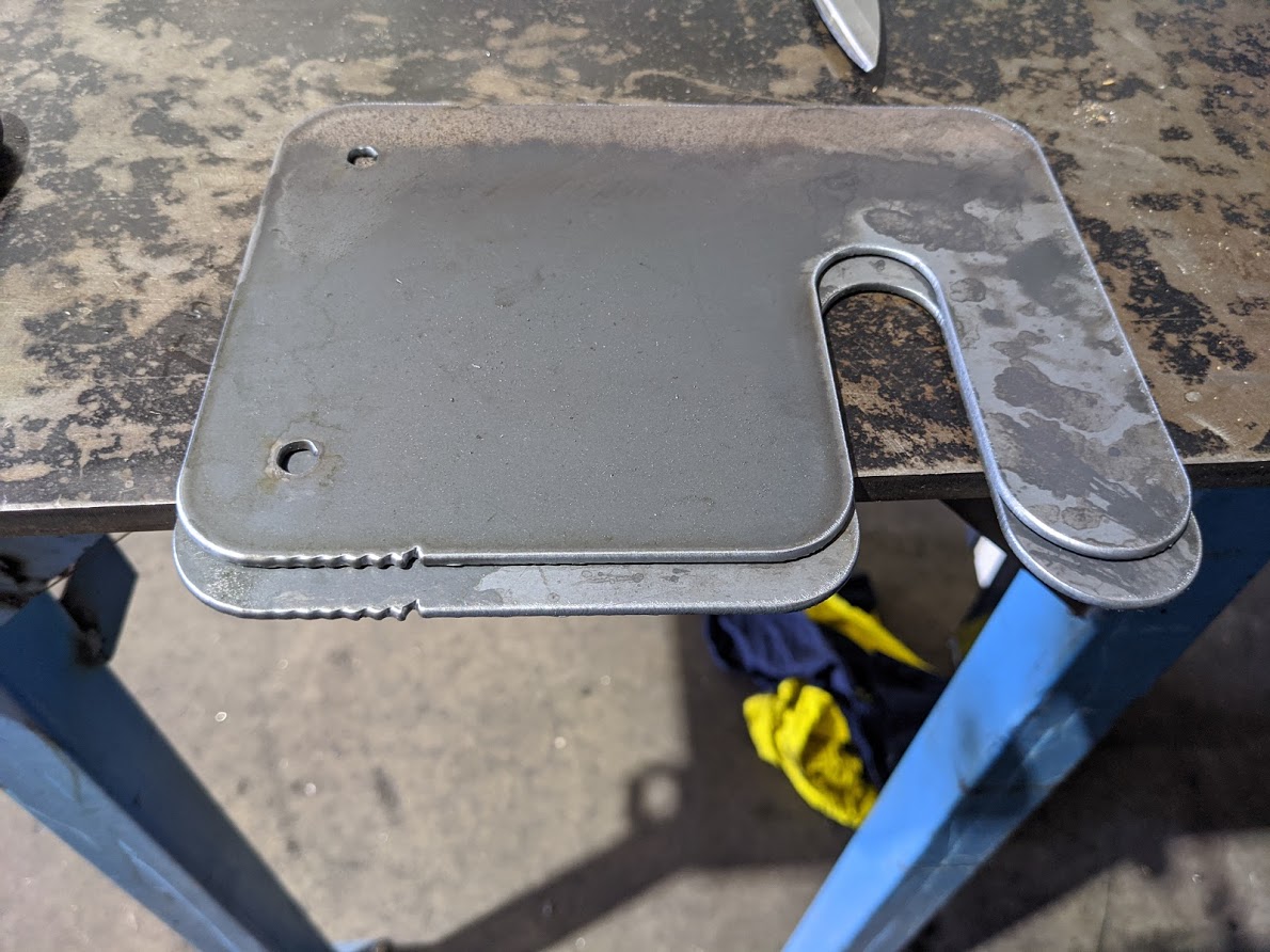

Replied by rodw on topic Tuning an open-loop system
Here is a good example of acelleration induced machine that is not stiff enough. In this case 0.5g acceleration with a lead into a notch to denote a fold line. The rapid reversal in direction from near 0 degrees to near 180 degrees to the x axis caused a lot of wobble.
If you are seeing this in a straight cut away from any change in direction and you are cutting along an axis, I would say it has to be the clearpath tuning.
