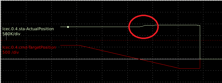

So, i've spent most of my day trying to figure out what is going on. I have hooked up alle 3 sets of drivers and servo's to see if there is any difference between them. Nothing. I've ran through all parameters for the servos(there are hundreds!). Nothing. I've tinkered with the scaling of the signals AND it moved! the tiniest bit, but i can move the servo...only like 1-2 degrees...but there is a pattern:
...which i spent a couple of hours trying to figure out WHY i cannot move it more than a few degrees...
I jog the axis and just as it crosses 0 the actual position changes a tiny bit...nothing happends beyond this... i've been thinking about overflows, softlimits, pid-values etc... but i need help with this one, i don't know where to start or look :-(
Anyone got ideas?
20 Mar 2021 15:56 - 20 Mar 2021 16:34 #203041 by db1981
Replied by db1981 on topic Rookie: Ethercat Servos wont budge...
hi,
more information is needed.
What Encoders are this, what resolution, increments per round ....
Your scops show ~1,5 millions increments, why so much?
and please post the values of the following pins, at the same point in time.
lcec.0.4.sta-actualposition,
lcec.0.4.cmd-target-position,
joint.0.motor-pos-cmd,
joint.0.motor-pos-fb

21 Mar 2021 05:00 #203095 by thomaseg
Replied by thomaseg on topic Rookie: Ethercat Servos wont budge...
Wow.... i feel kinda embarrassed about this, but i found the issue.... try to see if you can see the error here:
<pdoEntry idx="607A" subIdx="00" bitLen="16" halPin="cmd-TargetPosition" halType="s32"/>
Hint: The encoder on the servo is a 24bit absolute encoder....and i've set the bitLen to 16bit? yeah... that is going to overflow preeeetty fast...i feel stupid using like more than a week of sparetime trying to debug this... but at least i learned a lot about HAL and Servos in general :-)
I changed it to 32bit and the servo was (almost) literaly flying of my testbench! Note to self: Tie down those 2,2kW servos before trying again....yaiks...
