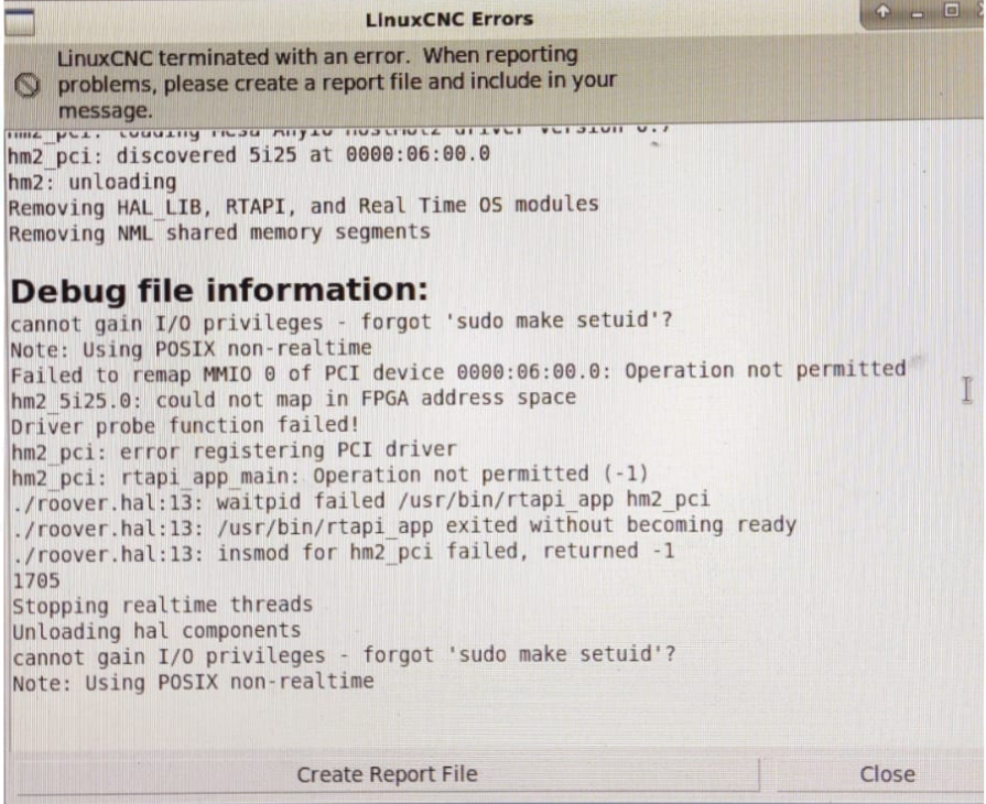

LinuxCNC 2.8.0 Debian 10 Buster PREEMPT-RT ISO does not recognize 6i25 mesa card.
Can I fix this?
if then how?

Which PC hardware works and which doesn't?
Note, the card is recognized but LinuxCNC has insufficient privileges to:
1. Setup real time priorities (this is why it says its using POSIX non-realtime)
2. Allow driver access to memory

Doaloaded from linuxcnc.org -->
Fresh install does not recognize mesa 5i25.

Replied by PCW on topic preempt rt buster iso Mesa problem
The 5I25 card _is_ found but as I said,
LinuxCNC is unable to:
What is the difference between the PC hardware that works and the PC hardware
that has the permissions issues?

It is a same pc same hardware.
No difference, same setup worked before updating to buster.
After new install from iso file, same setup just dont work.

OK that's a different error (not the permissions issue)
Did you do a
halrun -U
before running the test to make sure you don't have
leftovers from a previous test loaded?
Did you do a
halrun -U
