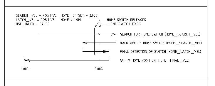

With the newly attached ini at post #1 (to not confuse others) it drives towards the upper end until it reaches the limit switch, sets the position to HOME_OFFSET and then states
However, I wonder why the coordinate is not exactely HOME_OFFSET but little more - maybe it tries to drive - but in the wrong direction. I tried to inverse HOME_LATCH_VEL to positive (HOME_SEARCH_VEL is positive too) and I would expect the axis to leave home switch and go back to it slowlier than (according to linuxcnc.org/docs/devel/html/config/ini-...witch_example_layout and the below image) but that does not happen.

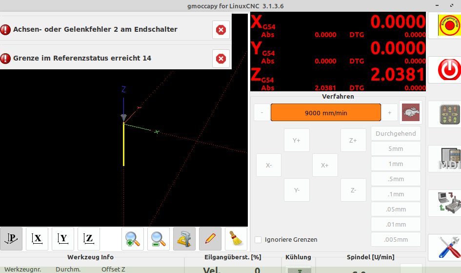

- anli
- Posts: 25
15 May 2021 13:48 #208954
by anli
Replied by anli on topic Problem homing z axis
I try to change gmoccapy to english but don't know how. HOME_OFFSET isalready. The picture is already taken with those values.
Yes, X and Y work as expected.
HOME_OFFSET = 2.000Yes, X and Y work as expected.

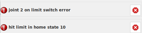

- anli
- Posts: 25
16 May 2021 05:40 #209063
by anli

Replied by Clive S on topic Problem homing z axis
Hi Norbert,
with the config
MIN_LIMIT = -190 MAX_LIMIT = 0.001 HOME = -10.000 HOME_OFFSET = 0.5 HOME_SEARCH_VEL = 8.000000 HOME_LATCH_VEL = 0.50000 HOME_FINAL_VEL = 0.50000 HOME_USE_INDEX = NO HOME_SEQUENCE = 0 HOME_IGNORE_LIMITS = YES
I get the following errors:
you have not put the - sign in
HOME_LATCH_VEL = -0.5
HOME = -10.000
HOME_OFFSET = 0.5
HOME_SEARCH_VEL = 8.000000 put a - sign in front will reverse the direction
HOME_LATCH_VEL = 0.50000 changing the sign will reverse direction
HOME_FINAL_VEL = 0.50000 Same here
I would make the homing slow so you can see what is happening
It should go to the switch and then reverse (back off the switch)
