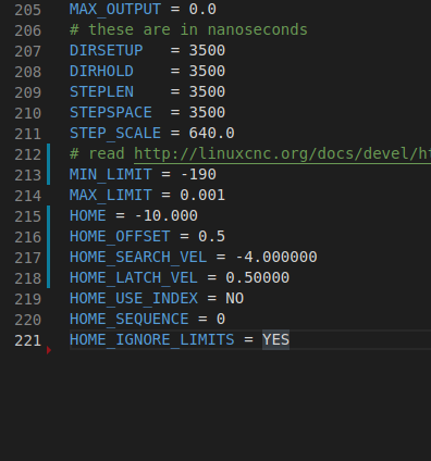

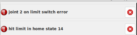

. With the config
I get the following error (10 changed to 14):
What happens is that it moves towards the switch (right direction) and then stops once it hits the switch. It does not move further. I also tried with HOME_FINAL_VEL being negative - although it states in the documentation linuxcnc.org/docs/devel/html/config/ini-...html#_home_final_vel that it has to be a positive number. But the error is the same.
Withthe axis moves towards the wrong direction.

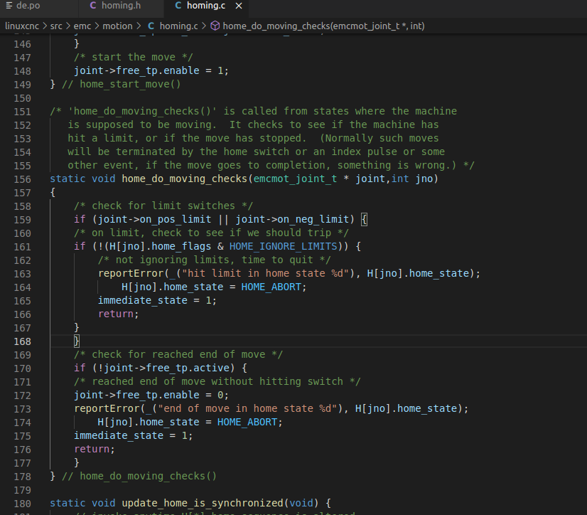

Ah, once I looked at the source I think I know where the problem is!
This is the place where the first message is thrown:
It should not throw this message because HOME_IGNORE_LIMITS is YES in my config. However it does.
This is my config:
As you can see there is no line break at the last line - which is HOME_IGNORE_LIMITS = YES. So I think the missing line break is the problem. I'll try and be back in a minute.

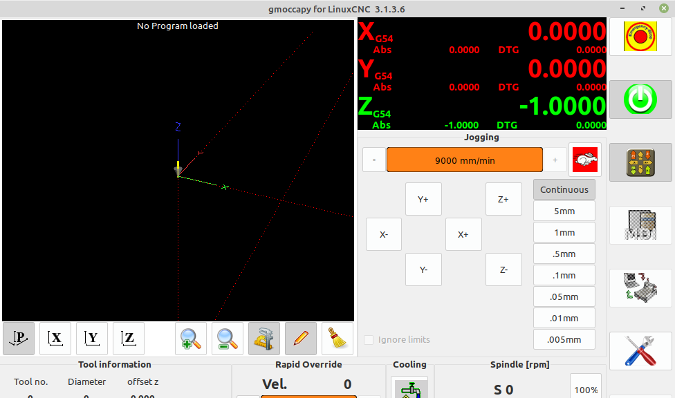

By the way, why do you have 4 digits in the DRO, being in metric mode?
Do you know it can be set on the settings page?
