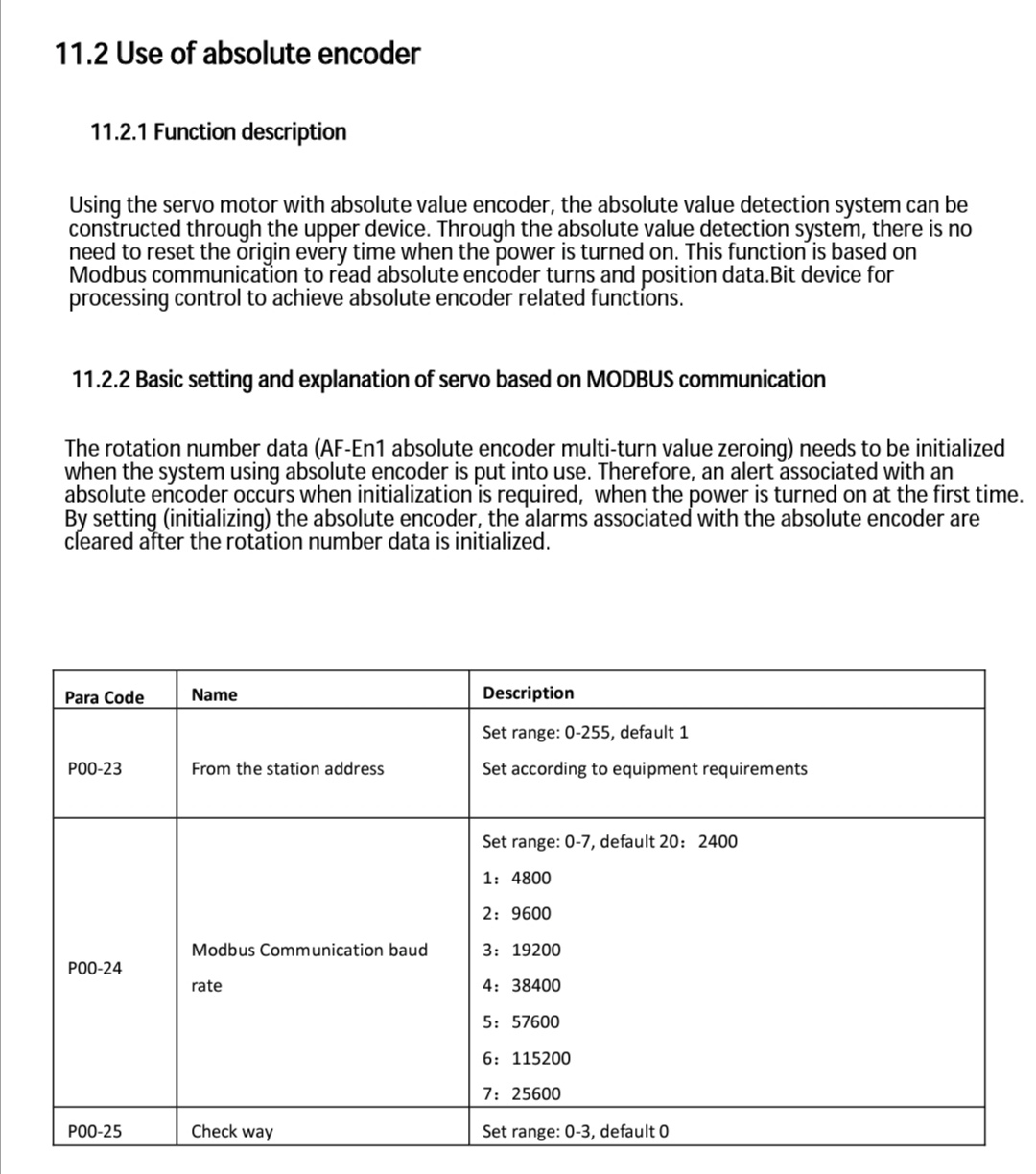

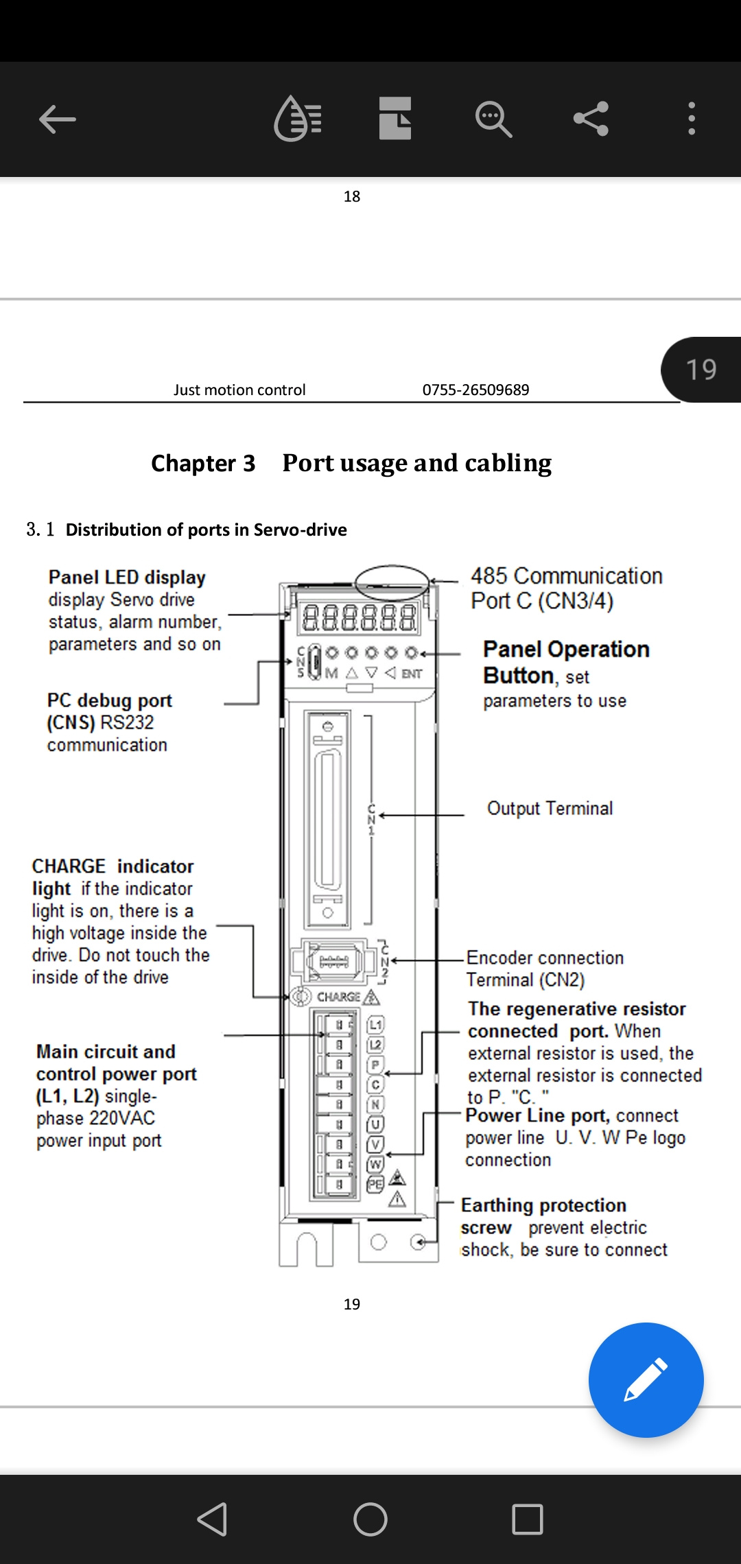

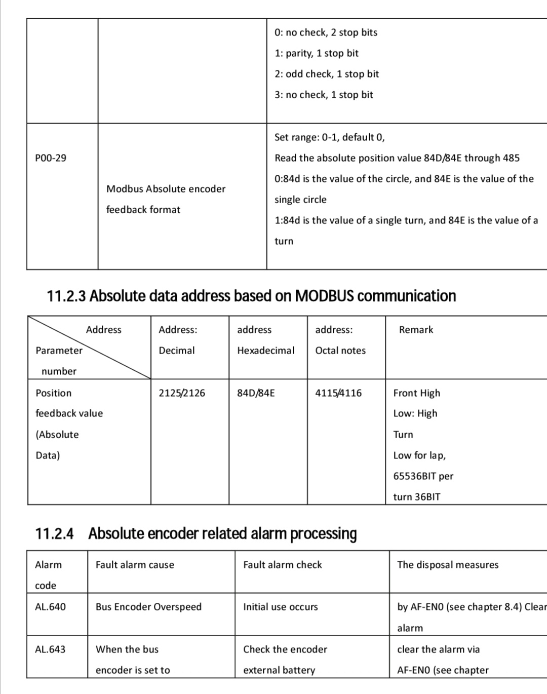

Attached 2 Screenshots aboute the absolute encoder chapter.
Ok I did some more research. I think I can extend my 7i76e with a 7i74 that supports RS-485 on channel 7. Then I can connect my servo drivers all in line to channel 7. Is there anybody who has experience with that? ?
