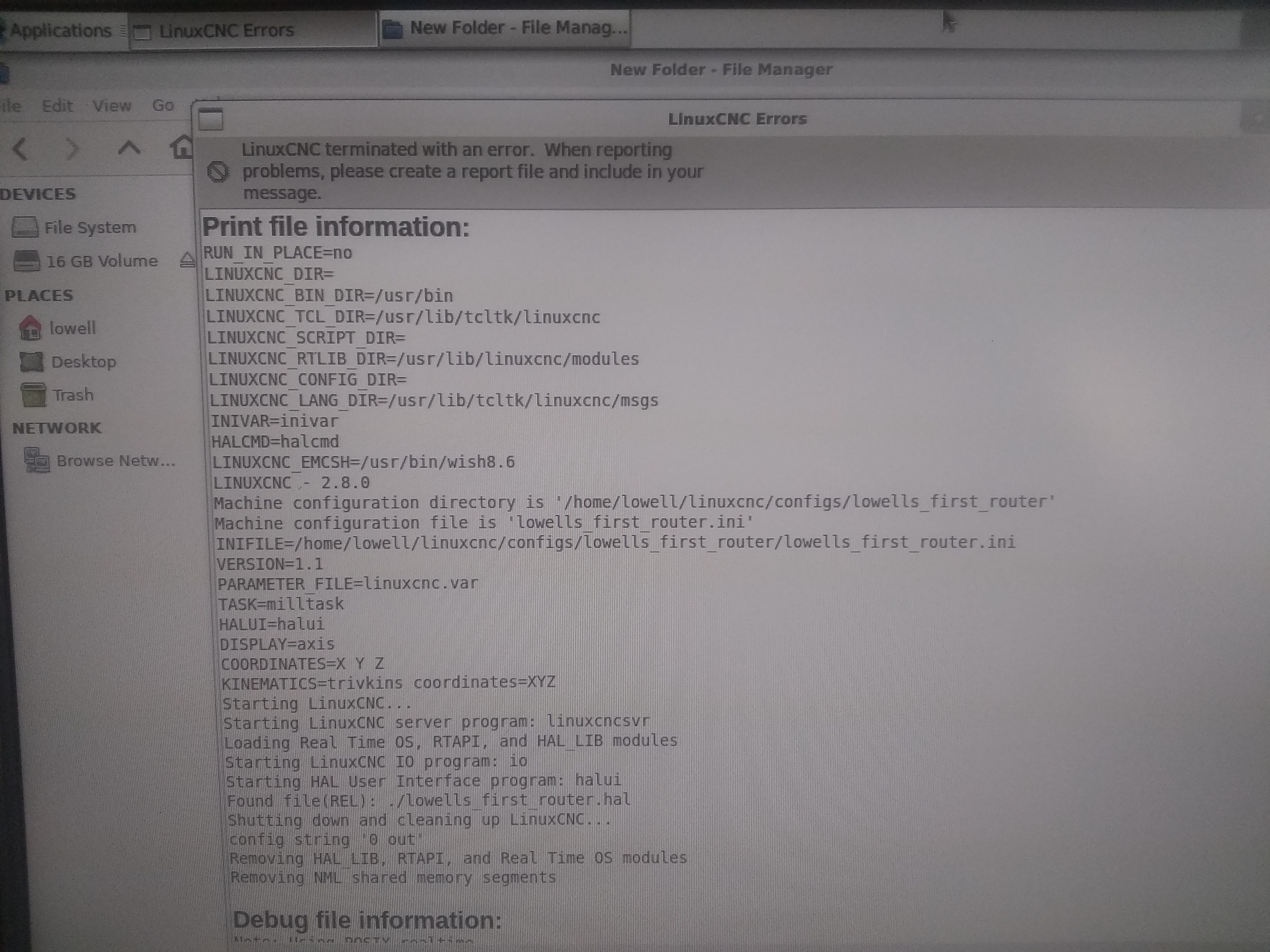

05 Jul 2021 16:12 - 05 Jul 2021 16:27 #213785
by BOOTSTRAPPYWORKSHOP
Replied by BOOTSTRAPPYWORKSHOP on topic Setting up limit switches and a bunch of other things
Okay, this situation is as follows :
I have the physical switch wired as a "Hardware Disable" in this diagram: www.cnc4pc.com/pub/media/productattachments/files/WS_239.pdf
There are three wires plugged into the physical switch. One goes to pin 10. One goes to 5v. The OTHER wire plugged into 5v on the switch itself goes to EN on the board. There are two leds on the board, a red light and green light. The red light is always on and indicates that the board is powered. The green light comes on when EN is wired correctly. When EN has the correct signal, the board works.
HAL doesn't care what the configuration of the ESTOP is. If I enable it at all HAL decides that it is either always on or always off, depending on whether or not I invert it in stepconf. When I invert it it is always off, meaning the LinuxCNC gives me green lights and everything works. When I physically kill the power with the physical switch, the board stops working so everything loses power and the green LED goes off, but LinuxCNC does not notice at all. I still have green lights on the computer monitor which I cannot turn red no matter how many times I click it.
If I do not invert ESTOP In in stepconf, no matter what I do I have a green LED on teh board but LinuxCNC does not see it and it will not let me do anything. There is no activity of any kind in the Watch tab.
These are my current hal + ini files.
I currently can run either the software ESTOP via F1, or the hardware ESTOP via the physical switch, but there is no way to run them both, and the physical switch will not stop GCODE from running while the software[F1] will. In other words, this is why I disconnected the switch and flipped pin10 to "unused" in the first place. Right back where I started.
LinuxCNC doesn't care how I wire the switch in, it just doesn't see it as even being there.

05 Jul 2021 16:27 #213790
by BigJohnT
Replied by BigJohnT on topic Setting up limit switches and a bunch of other things
The stepconf tool may not know how to setup an external e stop...
forum.linuxcnc.org/47-hal-examples/25861-external-e-stop
net estop-ext => iocontrol.0.emc-enable-in
estop-ext never gets connected to anything so it will never work. Looks like a bug in stepconf.
If you select simulated hardware it gets connected in the sim.hal file
JT
JT

K dumping that into the hal file. Will be back in a minute.EDIT: RESULTSame error I was getting with the other way. Also, was I supposed to modify the ini file? This is me only modifying the hal.
Okay will not let me attach the .report file, so here's the text:
Error report created by /usr/lib/tcltk/linuxcnc/show_errors.tcl:
Print file information:
RUN_IN_PLACE=no
LINUXCNC_DIR=
LINUXCNC_BIN_DIR=/usr/bin
LINUXCNC_SCRIPT_DIR=
LINUXCNC_RTLIB_DIR=/usr/lib/linuxcnc/modules
LINUXCNC_CONFIG_DIR=
LINUXCNC_LANG_DIR=/usr/lib/tcltk/linuxcnc/msgs
INIVAR=inivar
HALCMD=halcmd
LINUXCNC_EMCSH=/usr/bin/wish8.6
LINUXCNC - 2.8.0
Machine configuration directory is '/home/lowell/linuxcnc/configs/lowells_first_router'
Machine configuration file is 'lowells_first_router.ini'
INIFILE=/home/lowell/linuxcnc/configs/lowells_first_router/lowells_first_router.ini
VERSION=1.1
PARAMETER_FILE=linuxcnc.var
TASK=milltask
HALUI=halui
DISPLAY=axis
COORDINATES=X Y Z
KINEMATICS=trivkins coordinates=XYZ
Starting LinuxCNC...
Found file(REL): ./lowells_first_router.hal
config string '0 out'
Debug file information:
Note: Using POSIX realtime
./lowells_first_router.hal:92: Pin 'parport.0.pin-in10-not' does not exist
RUN_IN_PLACE=no
LINUXCNC_DIR=
INIVAR=inivar
HALCMD=halcmd
LINUXCNC - 2.8.0
VERSION=1.1
TASK=milltask
HALUI=halui
DISPLAY=axis
COORDINATES=X Y Z

Is there anything here that looks weird?
net xstep => parport.0.pin-02-out
setp parport.0.pin-02-out-reset 1
net xdir => parport.0.pin-03-out
net ystep => parport.0.pin-06-out
setp parport.0.pin-06-out-reset 1
net ydir => parport.0.pin-07-out
net zstep => parport.0.pin-08-out
setp parport.0.pin-08-out-reset 1
net zdir => parport.0.pin-09-out
net spindle-on => parport.0.pin-17-out
net estop-ext <= parport.0.pin-10-in-not
net probe-in <= parport.0.pin-11-in
net min-y <= parport.0.pin-12-in
net min-z <= parport.0.pin-13-in
net max-x <= parport.0.pin-15-in
Why does this "net estop-ext <= parport.0.pin-10-in-not" have a "-not"?

05 Jul 2021 18:42 #213808
by bevins
Replied by bevins on topic Setting up limit switches and a bunch of other things
You need to connect it in hal. I don't use Parallel ports only mesa, but you need to change that mesa input to your parallel input. Sorry if I didn't mention it.
Make sure you can see the changes to the input in show hal configuration before doing anything else.
