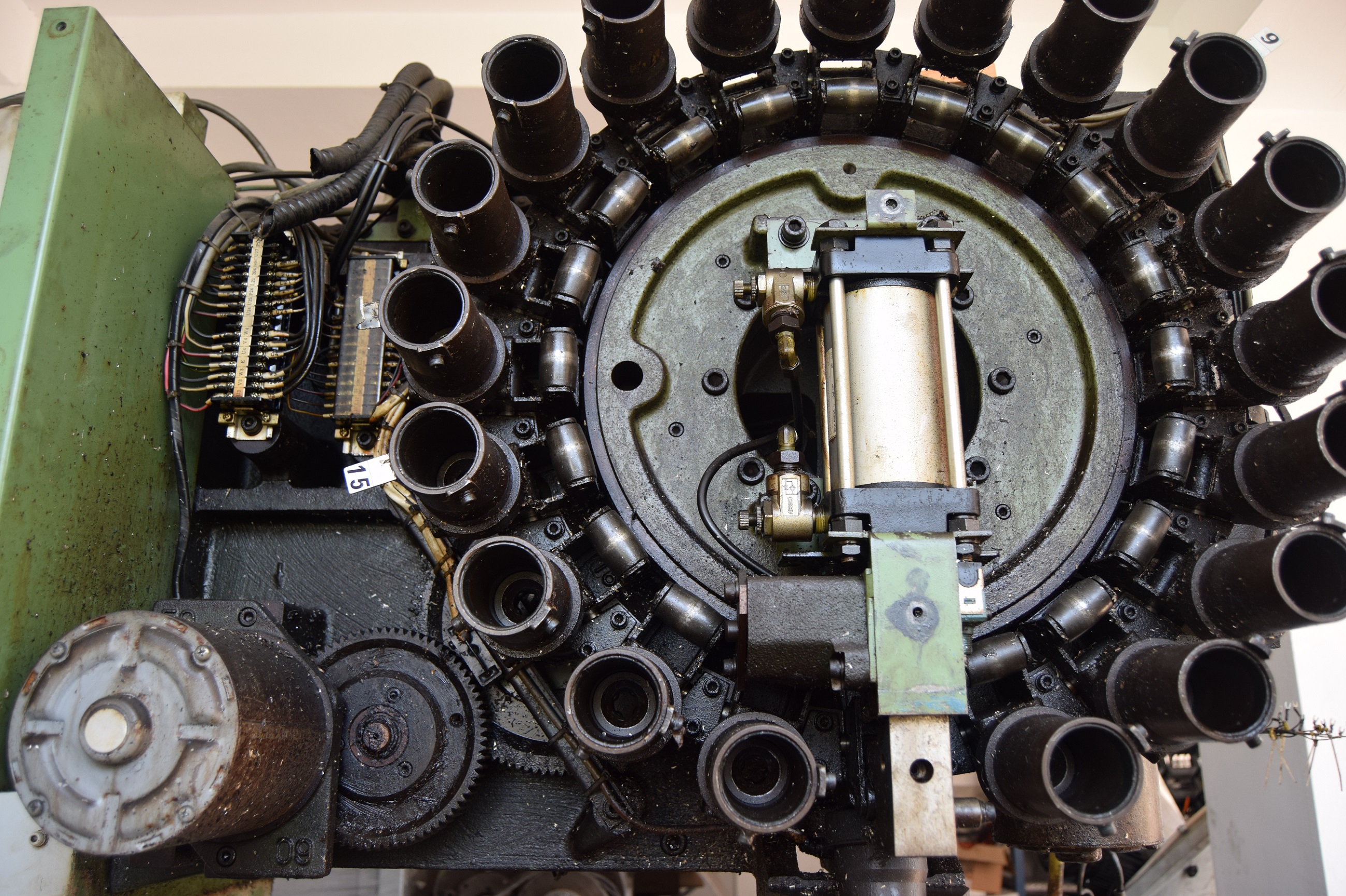

What is the best way to ATC with linuxcnc and mesa cards. The carousel has random tools. There are many topics but what is the best-easy way to this years .
- Posts: 19904
10 Jun 2023 13:29 #273281
Replied by andypugh on topic Random tool changer and remap M6
LinuxCNC is clever enough internally to call up the correct pocket for a random toolchanger (it tracks which tool is in which pocket)
The rest of the answer depends on the tool changer. Do you need to move actual axes to change tools? What sort of sequencing is involved?

15 Jun 2023 14:47 #273642

- Posts: 19904
15 Jun 2023 15:56 #273645
I have a feeling that someone has done one of these before. Have you searched this forum?

15 Jun 2023 16:07 #273647
Replied by tommylight on topic Random tool changer and remap M6
Everything about Mori Seiki on this forum:
www.google.com/search?q=mori+seiki+site%...sclient=gws-wiz-serp

16 Jun 2023 01:21 #273685
by besriworld
Replied by besriworld on topic Random tool changer and remap M6
Thanks, there is a big thread about the same machine. But the topic is very old, more than 10 years, and I was thinking if there is a better (correct) way. I think it was made in Classic Ladder .
I will also use for GUI probe basic .
