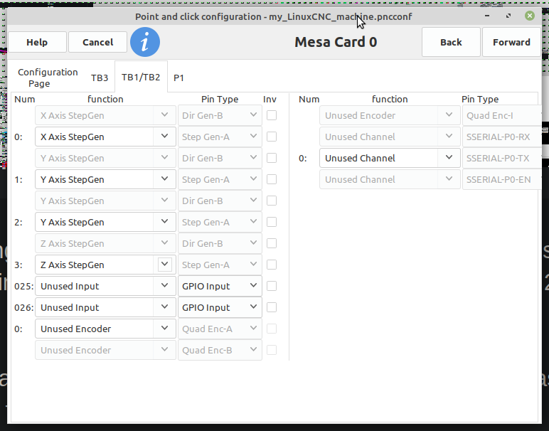

07 Jul 2021 18:43 #214001 by tommylight
Replied by tommylight on topic Tandem Y never runs two steppers
07 Jul 2021 19:19 #214002 by PCW
Replied by PCW on topic Tandem Y never runs two steppers
You can do that in pncconf but it does not setup 2 Y axis stepgens
07 Jul 2021 19:45 #214003 by hairyMug
Replied by hairyMug on topic Tandem Y never runs two steppers
I did try this previously and it did not work... Taking your suggestion, I set up a 3 axis config (with 4 steppers) and then created the following to " just select the same axis outputs for two drives." as you had suggested... I did get a display of X Y Z axis BUT NO Joy... It still only runs the one stepper...
So, I went back and created a whole new config (whith the 7i96 config tool) and put in -1 for the homing sequence and (of course), did not work ...
... it should not be this difficult to setup a simple 3 axis with two Y motors...
