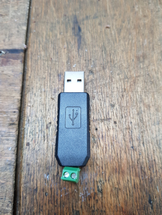

Replied by Aciera on topic hy vfd rs 485 gmoccapy
No brand or type label?

24 Jul 2021 03:41 #215752
by billykid
Replied by billykid on topic hy vfd rs 485 gmoccapy
This is ok .. but have you tried the parameters I said?
- Pauchuk
- Posts: 38
24 Jul 2021 03:48 #215753
by Pauchuk
Replied by Pauchuk on topic hy vfd rs 485 gmoccapy
More than once. Changed baudrate, parity as well. Allways the same - cant read data from vfd.This is ok .. but have you tried the parameters I said?

24 Jul 2021 04:20 #215754
by billykid
If it works with windows 10 it is a question of usb permissions, if you look in the forum you will find how to do it

24 Jul 2021 04:32 - 24 Jul 2021 04:41 #215755
by Pauchuk
I guess linux would say that? If I can run USB drive, write, read data, doesnt that say I have permission?
Same for running commands like loadusr -W hy_vfd - d /dev/ttyUSB0

24 Jul 2021 04:43 #215756
by billykid
real. I have seen that debian sometimes according to the language and country that it is configured strange problems come out. try to install it without modifying anything, i had a strange problem with qtplasmac i put english language and it works fine.
