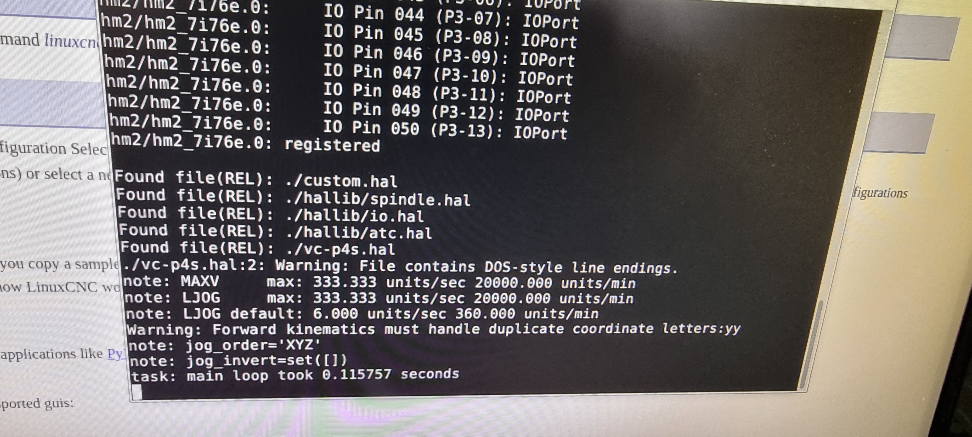

Just made an small video - photos.app.goo.gl/K4qpXrn5azqrAEGi6
The button just freezes.
When disabling pendant in ini file, then Z moves and starts to find limit switch.

If you look at the screen shot it shows the error warnings hal line 2 dos style endings
Replied by Clive S on topic VistaCNC P4-SE velocity mode stopped working after update to 2.8
There was no additional lines in terminal when homing joint 3.

Saved as new file in gedit with linux line ending. There is no more DOS style error, but it didnt resolve homing problem.

Error was in vc-postgui.hal file. Had to comment out axis3 and onwards.
Now i can home.
Now i can home.
