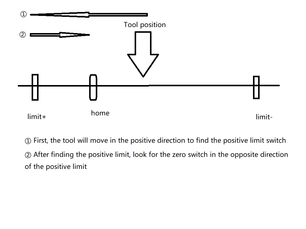

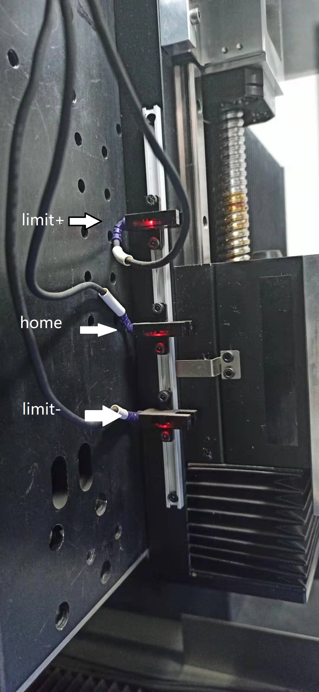

Thank you for your explanation. I also followed your explanation, but the machine will stop when the positive limit is found during the zero return process, and will not automatically search for the zero switch after the positive limit is found.
Because my zero switch and limit switch are not together, and my requirement is that the axis first finds the positive limit and then reverses to find the zero switch. This entire process should be automatic.
The following is my current configuration

My Z axis setting is like this

12 Sep 2021 06:05 #220287
Replied by tommylight on topic Laser machine tool zero configuration
Do not use the HOME switch at all, use the top switch as home+max_limit.
