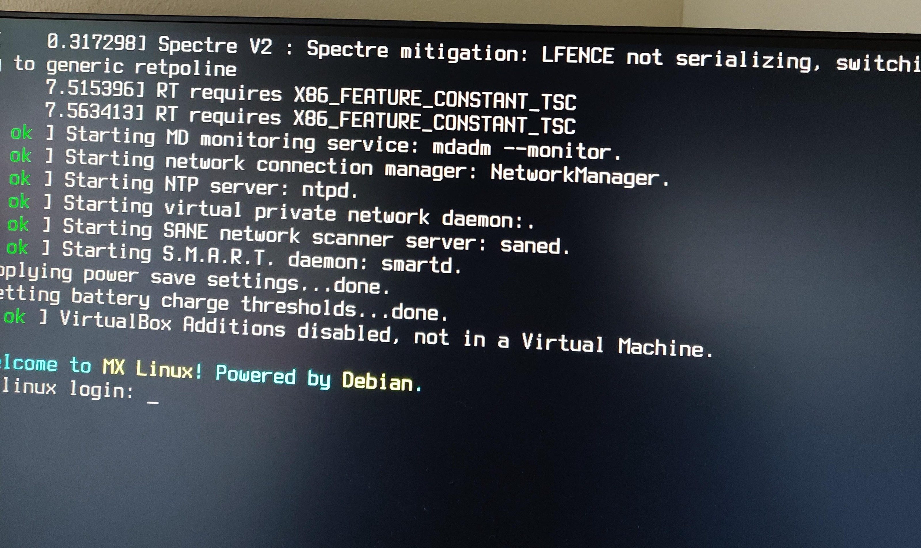

This has to do with microcode for the processor. Let me guess it is an AMD?

03 Nov 2021 18:41 #225132
by Clive S
Yes, You are correct it is a AMD Athlon 64 X2 3800+
Replied by Clive S on topic GUI not loading but going to login

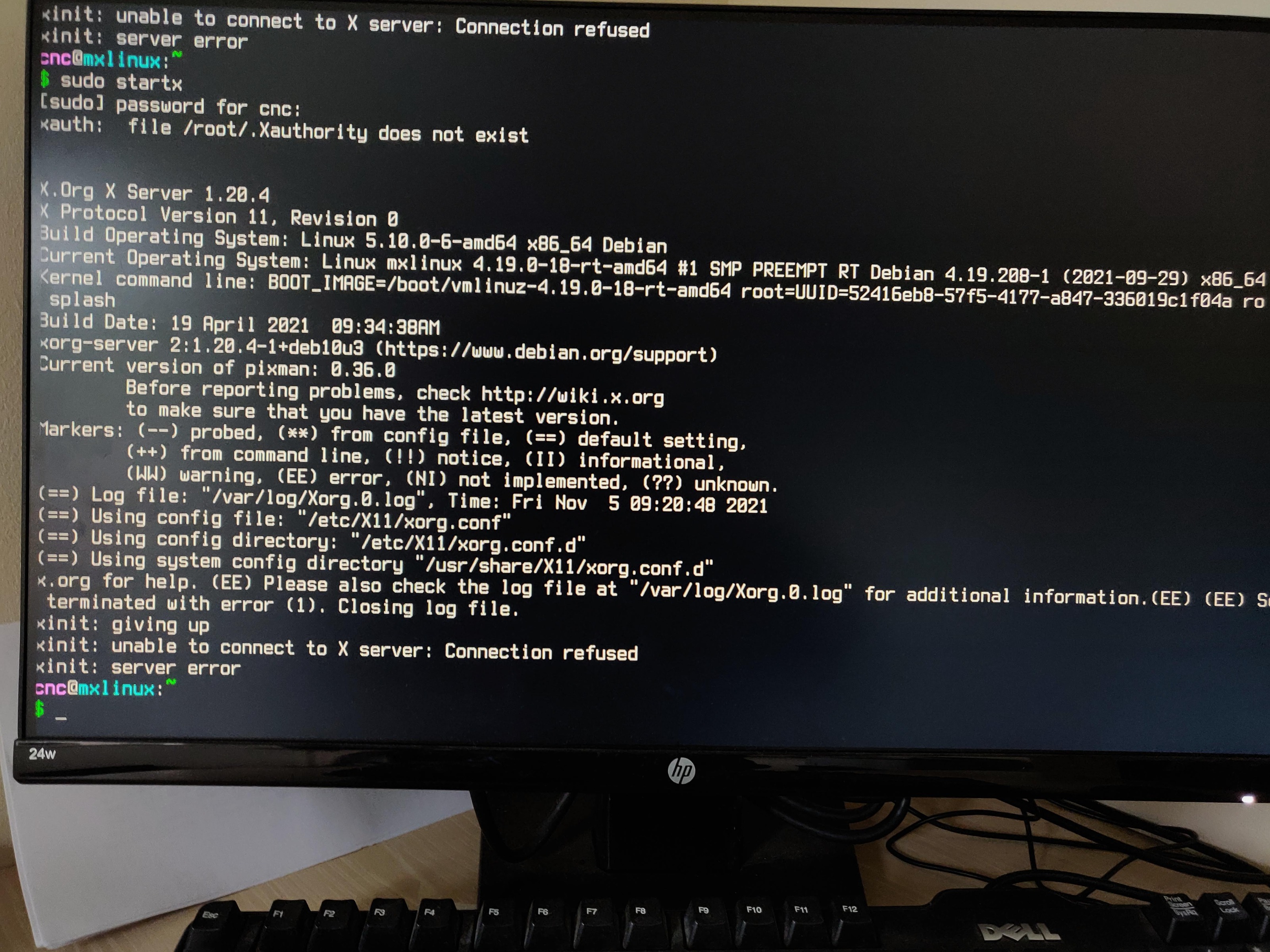

I have a PC that does not load the gui on start up, but instead goes to a login prompt.I have put the SSD in various PC's without any issues. I suspect that the clue is in the first line of the pic.
Bump
I am not sure if this PC can be used
Last edit: 04 Nov 2021 22:36 by Clive S.

04 Nov 2021 23:47 #225301
Replied by tommylight on topic GUI not loading but going to login
Log in then type
startx
see what comes up, i have a suspicion on graphic something or another.
startx

05 Nov 2021 09:45 #225379
by Clive S
I have tried it with startx and sudo startx

05 Nov 2021 09:57 - 05 Nov 2021 09:59 #225380
Hmm that usually means another instance of xorg is already running, so type
sudo top
and check if there is anything X related already running.
Edit:
BTW, even if you manage to make it work, i would not use that PC for machine control, it seems like a hardware issue so sooner or later it will mess up.

05 Nov 2021 11:48 #225387
by Clive S
Where will I find the logs as the X server is not starting
The only command starting with x is xprtoidHmm that usually means another instance of xorg is already running, so type
sudo top
Edit:

05 Nov 2021 13:33 #225395
sudo dmesg | grep xconf
sudo dmesg | grep video
sudo dmesg | grep vga
sudo dmesg | grep amd
sudo dmesg | grep radeon
sudo dmesg | grep nvidia
check each of them for clues.

- Clive S
- Posts: 2204
- Thank you received: 486
05 Nov 2021 15:00 #225401
by Clive S
Tom . Thanks for the feedback, I hear you. I do have plenty of PC's
It's just like I don't like being beaten.
This pc will load linuxcnc through a terminal using $ linuxcnc machine-name.ini
I will check out the above.
