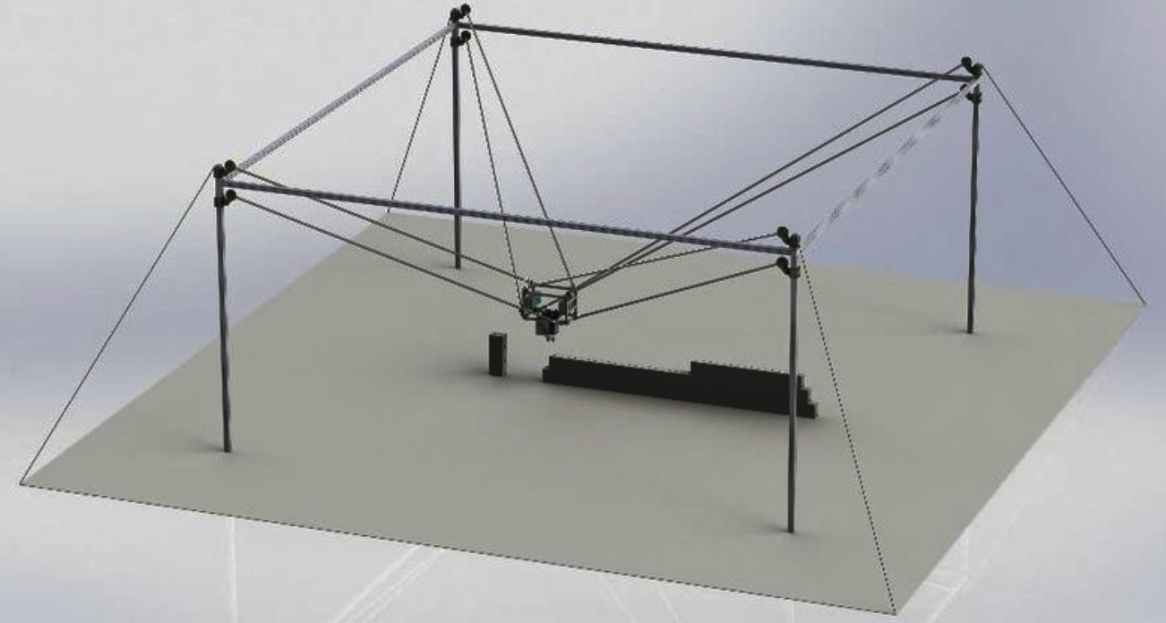

Can Linuxcnc run an 8 axis system. I am trying to control a suspended cable robot and it has 8 servos.
- Posts: 22029
- Thank you received: 7504
25 Dec 2021 12:34 #229979
Replied by tommylight on topic What is Maximum Number of Axis in Linuxcnc.
LinuxCNC can control 9 axis, each of those axis can have more than one joint/motor (8 i think), so that is the easy part.
Might have to figure out kinematics, but Delta might be a good start.
