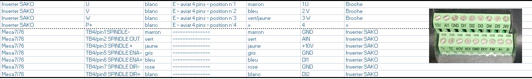

When I start linuxcnc I can start my spindle with button or with MDI M3 S20000. All seem to be OK. But when I start a code, spindle start and cut immediately at next line.
If I add G4 P10 just after M3 S20000, spindle rotate during 10s and then stop when line G0 X0 Y0 is read.
My configuration has been describe in this topic:

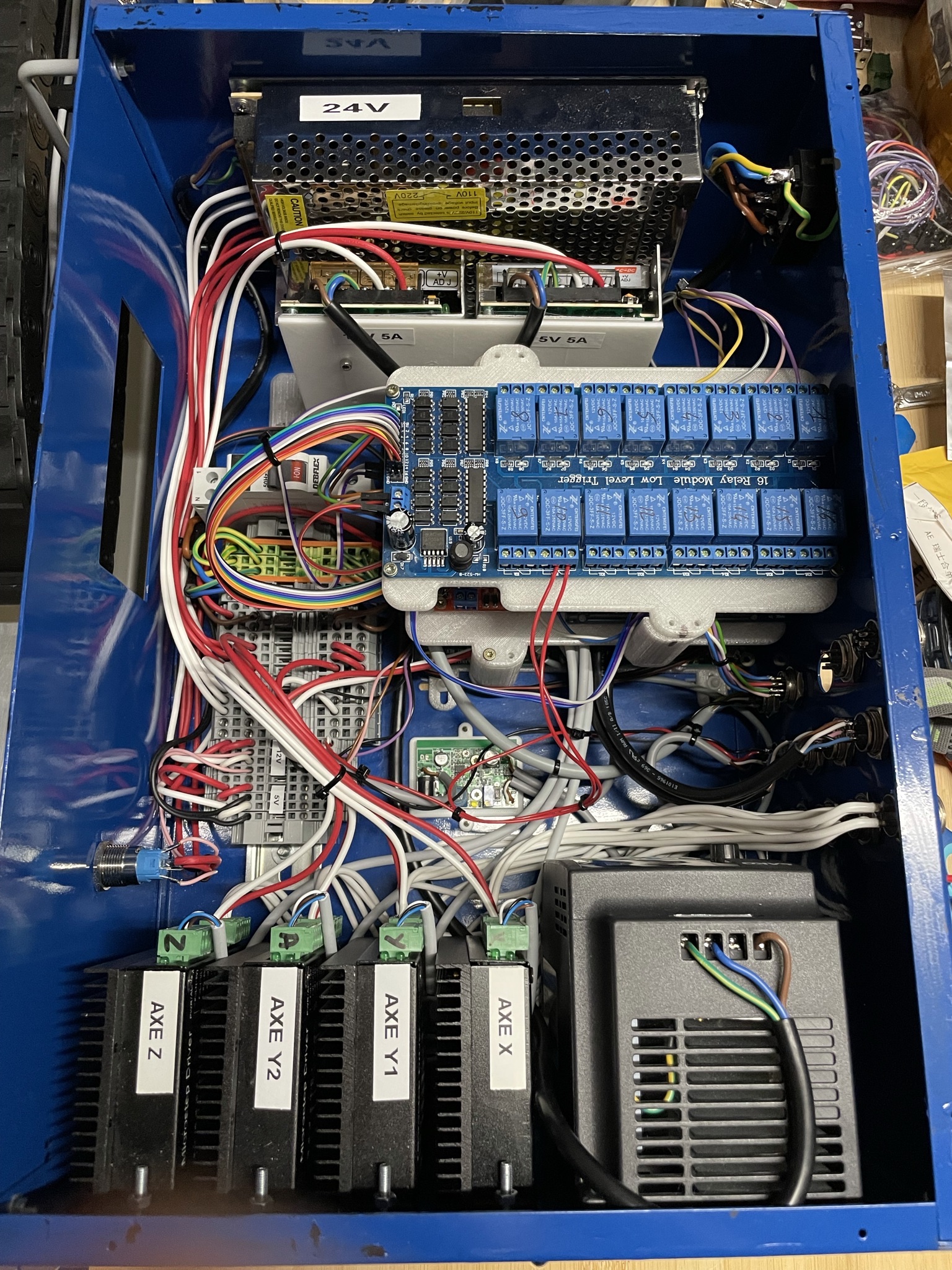

Replied by tommylight on topic Mesa 7i76 spindle issue
Ground the spindle and VFD.
That sounds like interference, so much of it that it disables the Mesa board.
Or, check the VFD COM pin, it has to be wired near the +10V and VA (or whatever the control pin is called), not to any other COM on the VFD.

I checked :
- halui.spindle.0.is-on: commute correctly from true and false when I press button
- spindle-enable: true false OK
- spindle-at-speed: true OK
Grounding spindle isn't impossible regarding instruction from supplier.
VFD is normally grounded via mesa card??
Interference sound good because mesa and VFD are in the same box. Probably something to improve.
