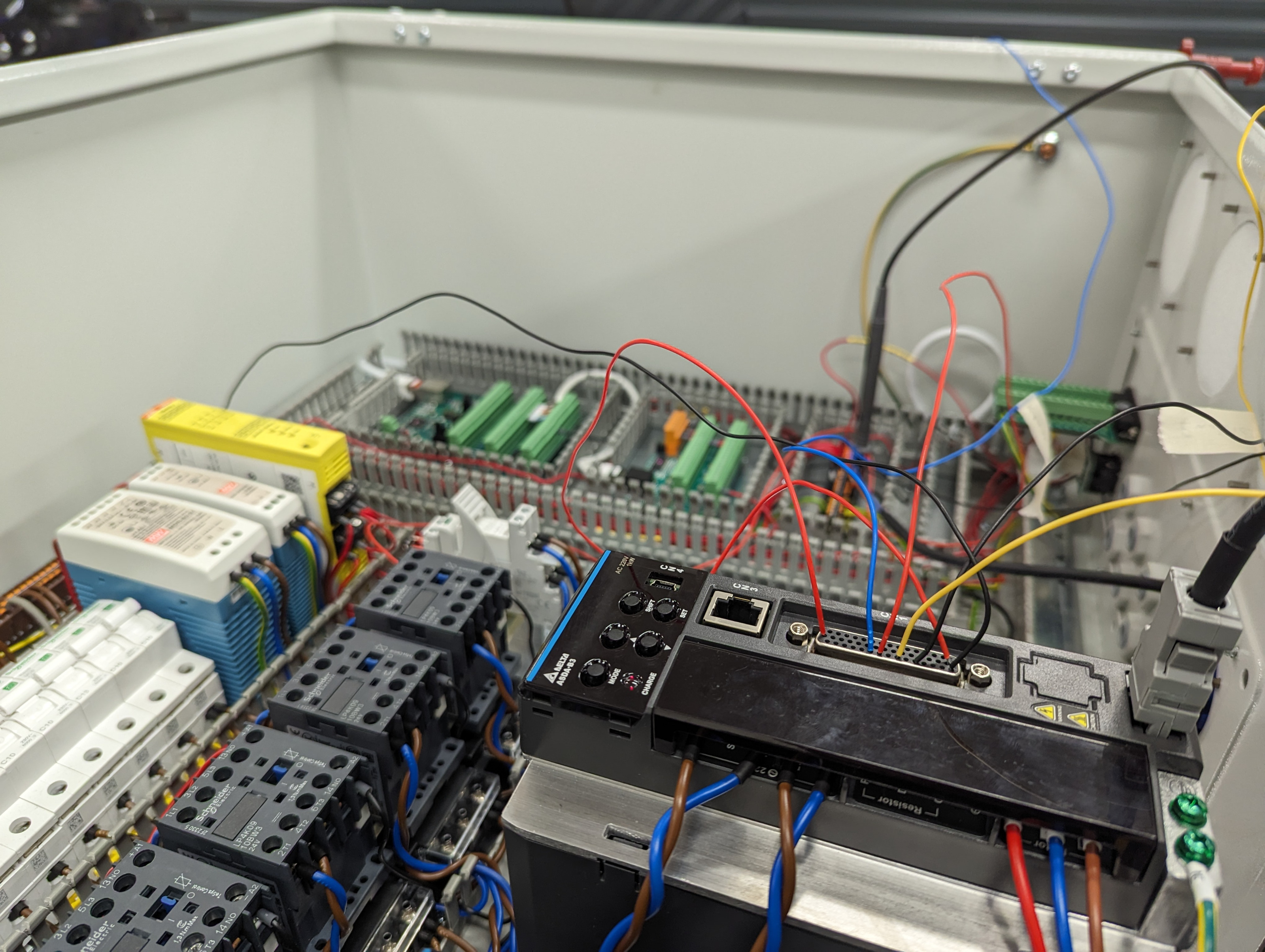

You could AND them all together and link to motion.enable.
The "logic" and "LUT5" components can be used as a more-than-two input AND. Or, depending on the output type of the drives you may be able to wire them together to create a single input.

Chaining them together is a great idea, why didn't I think of that. Big thanks Andy!
I did a quick test with some temporary wiring and the SRDY signal goes high as soon as the e-stop is lifted if there are no fault codes which should be exactly what's needed for the motion.enable input.
As the drives use DO+/DO- style outputs chaining the outputs should be very straight forward.
