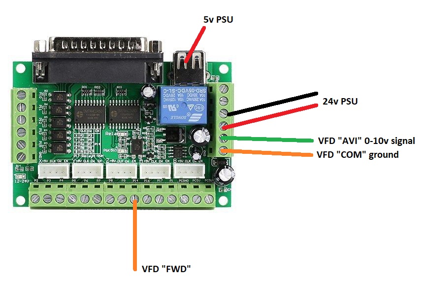

you have probably had endless amount of these posts, but my google-fu has failed me. Help a total beginner!
Main characters in my problem: Chinese 6040 router, 1.5kW watercooled spindle with a built in vfd. Originally with usb controller replaced with chinese "5 axis breakout with relay" forum.linuxcnc.org/media/kunena/attachme...25994/5axisboard.jpg
Now, I got all the axes and limits/homing working, but I'm getting no joy with spindle control.
From the spindle side, I have four wires: "0-10V", "GND", "Spindle CW" and "10V" as i understand the "10V" is just 10V supply wire, so not needed for me.
Connected "0-10V" and "GND" to BOB-s pwm pins, and "Spindle CW" to Pin16.
Went through Stepcontrol wizard, set pin16 to "Spindle CW" and pin 1 to "Spindle PWM"
When I press the "make clocwise noise" button, I can see the frequency on the VFD changing, but no movement. Also the speed seems to be calibrated to 6000rpm, and I have no idea how to change that, even if it would work
Please help an idiot!

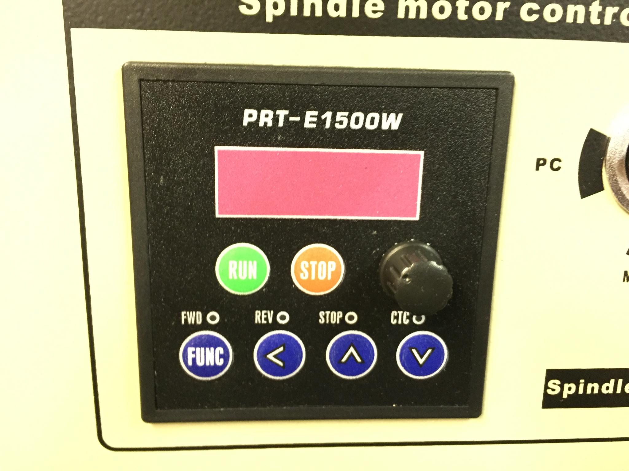

I just double checked. As far as my knowledge goes, I'm in "pc mode" what they call.
The "local" pot and start/stop buttons are disabled.
When I switch it over to the other (presumably "local") mode, then I can control the frequency manually and no freq change when commanded by the pc.

Just tried wiring the "FWD" pin with 10V feed through the relay "parport 17". Relay clicks, frequency on vfd display changes, but no spin. Tried inverting the pins in stepconf also, still nothing.
Edit: when I set the vfd to "manual control mode" then no frequency change from PC, but manual pot starts to work. So everything indicates the vfd is in "remote control mode"

Can you draw a simple sketch of how you are physically connecting the wires to the bob?
Also can you post the config files ie. ini and hal files from the config folder?
Do you have a link to the manual for the vfd? so that the parameters can be checked.

Hi Clive,
Little "schematic" and ini and hal files. Ini and hal are straight as they came from stepconfig. Have tried inverting the parport pins (1 and 14) through stepconfig.

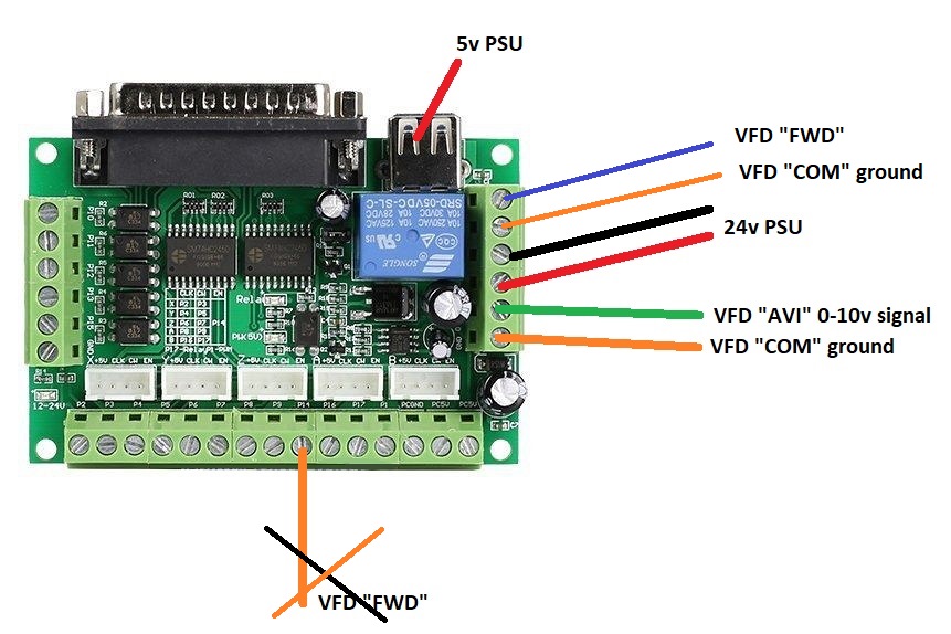

09 Apr 2022 09:29 #239736
by Clive S

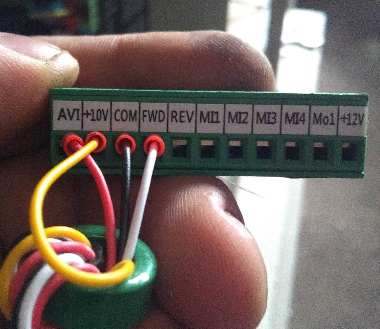

You have not said what VFD you are using. A pic of the terminal would help.
The VFD "FWD" (from the VFD) has to go to the relay (next to the 24V ps black wire) the other relay contact goes to the "DCM" in the VFD .
No spindle vfd wires connect to the bottom row of contacts on the BOB
Does the relay click when you command M3 S1000 (Or manually)
You might have to change this line in the hal file
net spindle-cw => parport.0.pin-14-out ..to
net spindle-cw => parport.0.pin-17-out

- mart154
- Posts: 6
09 Apr 2022 10:34 #239745
by mart154
Replied by mart154 on topic Help with vfd 0-10v wiring/conf

Does that mean that it is working now.
If so that's great .
Edit: Forgot to mention that is is generally better to use a 5V PS connected to the terminals on the bottom row.
Ie .forget the usb
Ie .forget the usb

Yes, got it to work nicely. Thank you. Usb is actually ditched already. I just didn't mention it to avoid more confusion.
