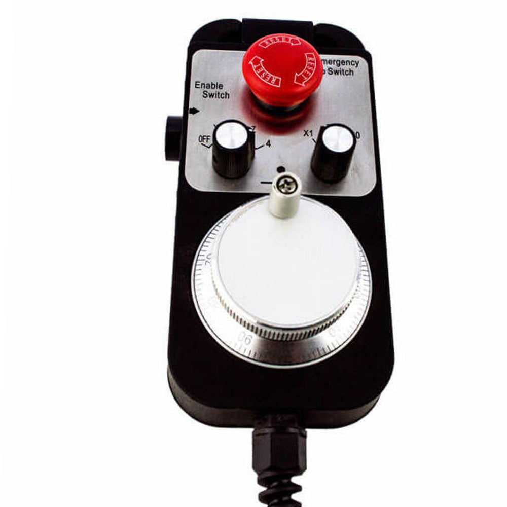

Hello Community,
i ve the same problem with disconnects and freezes of the WHB04-6 and i think its not a matter of the Linuxcnc Version, its a matter of the source code of the WHB04.
I use Linuxcnc 2.8.4 and gmoccapy with a XHC-WHB04-6 and its working in manual mode very well, but if i move the Jogwhheel in the Mode MDI or in Auto will switch the WHB04 to manual mode.
The problem start if i use the mode Auto and a program is running and i move in this time the Jogwheel ... then i get a fault message " its impossible to switch from Auto to manual mode in a running program" after will freeze the WHB04 in.
I search in the HAL for a solution, but the switch function is programed ( so i suppose ) in the source code.
I think the fault chain start earlier, with the functions "mpg" , "con" and "stp"
With the function "mpg" (directly after start of gmoccapy) is working the Jogwheel at the feeding rate ..... after press on the Button "con" or "stp" is impossible to switch back to "mpg".
Have anybody a solution for this kind of problem?

i have the same MPG and on linuxcnc 2.9.3 and I am experiencing same disconnects.
I support Mecanix opininon - the MPG should be hard wired.

Hello zmrdko,
have you an example for me, how is to do?
Thank you so much in advance

you need to buy something like this.
then you take it apart and find out how its wired.
Usually the side button enables the MPG encoder - for safety.
and then you have to connect all wires to your mesa card or whatever interface are you using.
and make hal file for it:
linuxcnc.org/docs/html/examples/mpg.html
