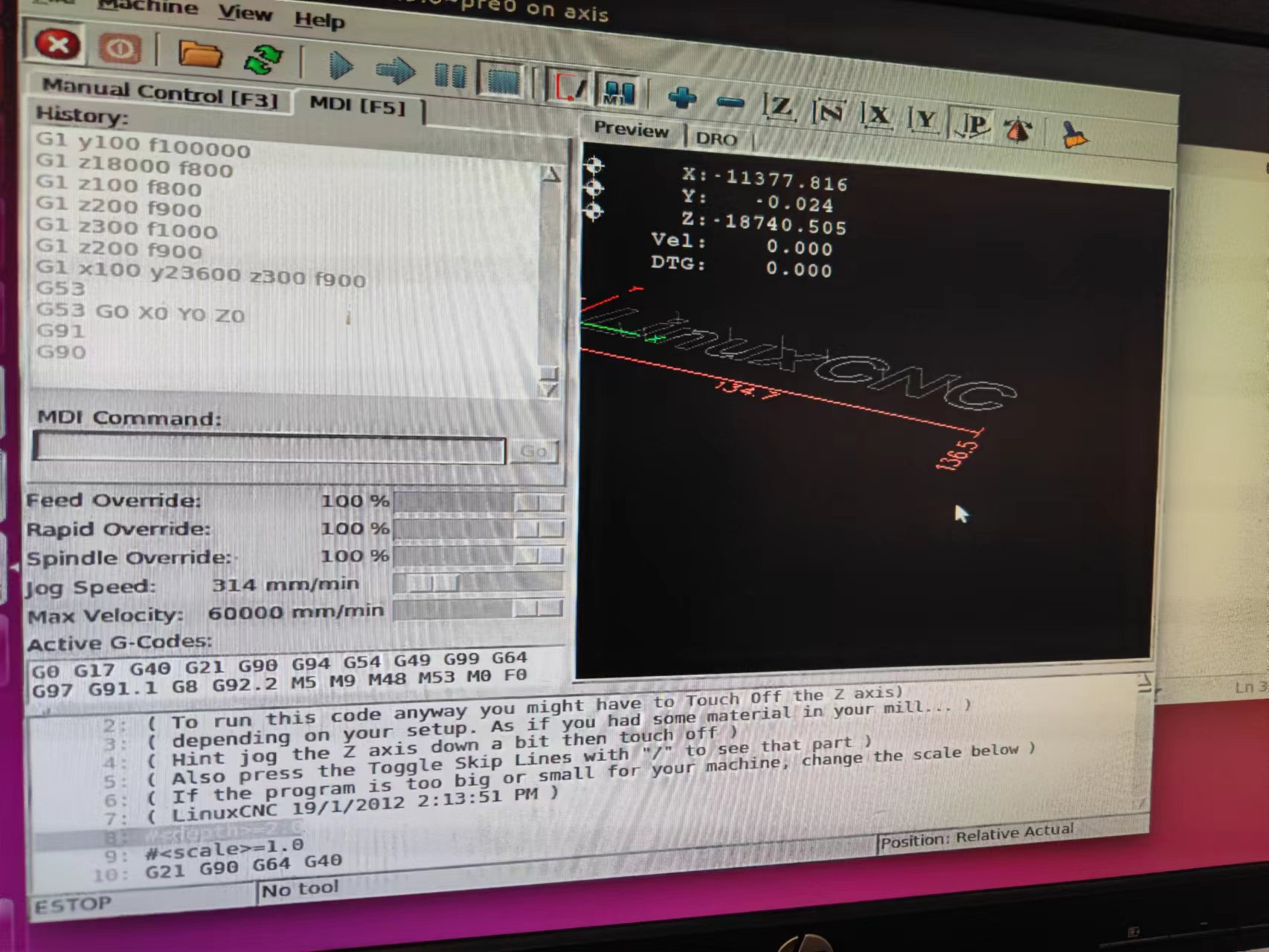

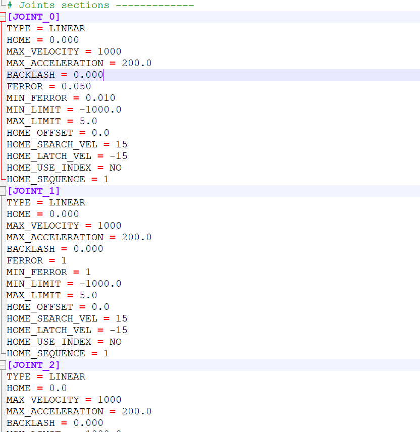

I have configured the servo driver myself, but after I return to zero, my coordinates do not display zero, but there is a flag to return to zero in the track interface. How do I configure the INI file to make my axis display zero after I return to zero? Please help me if you guide the problem, thank you

G54 X0 Y0 Z0

It seems that you homed in the G54 coordinate system and then switched to G53. Could that be the case?
Does it show zero when you switch back to G54 like Tommy mentioned?
The HOME_OFFSET value in your INI-file could also affect that, but I don't think so in this case.

I tried the g54 and it didn't seem to changeIt seems that you homed in the G54 coordinate system and then switched to G53. Could that be the case?

On the right of the "home all" button is the "touch off" button, use that after homing the machine to set the G54 0 for all axis, make sure it is in G54 or P0:
-home all
-touch off x, write 0 if it is not already there
-touch off y, write 0 if it is not already there
-touch off z, write 0 if it is not already there
-home all

Thank you for your help. It's really touch_ Off, I have solved your problem. Thank you again
