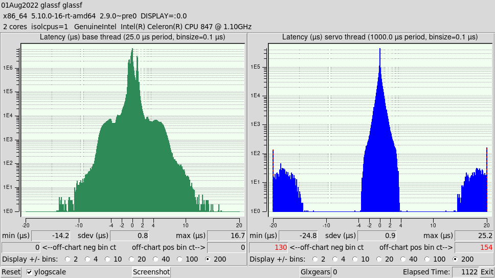

I'm setting up linuxCNC and the latency test is reporting around 6 mS which according to the manual is too high for it to work.
Can someone explain why that is the case. The computer is connected by the parallel port to a Xylotex controller that's controlling the CNC. Wouldn't the computer just download the gcode file and the controller take care of handling the timing sensitive stuff?

That isn't how Linuxcnc works. It isn't sending g-code or bits of g-code files to the machine. It is calculating and generating the individual step pulses (and the space between them) that move the machine. Those can be spaced as little as1 or 2 microseconds apart. And to be able to accurately produce those kinds of timings and have reasonable resolution for timings near by (ie slightly slower) Linuxcnc needs reliable realtime timing a fraction of the smallest step timing that will be used. All this in the name of reliable stepping (no missed steps) and smooth motion.
As far as I know the Xylotex control is only a box that contains a few step motor drivers, it isn't a true motion controler.

If you are using the official ISO, try installing the RTAI kernel as described here:
linuxcnc.org/docs/2.8/html/getting-start...#cha:Installing-RTAI
It is much better for use with parallel port, especially on older computers.

Yes, Preempt-RT seems to require a little more horsepower from the CPU to get good latency than RTAI. An RTAI instal often is better for older and/or slower CPUs. I think the reason may be in the basic architecture of the real-time portions. RTAI is more of a separate layer underneath the kernel, where Preempt-RT is more of a patch on top/in the kernel. Because of that, RTAI's real-time performance is less dependent on the computer's speed. As such the minimum system specs for an RTAI Linuxcnc installation are pretty much the same as the base specs for adequate usability of the operating system.

When I install RTAI LinuxCNC won't run. Any idea how to fix it?

Try rebooting since some modules are hanging.
If preempt_rt was getting you 6mS (6,000,000nS) latency jitter you probably don't have all the speed stepping, power management etc etc turned OFF in BIOS yet. Did you really mean 6mS (sad face) or 6uS (6,000nS) which is great!
Try running the RTAI latency test $ sudo /usr/realtime*/testsuite/run
- Posts: 21900
- Thank you received: 7465
26 Aug 2022 00:14 #250480
Replied by tommylight on topic Why the tight jitter requirement?
Pretty sure the RTAI kernel requires a version of LinuxCNC compiled for it, not sure though, it's been a while.
- Bari
- Posts: 639
- Thank you received: 234
26 Aug 2022 00:29 #250482
by Bari
Replied by Bari on topic Why the tight jitter requirement?
True, but I assumed he followed all the steps here linuxcnc.org/docs/2.8/html/getting-start...#cha:Installing-RTAI
- martin_mortensen
- Posts: 3
28 Aug 2022 23:53 #250666
by martin_mortensen
Replied by martin_mortensen on topic Why the tight jitter requirement?
yes followed those instructions. Didn't see any errors. tried rebooting and even re-installing but same result.
