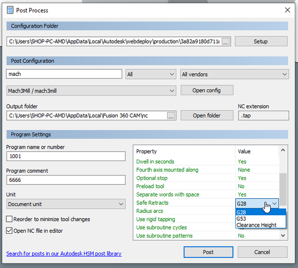

It does not need to work with both G28 and G53. If you found a working solution with G28 (and G28.1) then you should be good to go. You only have to instruct Fusion 360 post processor to use G28 and not G53.
This should be available on the 'post process' setup screen in fusion 360. Find the lines that says 'Safe retract' and select G28 from the drop down box. Fusion 360 will then generate g-code with G28 instead of G53.

I have found some happiness with the post process. I'm still using grbl, but did find that I have a choice over G28, G53, or the real gem... "Clearance Height". lol. Amazing!
Next. My G53 was working fine. After reading the docs just about everywhere i could find mention of G53 I was 100% sure that the home position would be the position i tell the machine to move to after homing. Which in my case is very close to the switches. But a G53 G0 X0 Y0 Z0 would move the spindle very far away from these points. It wasn't until I was typing up a question for you all a few days ago that I realized it's doing exactly what it's supposed to do. It is moving to x0 y0 and z0. So in the set up I have on x for example -250mm to 250mm and my switch is at 252mm. So to change my x0 physical position I would change my setup to maybe... -400 to 100.
