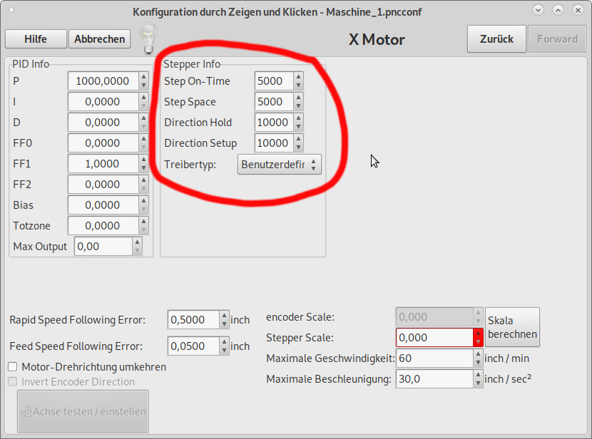

Hello everyone,
i have these combintation and just want to test the electronics, motors ets.. And... I am a noob, seems like.
I get everything to work, another much smaller nema 17 motor i have testet runs fine. Mostly with the defaults.
But these bigger ones still won´t run.
My chinese dealer said driver and motor comes preconfigured. I tested all wirings, proof it and so on.
Yesterday i got a tip out of a video to look at those values i circled red in my jpeg, also to have a look at the max. accelleration.
But i found no further information related to my combination. So i play around reduce the max. accelleration and change the values.
First by new setup, later in the machine ini file.
So the motor make a little "move" at start and sometimes when i drive the axis on the UI. (But not realy turn around!)
Then sometimes i get a red blinking LED, obviosly that means positionfailure.
But when i change that values i don´t see that failure anymore.
So seems to be a little progress, but the motor won´t spin. I testet 2 motors and two drivers out of my 4. Same result.
It will be nice if anyone have an idea, that steal me two weeks the afternoons.

I am more and more sure that those values in my jpeg are the mess.
I seen yesterday a video from Talla83, playing around with that values, sometimes he get the same failures. Pull failuers, and a no spinning motor.

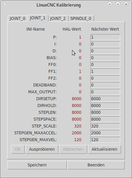

Get it.Its a thing with the values i circled red in the jpeg i send with my initial message. Also i have a look at the "STEPGEN_MAXACCEL:" and STEPGEN_MAXVEL: at the right bottom corner at the same menupage. Or later in the calibration tool. Motors run fine with wiring PUL /DIR AND PUL- DIR-, nothing else except the motor encoder.That what i want, rest is optimisation .Hope nobody need but maybe this will help anyone.Great thanks!
I also correct values in the .ini which are have the same meaning as STEPGEN_MAXACCEL & STEPGEN_MAXVEL at other points.

P should be 1000 for all joints/axis if the servo period is at 1000000.
