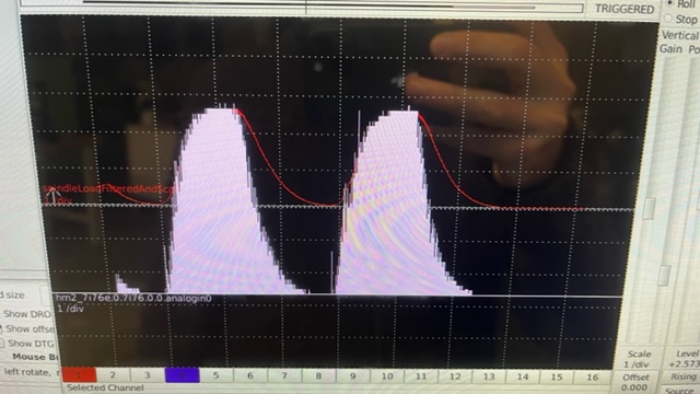

Hi together,
I try since a while to read the current of my spindle in LinuxCNC to have a load display.
As input I have a 0-10V from my VFD, which I can read perfectly stable with a multimeter.
I added a 100nF capacitor between the Analog Out and GND on the VFD side to smooth it a bit.
The period on the HITACHI SJ100 VFD PWM is 4ms.
However if I try to read this in LinuxCNC via a Mesa 7i67e it looks like a very slow PWM signal.
I tried to smooth it with a Lowpass Filter but I need to go as low as 0.00001 in gain to have a stable value.
This becomes very slow in reaction then and it also seems to drift over time. Slow= takes >20s after the spindle stopped to reach 0.
Something like 0,5s would be acceptable
Is there a bit faster and more stable way to filter the Analog Input?
Thank you for your responses
Fritz

23 Nov 2022 10:13 #257487
by Ritterchen
Replied by Ritterchen on topic Read Spindle Load with Lowpass is too slow
Connected the Spindle- to Fieldbus GND, but it seems to have the same behaviour as previously.
The input seems to be very inconsistent (Analog Input and Filtered Input)
setp lowpassFilterSpindleLoad.gain 0.00001
setp scaleSpindleLoad.gain 2
setp scaleSpindleLoad.offset 0
net spindleLoad lowpassFilterSpindleLoad.in <= hm2_7i76e.0.7i76.0.0.analogin0
net spindleLoadFiltered scaleSpindleLoad.in <= lowpassFilterSpindleLoad.out
net spindleLoadFilteredAndScaled <= scaleSpindleLoad.outPlease Log in or Create an account to join the conversation.

What is the time per division on the plot?
- Ritterchen
- Posts: 34
- Thank you received: 18

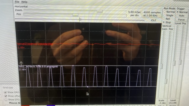

23 Nov 2022 10:32 #257490
by Ritterchen
That was a 500ms division.
Even stranger on a closeup of 5ms you can see perfectly fine the 2ms intervalls of the PWM and a little bit of noise (what would be easy to filter).
A little bit lost here - because then basically I should be even able to read some fluctuation with the multimeter?

23 Nov 2022 10:39 - 23 Nov 2022 10:44 #257491
Replied by PCW on topic Read Spindle Load with Lowpass is too slow
My guess is that you are seeing a beat between the PWM rate
and the 1 KHz sample rate. I would try using analog RC pre-filter

09 Jul 2023 07:00 #275072
by Ritterchen
A little while later... ;D
Worked like a charm - using a 1k Ohm resistor with a 10uF capacitor following this tutorial:
