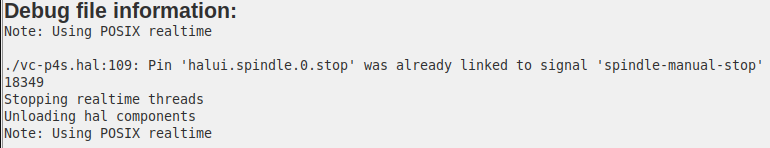

Hi VistaCNC-Pendant Users, dear community!
First off all, thank you very much dear community for sharing all your thoughts and experience here and let us newbees take part in this fantastic and fascinating adventure. Without your help and documentation, I'm sure many of us would be lost and would just give up setting up a LinuxCNC-Machine. I'm new to this and this is my first post.
Problem:
After installing the VistaCNC P4-SE Pendant according to the manufacturers installation procedure (downloadable PDF attached), I encountered several errors while starting the freshly edited machine configuration which started flawlessly before like follows:
In plain text:
./vc-p4s.hal:22: Pin 'halui.axis.x.plus' was already linked to signal 'jog-x-pos'
22173
Basically it complains about pins which are referenced twice.
What I found out:
If I commented out (by using #-sign) all the lines (it complained about) in the vc-p4s.hal-file, the pendant didn't work properly! (many features missing and weird behaviour)
If I commented out (by using #-sign) the corresponding lines in the MyMachine.hal-file, the pendant did work flawlessly!
Question:
Did I solve it the wrong way? Is there an even better way?
It seems I am the only one, having that problem! Am I? Anybody having the same problem? Different solution?
What is your solution to that problem? What are the PRO's saying?
Cheers and many thanks in advance!
tincho80.

Yes, you were on the right track with your first post. I was encouraging you to read the other thread as it might help you understand why you were on the right track.
All the halui signals in the vc4-ps.hal need to be commented out ("#") in your main hal file if there's a conflict.
So if you have something like
net jog-x-plus halui.axis.x.plus in the main file AND the vc4-ps file, comment out the main file.
