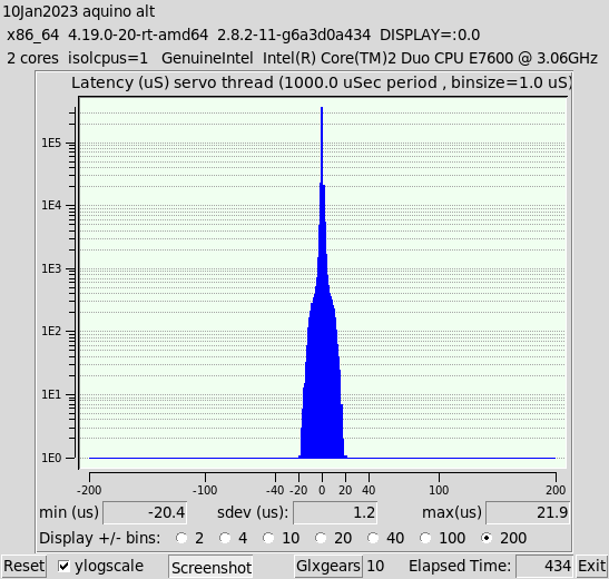

11 Jan 2023 03:14 #261532
by clunc
Need a protocol to tweak/tune acceleration and velocity for peak performance. was created by clunc
Over there
, I started a thread to get help with my system dropping steps.
[Update: Second things first. for Christmas I fetched one of those mentioned gallons of grape juice, which should've been wine, but it was vinegar as were the other six. Doing my research after the fact I learned I should've had air locks on the jars. I don't have any extra money just lying around for 'wine equipment' so I had put paper towels over the jars and under the lids. We are now well-stocked on vinegar, easily enough to soak my head and those of a few others who need it.]
First things second. I'm back because I cut out a recent project (wood carving) recently (with my stable Mesa-6i25-based machine) which would have taken, I'm guessing, about three hours on the old software-stepping setup I had using the computer's parport, but took 3X that on the new setup. (I add here that a forum search for "optimize acceleration" turned up next-to-nil.)
The problem with extended cutout times is that I live out in forest country where electrical power is interrupted regularly. The longer the time, the higher the risk.
Although F120 ipm is called for in the G-code, in practice the feedrate seems to hover between say 30-and-60. The model is elevation/terrain data being cut in a series of left-to-right-to-left moves (that is a sequence of G1 moves between XZ-pairs for a fixed Y, after which Y is incremented and a new sequence commanded). Steps in Y are typ. 1/4-to-1/5 mm and steps between XZ pairs typ. around 0.01 inch. I suspect this is not like "ordinary" machining.
I will say that performance under my original software-stepping setup cracked along at, if memory serves, perhaps 80-90 ipm for commanded 120 ipm, and in any event always managed to hit the commanded velocity of 120 on smooth "straightaways."
My current setup can't do that, and I know it's a more capable system.
I used PncConf to Test Axis again to increase stepper velocities/accelerations until I got scared when the motors stalled and backed off some. (They ended up in the 240ipm/165ips2 range.) However when I ran the G-code (with the CNC machine off), the backplot still showed those low velocities.)
Returning to this thread to see what the heck I must have done, I guess I selected for stability/reliability/predictability over performance.
But I'm not exactly sure. It could be that my particular G-codes are doomed to slow execution by the nature of the surfaces being cut, but I would like to know I'm getting the best performance possible.
% uname -a
Linux clunc 4.19.0-20-rt-amd64 #1 SMP PREEMPT RT Debian 4.19.235-1 (2022-03-17) x86_64 GNU/Linux
The values in my .ini file (clunc.ini, attached) seem reasonable.
% latency-histogram --nobase --sbinsize 1000
The histogram is attached as well, and strikes me as very good.
I am looking for a tuning protocol that will give me confidence that I have optimal performance.
I thank you, again, for giving your time to help.

11 Jan 2023 17:51 #261597
by clunc
Replied by clunc on topic Need a protocol to tweak/tune acceleration and velocity for peak performance.
I've got it back to what I consider "historical" performance: 80-90ipm, actual, for 120ipm, commanded, and 120ipm on straightaways. I did allofthese:
* downgraded G64 P0.001 to G64 P0.005 Q0.005[1]
* HALVED (radically) DIRSETUP and DIRHOLD for each stepper in the .ini file from 10000 to 5000[2]
* HALVED (radicatlly) STEPLEN and STEPSPACE for each stepper in the .ini file from 5000 to 2500[2]
* more than QUADRUPLED (radically) MAX_ACCELERATION for each stepper in the .ini file from 20 to 90[3]
I am off to give 'dmap2gcode' a whirl. Before any of these, I had downgraded the resolution of the model to be cut, so as not to put any strain on the kinematics. That resulted in a model with an obviously inferior look. I will go back and re-generate a model with higher resolution.
Thanks all.

12 Jan 2023 20:32 #261732
Replied by rodw on topic Need a protocol to tweak/tune acceleration and velocity for peak performance.
The reason why you are not hitting your commanded velocity is simply a function of physics.
In a simple linear move linuxcnc will accellerate at max_acceleration in the ini file until the commanded speed is reached. THen it travels at constant velocity and finally decellrates at max_acceleration to a stop.
This is what is called trapezoidal acceleration and you can see it if you use halscope.
But if the segment is too short to reach commanded speed, the profile is truncated to a triangle. Also the lookahead motion controller takes into account the physics of the next segment and may further truncate the velocities so the next segment can be honoured.
bUt in many cases generated short segments are not really necessary to produce a pleasing result. There are some settings in the ini file that can be used to smooth out motion if the generated gcode is poor.
