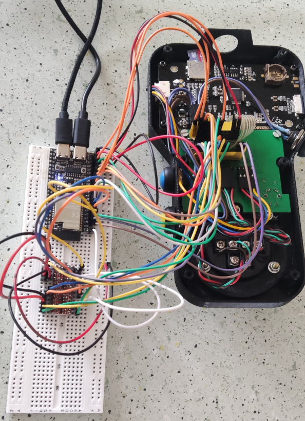

Hello
I wanted to add a pendant to my cnc.
I basicaly looked at xhc series but then decided that I would rather build something cool and flexible on my own . Of course, I will waste a lot of time, rather than taking some of the shelf.
I 'm using an NanoESP32-S2 and 3.5 Nextion display.
Currently for the USB communication, I emulate a xhc so I use xhc-hb04 standard HAL module on linuxcnc side.
Beside the over complicated USB protocol, I found some "limitations" : I can display 6 axis (in G5x coords) or 3 axis in G5x + Machine Coords.
So XYZA in G5x + Machine Coords is not possible.

- looping
- Posts: 91
- Thank you received: 10
19 Mar 2023 10:31 #267087
by looping
Replied by looping on topic Pendant interfacing
It is alive :
The PCB was designed for Arduino Pro Micro, so since I'm now using a Esp32S2 I have to use a bread board. I aslo added some level shifter to adapt 5V hall encoders to Esp32 3.3V I/O.
The PCB and the case will be redesign
