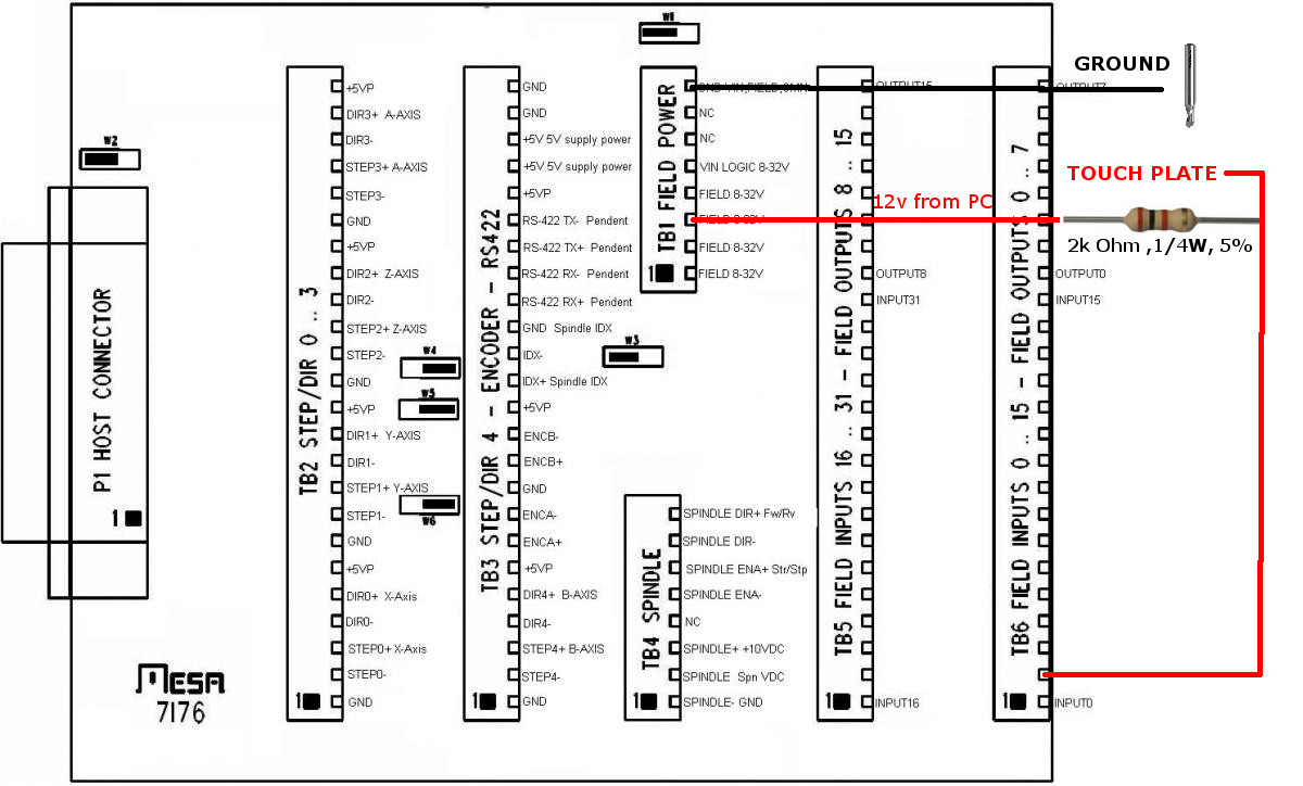

I am adding a probe to my z-axis and am wondering if I need to add a resistor to the input side? I am using the Mesa 7i76e ethernet card. I found the following page online that mentions a "2k pull up resistor". Have not read it anywhere else. So thought I would ask if others here have done this.
Run a wire from the +24vdc field power terminal, TB1 pin 4, through a 2k pull up resistor to the input pin, TB5 pin 10.Run two wires to the touch off plate. One will be hardwired to the DC Ground in the electronics box and have an alligator clip or magnet to attach the wire to the cutting tool or spindle. The other wire from the probe should run back to the input pin on the 7i76e, TB5 pin 10.The input can be inverted in the software by adding “-not” to the input number.

17 Mar 2023 18:05 #266927 by Sray69
Thanks for that link. I notice in the diagram that was post the touchplate positive wire is using pin 01 which is an analog input.
In this blog he uses pin 10 which is a digital input.
www.diycncdesign.com/linuxcnc-2.8-touch-plate-probe.html
Which is the correct input to use?

18 Mar 2023 05:25 #266969 by JPL
... I notice in the diagram that was post the touchplate positive wire is using pin 01 which is an analog input.
... In this blog he uses pin 10 which is a digital input. ... Which is the correct input to use?
The 7i76 support 3 software mode. In mode 1 & 2 you have 4 analog inputs but in mode 0 you don't have any. The diagram is probably for mode 0.
You can use any digital input. Just edit this line:
          net probe-in     <=  hm2_7i76e.0.7i76.0.0.input-25-not
to use the input you want to use.
