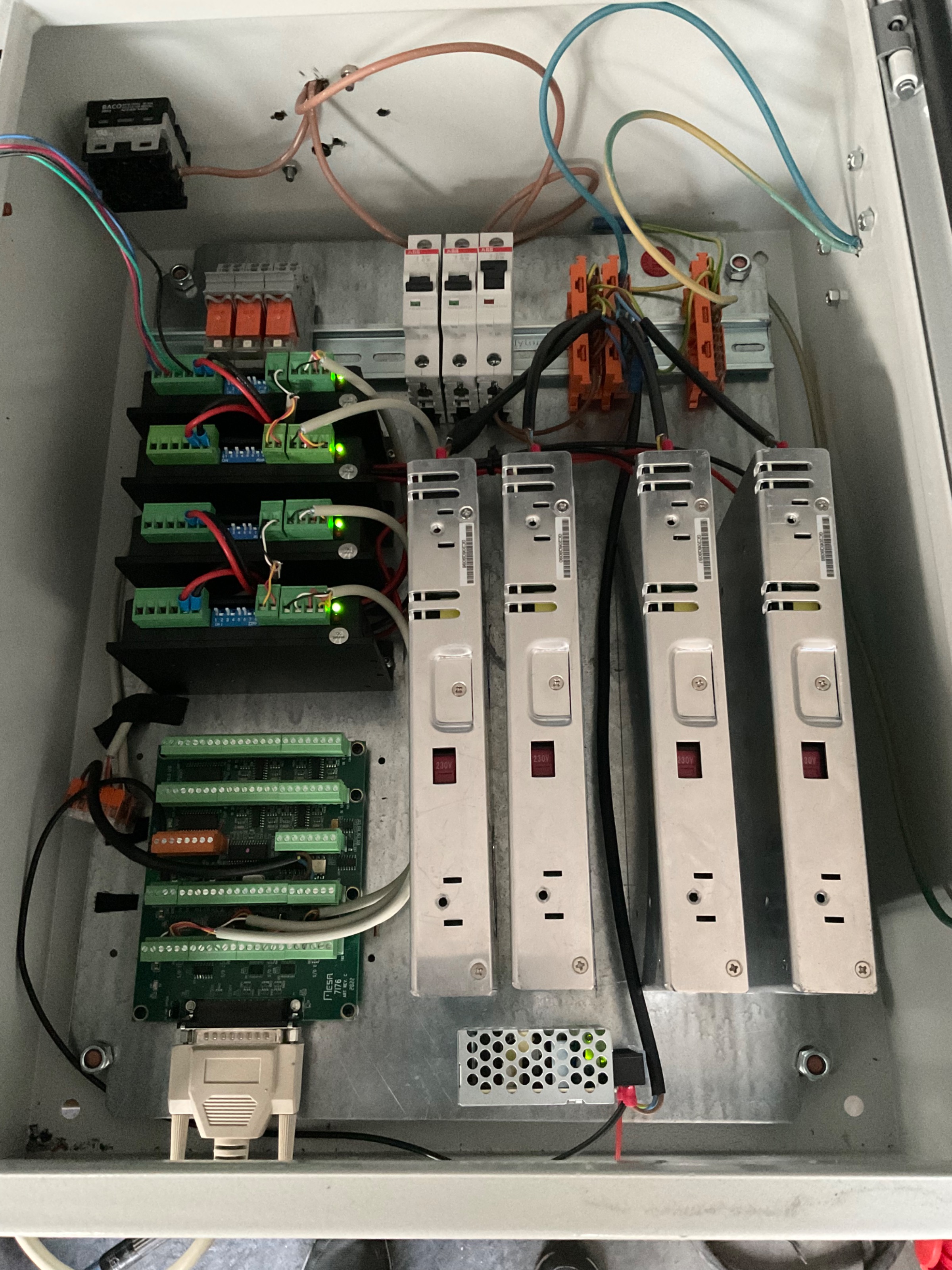

I am new to this whole CNC Theme and are currently building a my first Machine. I finished my Control Cabinet and did my pcconf.
Now, if I hit the enable button on my gui, i cant move the steppers anymore but if I want to move the motor, nothing happens. I checked my pins multiple times and Config and can‘t figure out where the problem is. Has anyone any Idea?

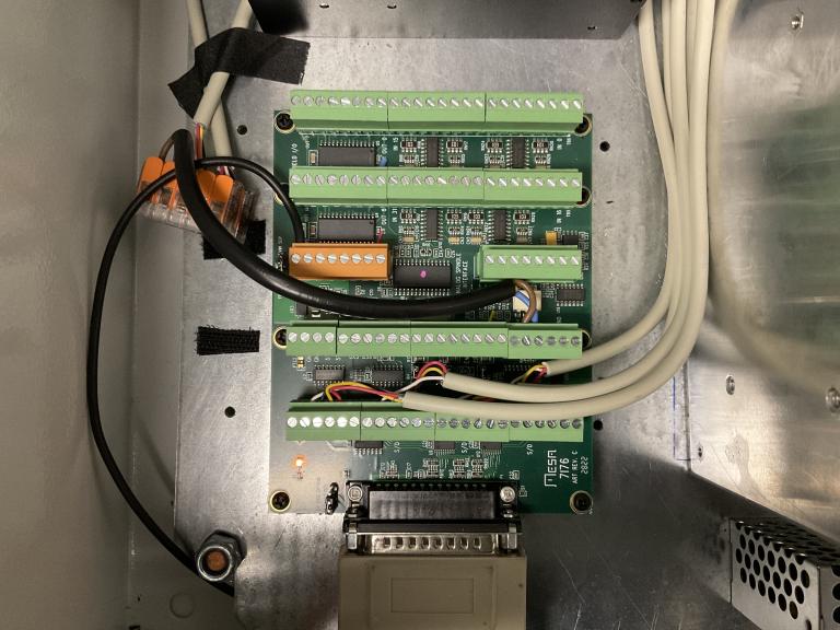

Also are the status leds of your mesa card lit as per the description of page 12 in the manual? :
www.mesanet.com/pdf/parallel/7i76man.pdf

Hi, thank you for your reply. In the attached files there is everything you ask for. Bcs I didn´t found the exact page with the led setup, i attached an image with the leds.

Are the step drive enables connected?
Note that these are most often DISABLE inputs so disable the drives when active

If I press enable in the programm, the right voltage is applied to enable and the motors is locked.

On the Mesa side, remove step- and wire it to GND.
Try one drive.
Just to be sure, do motors lock when LinuxCNC is running and enabled with F2 or Enable button on GUI?
Try one drive.

I wired Step- to GND, no change at all.
And yes, if i press F2/Press the Button, the motor is locked.
