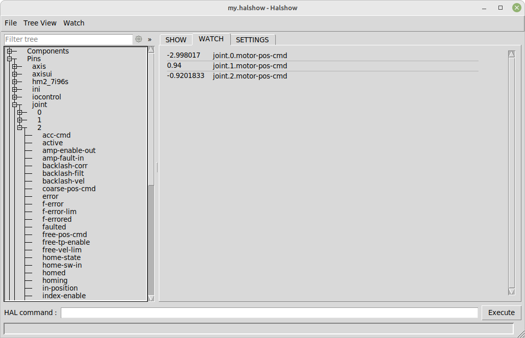

Will Y2 move if you attempt homing?
Does Joint.2.motor-pos-cmd position move?

It will not move at all, even with homing, I have also tried setting it at "home" while in joint mode and then tried moving the whole gantry in axis mode and it wont move that motor
Honestly not sure about your second question or how to test that, just run the command?

PCW: Ok so tested using halshow, The joint does move in halshow and shows varying numbers based off its position. In the GUI(Axis) it is also showing that joint moving as I jog the machine.
