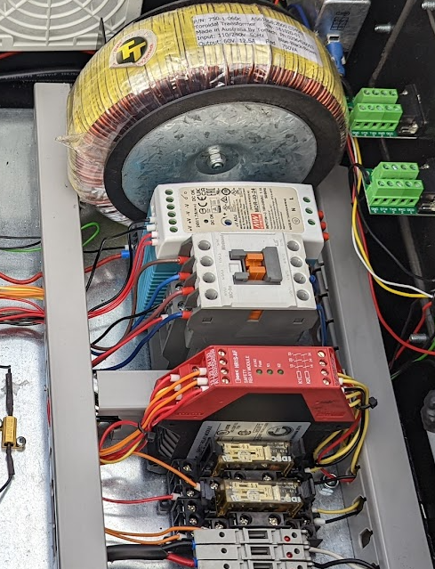

06 Aug 2023 07:29 #277094 by rodw
Note that some VFDs/motor drivers offer a dedicated safety input that will bring the motor to a controlled stop within a defined time rather than just having it run out when mains power is cut. This is the usual requirement in an industrial setting these days.
In terms of compliance with the relevant standards (which I am too lazy to look up), it not just enough to use a safety relay. I bought the red one shown here. Then I needed a couple of special force guided relays shown in front to trigger the contactor behind it. These have a non-conductive probe that is forced between the relay contacts to ensure they open if they are welded shut.
But this circuit simply drops power to the drives and spindle which is not desirable. What I should have done is to use a timer relay so the spindle and drives could be disabled gracefully before the circuits were turned off. But for compliance, I could not use an ordinary (non-standards compliant) timer relay so I should have used a safety relay with a timer built in to preserve the safety circuit. All of this adds a lot to cost so for home use where an employee is not using the machine, simple is good!
06 Aug 2023 07:33 #277095 by rodw
Ooops file was too big.

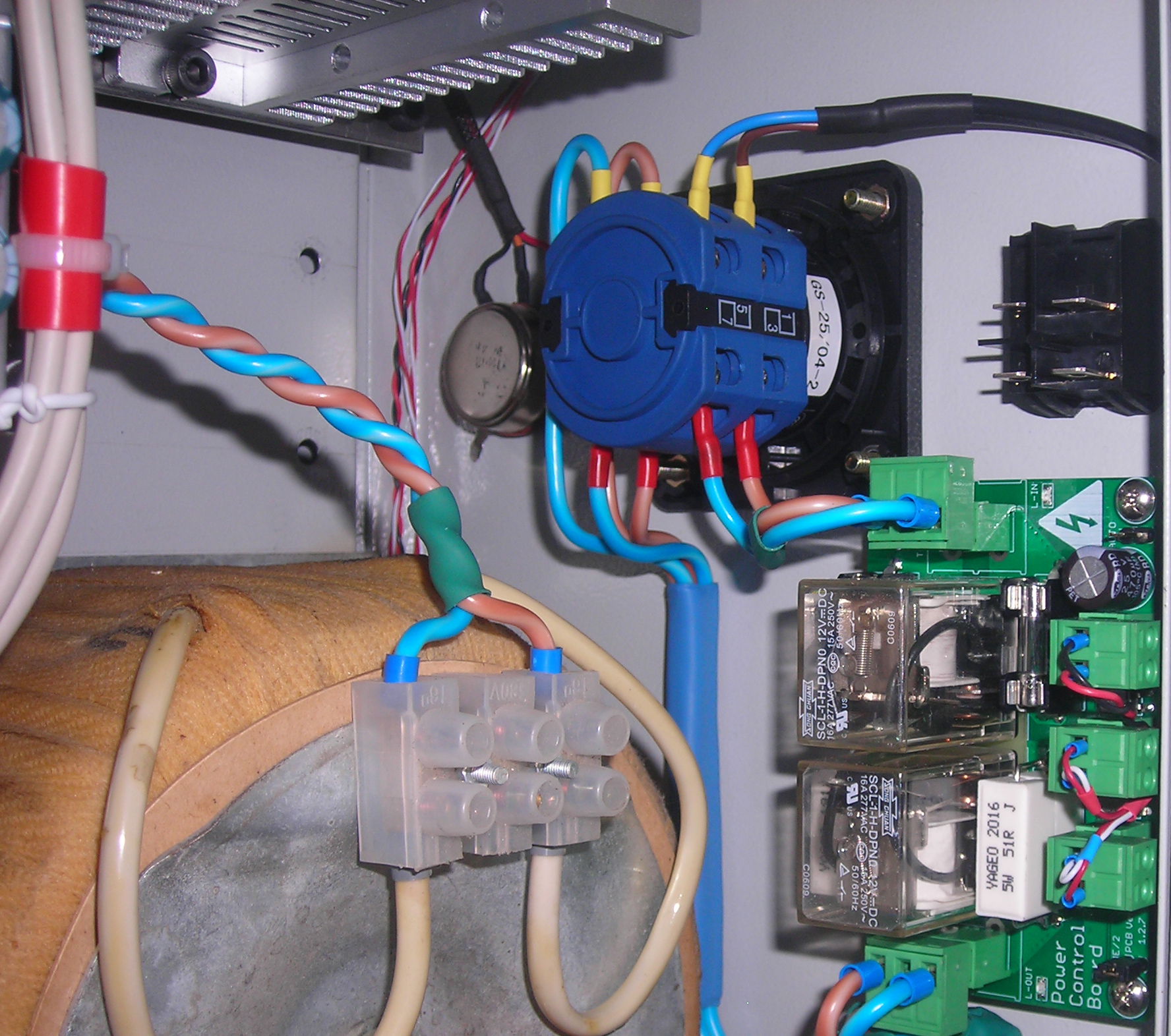

10 Aug 2023 18:25 - 10 Aug 2023 18:28 #277556 by D.L.
My device, power relay with soft start function(inrush current limit):
