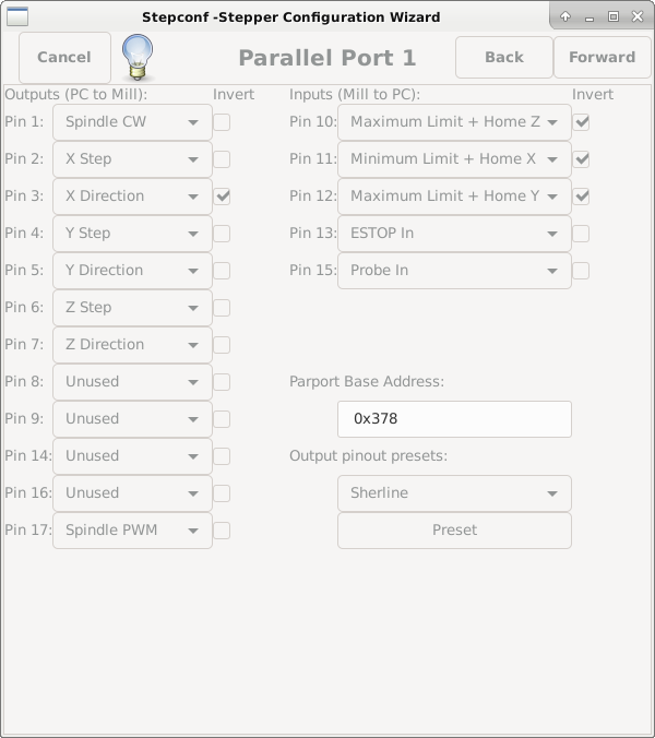

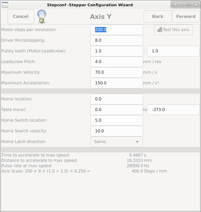

i cant figure out the right config of the Y axis. The forums suggest enable pin inversion, but there is no enable pin in my config. I attempted to import Mach3, which did nothing and it put me back to the first page of Stepconf. So, no way out there. I ended up copying the Mach config by hand from Mach3 config tab to Stepconf. Stepconf test works, program does not. Inverting Y step or dir, or both has no effect in program.
Configuration:
1 - spindle CW (DIR in Mach3, does not matter - its actualy enable)
2 - X step
3 - X dir (inverted)
4 - Y step
5 - Y dir
6 - Z step
7 - Z dir
8 - unused
9 - unused
10 - home Z
11 - home X
12 - home Y
13 - ESTOP inv.
14 - unused
15 - PROBE inv.
16 - unused
17 - SPINDLE PWM
When i try to jog, X and Z are moving just fine, but Y just steps one at the time. Yes, i found this issue in the stepper diagnostics, subsection 1.1.1 , which i gave a try and the axis ended not moving at all.

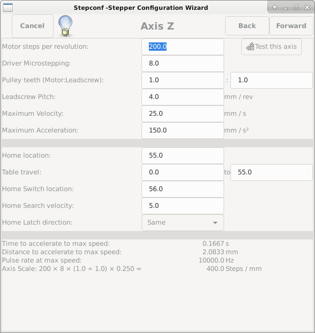

Also have a look at post #55 of this thread on a french forum. Shows the stepconf screenshots for, what seems to be, the same machine.
www.usinages.com/threads/cnc-3040z-dq-ai...ion-linuxcnc.109743/

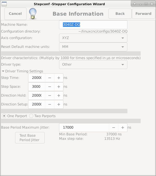

So as a first suggestion I would try with increased timing values:
Step Time: 5000
Step Space: 5000

Just noticed that you have set the axis length to 0.002mm for the Y axis. I'm not familiar with the stepconf tool but I think it's likely because your Home Switch Location is set outside of your 'Table Travel'.
Note the MIN_LIMIT and MAX_LIMIT values in the [JOINT_1] section of your ini file.[JOINT_1]
TYPE = LINEAR
HOME = 0.0
MIN_LIMIT = -0.001
MAX_LIMIT = 0.001
Replied by Aciera on topic 3040Z-DQ Y axis working in stepconfig, not in program
Step Time: 5000
Step Space: 5000
[edit]
TYPE = LINEAR
HOME = 0.0
MIN_LIMIT = -0.001
MAX_LIMIT = 0.001

That was it, i changed the min/max in the .ini and it works. The question why Stepconf edited all axis but Y remains.
