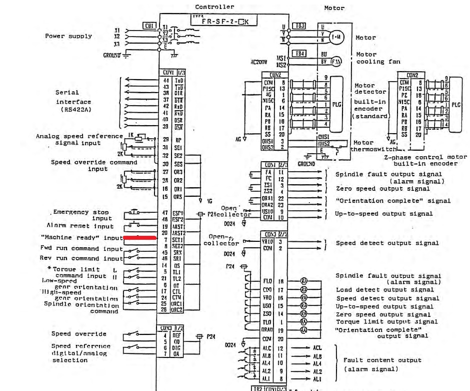

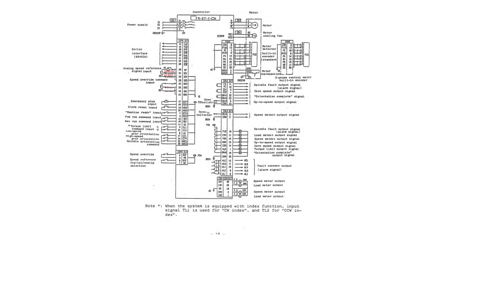

I have another question about the wiring of my VFD; below is the schematic of my VFD
should i wire the white wire to aout5 and the green wire to gnd?

- Posts: 18115
- Thank you received: 5334
05 Sep 2023 20:28 - 05 Sep 2023 21:44 #280028
Replied by PCW on topic Configuring spindle 0-10V - 7i77
Yes, white wire to AOUT5 green wire to GND
