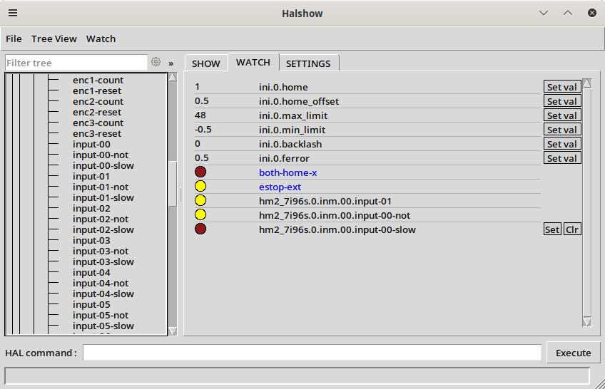

The only suggestion I have at the moment is to use the 'halscope' tool and look at 'hm2_7i96s.0.inm.00.input-01-not' while trying to home the x axis.

23 Sep 2023 14:20 #281476 by Aciera
Ok, tried that and the state never changes (if that is what you were expecting).
If that is 'hm2_7i96s.0.inm.00.input-01-not' when homing the x axis then no, that is not what I was expecting. Since this is you home switch for that axis it would need to change once the switch is activated. If you press the switch manually do you see the signal change?
You can also use the 'show halconfiguration' tool or the 'hal meter' just to be sure that this is not a set up issue in the halscope tool.

23 Sep 2023 18:52 - 23 Sep 2023 18:55 #281497 by Sparkman61
Replied by Sparkman61 on topic Pulling my hair out trying to get homing working!
I made a few minor changes to the ini and hal files so attaching them here.  Also, running Show Hal Configuration while homing the x axis (joint_0).  The attached image doesn't change.  However, I can see the indicators on the 7i96s board light up (actually go out) when the limit/home switch is actuated.  I'm guessing that  hm2_7i96s.0.inm.00.input-00-not indicator should change from yellow to something else - right?
