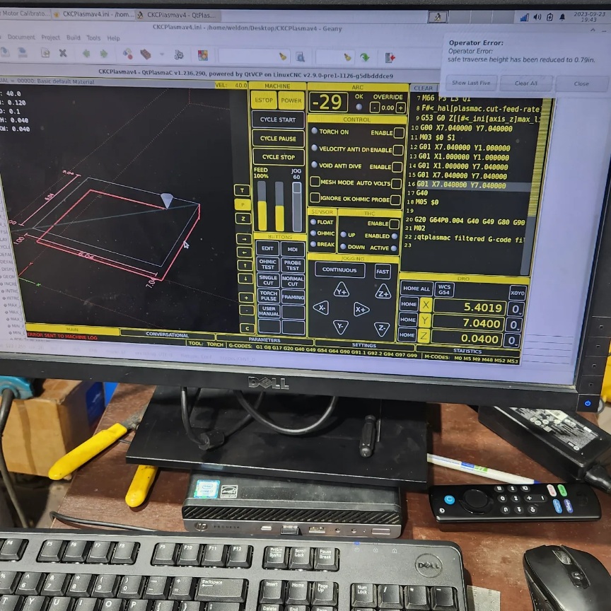

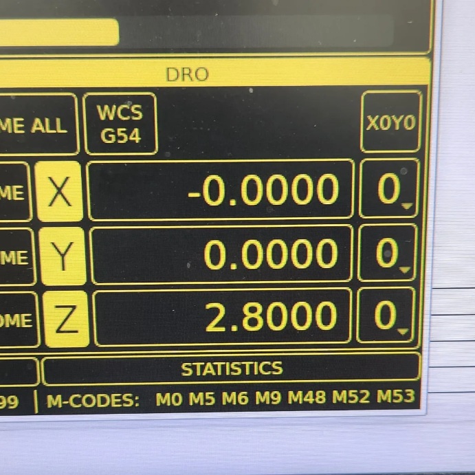

I have been working on this for a few weeks and I have come to the point It seems I don't know enough or have confused myself to the point I can't tell if I am coming or going.
In an effort to teach a man to fish could I ask one of you to just give me the outline of what I should be using to determine the correct parameters.  I was trying to use the below diagram to come up with the recipe but I am outsmarting myself I think...
The switch does work and and I can get some function so the TB3 setup is correct I think. The limits/homing is killing me.
My Z has a 3" travel with a combined proximity limit/home switch at the top Z+ and float switch on the torch holder.
I am thinking the ideal was Z max height at 3" bu maybe that was not correct, should home be 0 and the slats be -3"?
I got it working with home at 2.75" but for some reason I decided that was not correct and I tried to change something (can't even remember what now) and I broke it.
There is not much point posting my  HAL or INI because I have changed so much but I suppose I will put the INI in here anyway, just be aware the current config is miles from where I started.

Since you are certainly over the "we can fix this" line, start fresh, do a new config (you can have as many configs as you like, be it for a single machine or multiple machines), PncConf wizard is really good at having what most machines need at default, so leave everything at default regarding homing.
If you want to try fixing this, first make sure the direction of motion is correct, minus goes down, plus goes up, and change the limit values, max should be 0 or something just above it while min should be negative for almost any machine, then
omit the offset or set it to 0
set the home_velocities to very low so you can actually follow what is going on while homing.
HOME_OFFSET = -.25
HOME_SEARCH_VEL = 0.16667
HOME_LATCH_VEL = 0.16667
HOME_FINAL_VEL = 0.16667
If when pressing home:
machine moves away from home switch = add - in front of search_velocity value
if after hitting switch first time continues past switch = add - to latch velocity
if it moves past switch after backing off and hitting switch second time =add - to final velocity

After MUCH MORE trial and error before seeing your reply I got it to "work".
I found many problems with my limit/homing but I also found I had the velocities set waay to high causing lost steps which exacerbated the limit/homing problems.
I noticed a "buzz" or "beep" sound that was actually the motor stalling instead of positioning.
Here is the INI from the current working config, before comparing to your suggestion.

I think I have it dialed!First successful homing of the project.
even air cut a 6"x6" square.
