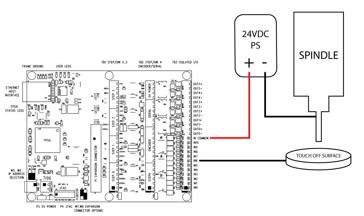

Evening all,
So the time has come to get a Z height touch off probe set up on my router.  I want to integrate the surface that gets touched off on to a fixture which would speed things up no end for a repetitive job I've got in the pipeline (many tool changes using sub 1mm end-mills...)
I found an excellent tutorial here and I just want to double check that I've understood the wiring up bit correctly.
I already have 24VDC going to my IN COMMON (pin 12) as my limit switches are NPN and my spindle chassis is connected to mains earth.  Basically I'm asking - do I connect up the probe like so:
Or have I woefully misunderstood the assignment?
Obviously there're other things to be done with the software and working out probe height relative to workpiece etc., but he's done a really good job of describing the necessary steps required to get this up and running.
Thanks in advance for any advice, notes of caution etc.
Wal.

02 Oct 2023 19:39 - 02 Oct 2023 21:35 #282090 by Waldemar
Spent some time on this earlier and have now sorted it.  The answer to my original post above was yes, that'll work just fine.
The info in the link that I included was of limited use - perhaps a little outdated - but it did the job of illustrating (to me anyway) the process involved to get this set up.
I did find a better link with info that worked perfectly - here you go:  www.diycncdesign.com/linuxcnc-2.8-touch-plate-probe.html
Everything appears to be working exactly as it should, there's just one observation I have:
If I double tap the crocodile clip on the spindle it triggers the limit switches - if I tap the crocodile clip slowly, or just clip it to the tool then there's no problem, but if I tap it rapidly (or fumble it clipping it on) then I trigger the limit switches.  Is this an electrical noise issue?  It's not too much of a problem for me, but if anyone can offer any pointers on what's causing it, what I can do to mitigate it etc. I'd appreciate it.

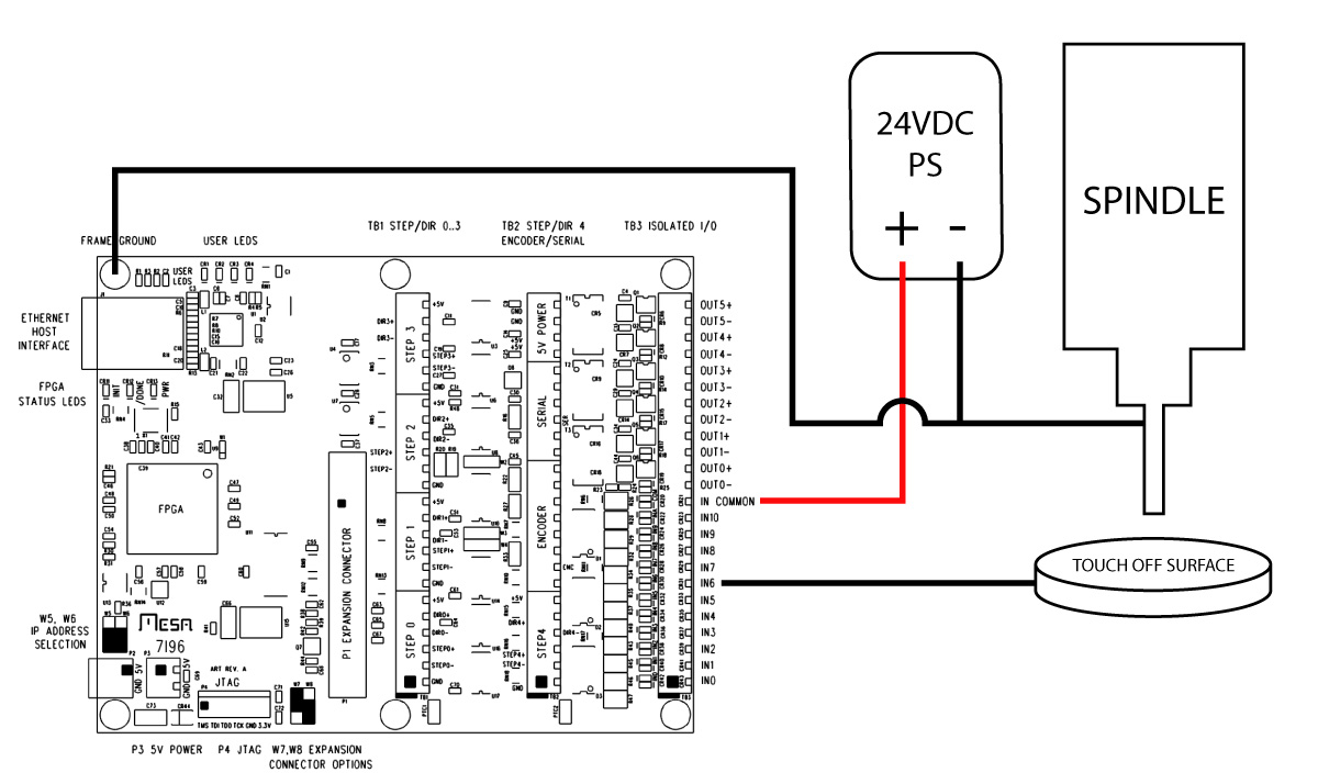

02 Oct 2023 21:39 #282096 by PCW
As far as noise goes, is the 24V common connected to frame ground?
  • Waldemar
  • Waldemar's Avatar Topic Author
  • Offline
  • Senior Member
  • Senior Member
02 Oct 2023 22:01 #282098 by Waldemar
Not inside the control box, no.  It'll be connected to the mains earth by virtue of being in contact with the spindle / frame of the router.
Wal.
02 Oct 2023 22:27 #282100 by PCW
So its actually connected to the router frame (not just the spindle proper)?
You don't want any situation where the rotating part of the spindle can be at a
different potential than the spindle motor/frame
I would ground the 24V common to Earth ground in the control cabinet
Like so?  ie. attached to the same place that the MESA card is grounded to which, if I recall, shares mains earth with the higher voltage stuff inside the case...  I appreciate that's not ideal and that in an industrial setting you'd typically want to isolate the two into their own separate earth pits, but I don't have that luxury.  Perhaps doing it this way would increase the noise, rather than calm it..?
Wal.
03 Oct 2023 00:17 - 03 Oct 2023 00:18 #282106 by PCW
The issue I seen is that the spindle has only a weak ground path through its bearings
and you may cause current to flow through the bearing (which causes bearing damage)
 Spindles can also build up static which can cause noise and ESD damage
I still think the noise situation will be better if the 24V common is returned to
earth ground. (the 7I96 frame GND should be returned to earth ground separately)

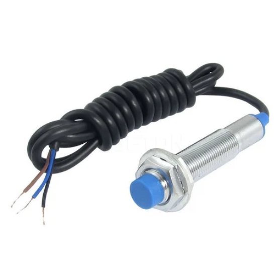

03 Oct 2023 08:41 #282139 by Waldemar
Thanks for your advice.
I wonder whether it would be worth me making some new mounting brackets for my limit switches in hard plastic?  I use the ubiquitous proximity sensors (pictured) and at the moment they're mounted to a metal bracket that's connected to the router frame.  Perhaps if I isolate them from the frame of the router..?  Just thinking out loud...
Wal.
