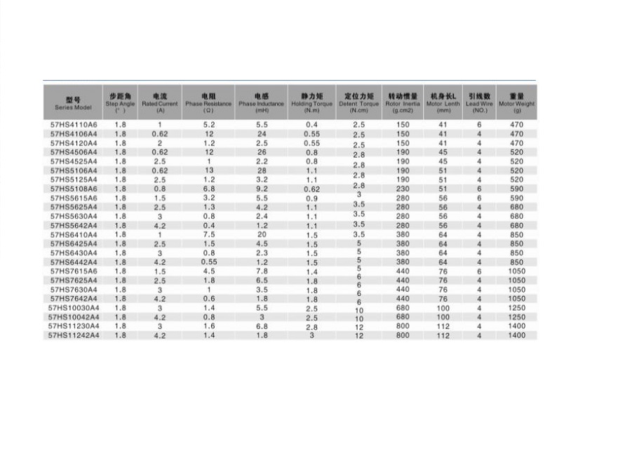

thanks tommy very informative, im using dm542 drivers with a meanwell 36v power supply and nema 23 steppers, im supposed to be running at 4.2a peak 3.0a rms but checked my wiring and im actually running them at 2.84a peak 2.03a rms. the stepper motors and drivers came with a kit i bought from china for the cnc, the tutorial for the kit says to run them at 4.2a peak 3.00a rms but the mounts for the steppers are 3d printed so advice is to tone it down a little till you can mill some metal ones but my setting seem a little low, im using the half current at idle setting on the drivers so they dont get hot at idle, 57hs10030a4 is the model of driver and ive uploaded the spec sheet. i was thinking that others have used 1/5 microstepping 1000 steps per revolution with the same kit , so i was going to change to the higher setting of 4.2a peak 3.00a rms and change to 1/5 microstepping as i think the controller board which is a cheap parallel breakout board is what is struggling to produce the 2000 steps, so if it can cope at 2000 pulse/rev for 4000mm/m it should be fine at 1000 pulses/rev at 8000mm/m the extra voltage may help also, but after what you said im only going to be cutting wood, some hardwoods and maybe some aluminium and mild steel at some point, i need to mill some aluminium stepper mounts and if 4000mm/m is enough for my needs then ill leave it as is, if it aint broke dont fix it, when i have better motor mounts made im going to make a new config in stepconf and up the driver settings to the 4.2a peak 3.00a rms, and change to 1000 pulses/rev just to see if it is the breakout board thats the caveat, and if theres any differnce in cutting quality from 2000 to 1000 pulses per revolution, as i thought 2000 pulses per revolution would make for finer details and rounder circles ect being achievable instead of switching down the line, thankyou again for the info and taking time to reply i appreciate it, also thankyou rodw for taking a look,
Last edit: 09 Oct 2023 08:10 by handsomebeast.
