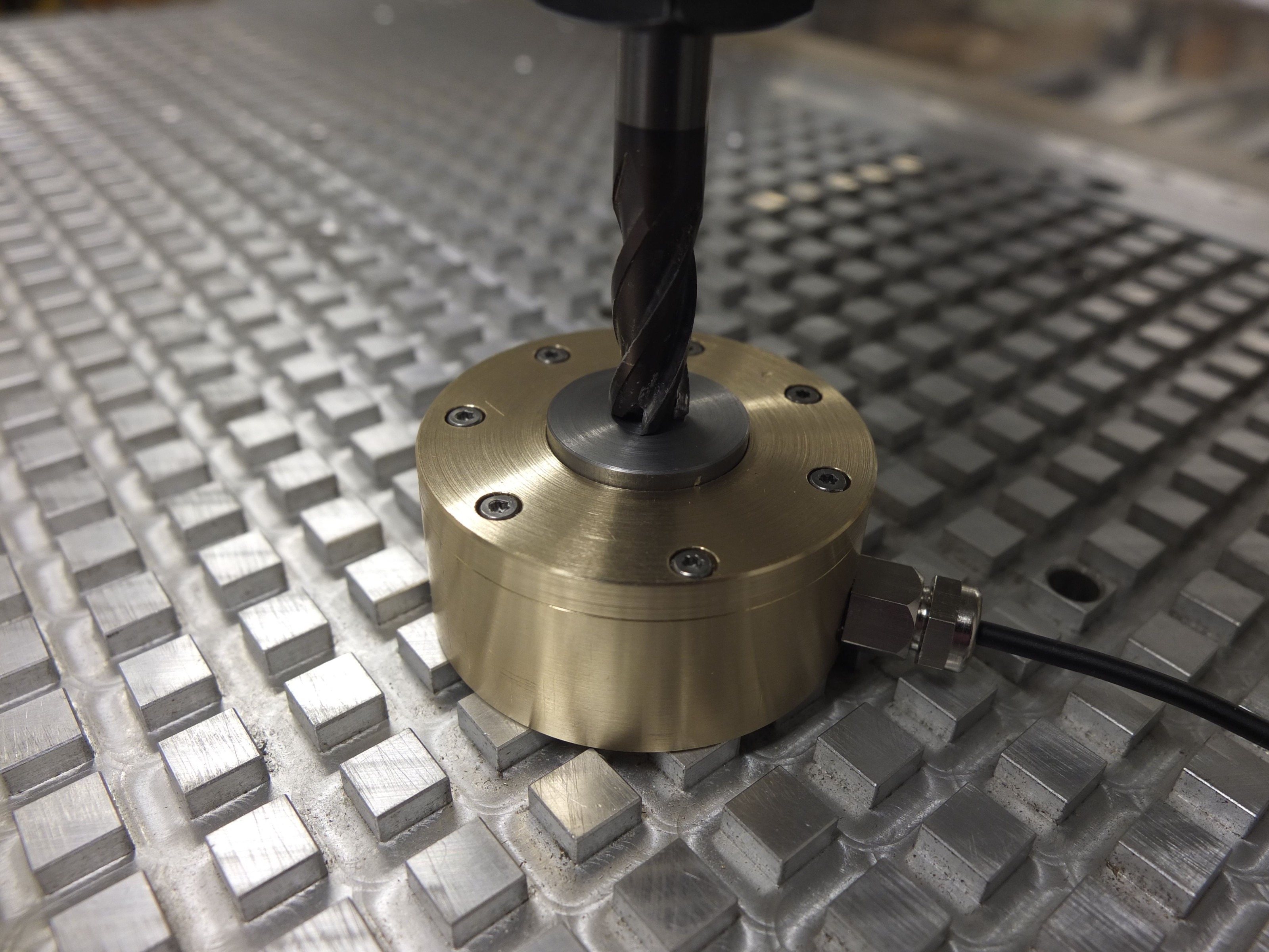

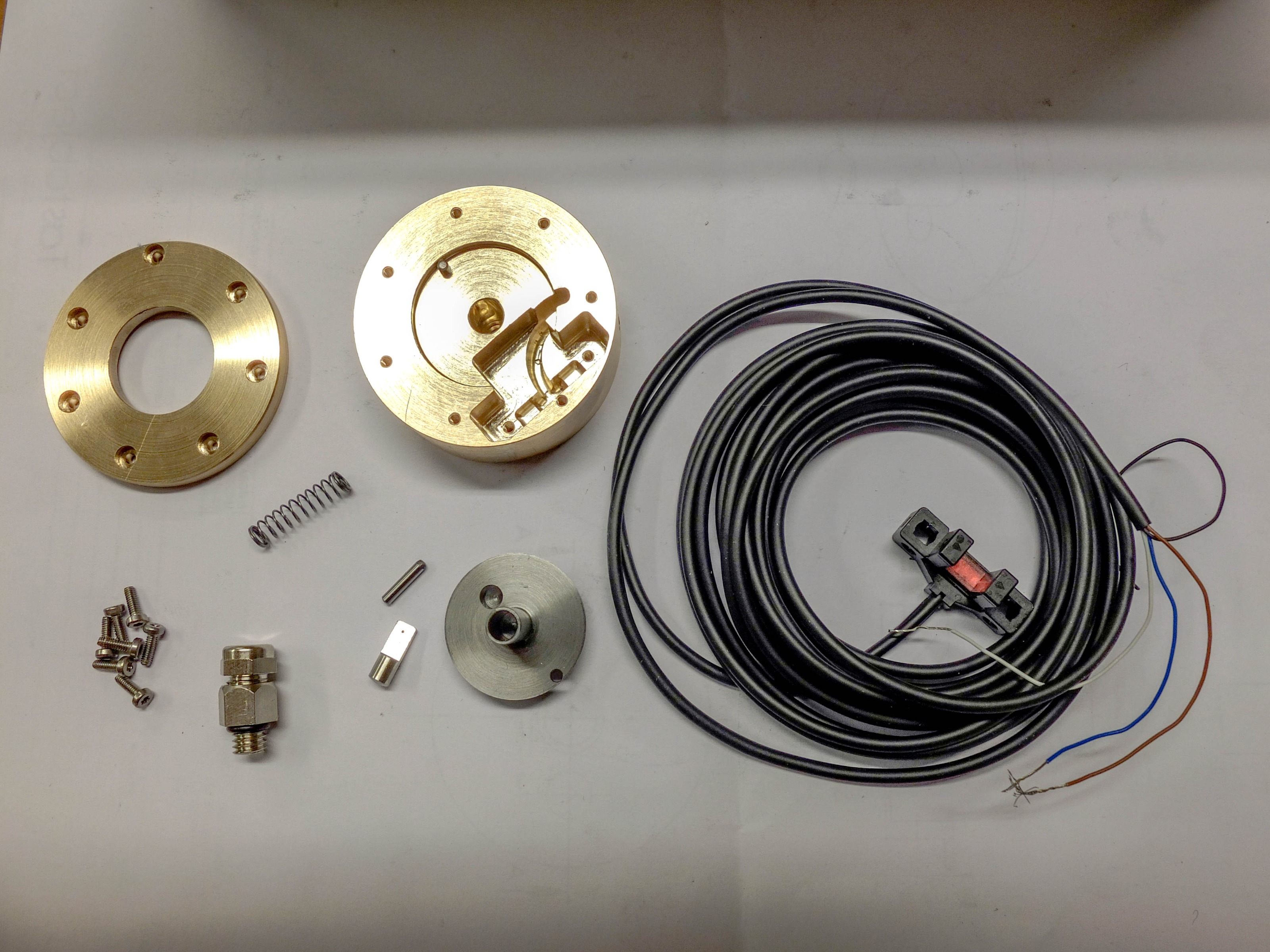

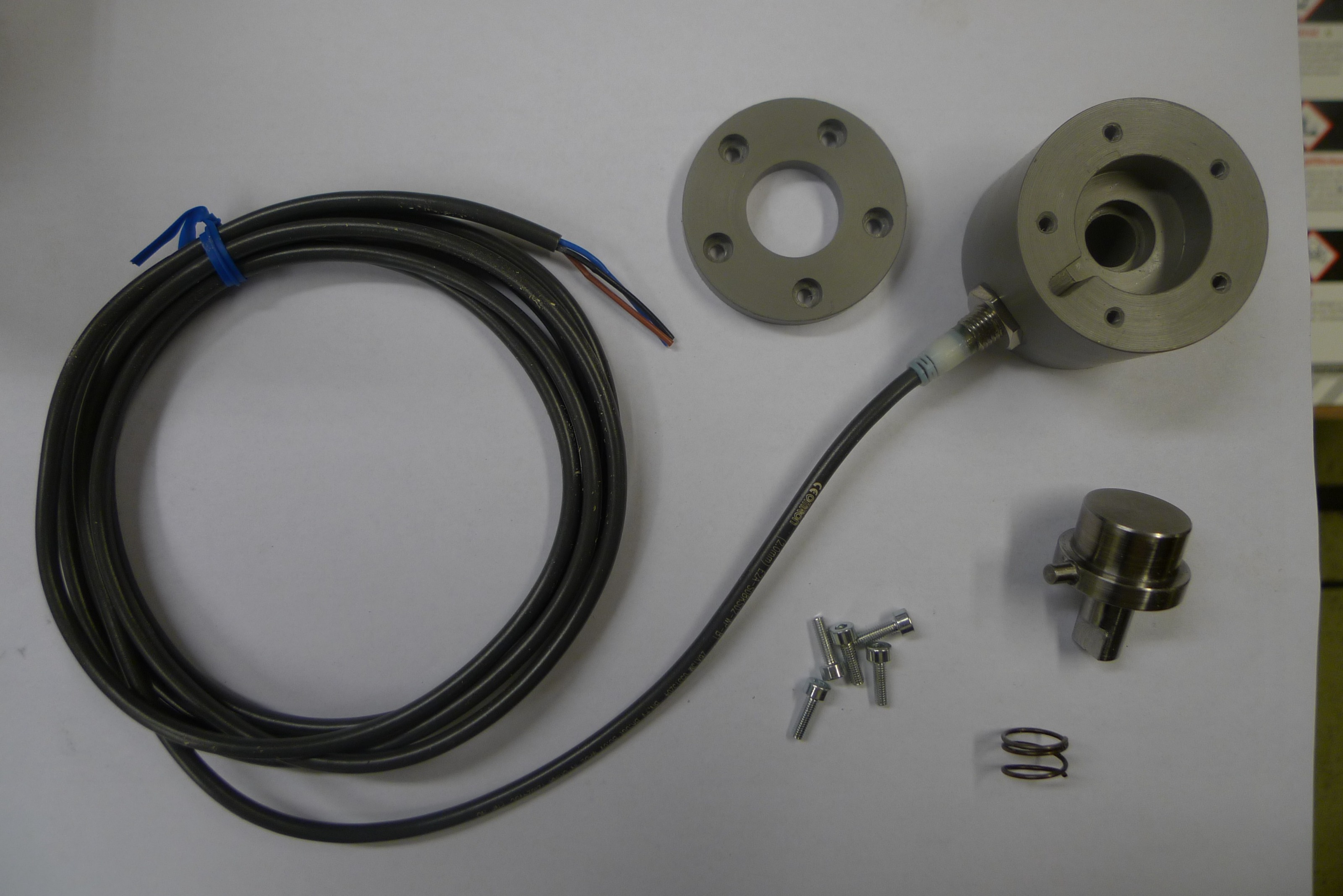

- MaHa
- Posts: 542
- Thank you received: 241
05 Nov 2023 10:48 #284607
by MaHa
Replied by MaHa on topic Newbie need help, touch plate making.
If you google for cnc toolsetter, some results of seller may show.
Years ago i made toolsetter myself, both need only a few parts. One larger item with induction switch, not so difficult to do, if some machines are available.The other one, pancake style, optoelectric, is more difficult to do, as the parts must be pretty accurate. It is mainly used now, because of the size and weight.The are no drawings available anymore, so this is just for inspiration, what can be done with little effort.
Then the probing routine is another task, some interface have already probing integrated, or routines are found in this forum.
