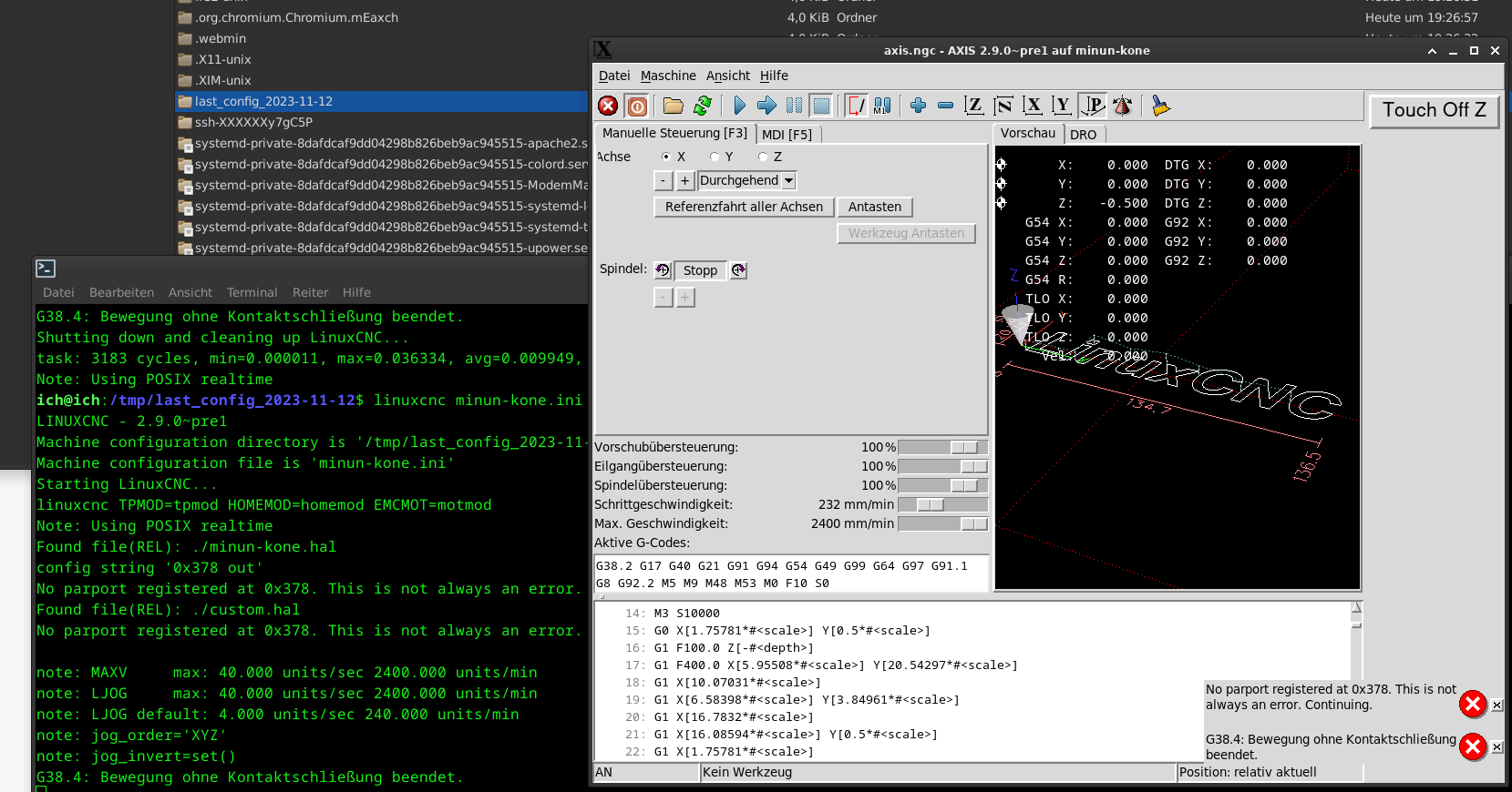

This is not possible. In my simulator, works you config. What is the first line of 9000.ngc, where you save it and match the path in ini?
I attached your config again. Ready to work
Clean up your config folder. Check the path and first line of 9000.ngc
It must be "O9000". Nothing else.
I explain what config needs to be touched. This works for sure.
If not is the error 30cm in front the screen.

i download and open zip and copy all config folder and paste my linuxcnc config folder all this dfiles and not working ,same error come alltime
EOF axis.ngc and row 0. same what before ,
ewerytime same error if bush Z touch button.

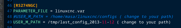

In the minun-kone.ini file, this path must be adjusted:
[DISPLAY]
PROGRAM_PREFIX = /home/masa/linuxcnc/nc_files
[RS274NGC]
USER_M_PATH = /home/masa/linuxcnc/configs ( change to your path)
SUBROUTINE_PATH = /home/masa/linuxcnc/configs ( change to your path)
actually your probing leaves the machine in incremental mode (G91) , so G90 is needed in the preamble. And Z offset is set by your probing, so don't use G43, in case tootable has toollength set. it wil disturb.
Replied by MaHa on topic Newbie need help, touch plate making.
- There were 3 times 9000.ngc, 2 of them false.
- You did not adjust path for USER_M_PATH and subroutines. It will never work without doing that.
- I removed all files, not necessary or even disturbing, just to bring this to an end, and now is only 1 possible config to start.
[DISPLAY]
[RS274NGC]

That's really strange. I extracted this zip file to /tmp/last_config_2013-11-12 and modify lines 48 and 49 in your minun-kone.ini file. After running linuxcnc, it seems to work for me. I get error that G38.4 not finish because i have no hardware. But file 9000.ngc is running.
Could you try the same way? Or could other users try it?
