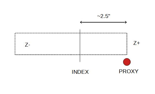

I'm struggling with homing. Not quite my first LCNC rodeo, but this is my first attempt at home-to-index and i can't seem to get either axis sorted out.
As it stands, the index pulse is found during homing, but it doesn't look like the DRO is updating with the correct HOME_OFFSET value... causing the axis to overtravel during the final move.
For Z axis (lathe)...here's what I want to happen:
INI values
HOME = 0
HOME_OFFSET = -2.5
HOME_SEARCH_VEL = .1
HOME_LATCH_VEL = -.1
HOME_FINAL_VEL = .1
HOME_IGNORE_LIMITS = YES
HOME_SEQUENCE = 0
HOME_USE_INDEX = YES
- Z moves positive to proxy (located close to hard EoT)
- Z moves negative to index
- DRO set to Z-2.25" when index triggered
- Z moves positive 2.25" and stops
- i.e. short of proxy by 0.25"
- DRO reads Z0 at final resting point
- Max softlimit is Z0
- Min softlimit is Z-12

I had the home_offset too large and got confused which direction to calculate from.
Home to index is working now, minus the end-stop crashy part.
Repeats to +/-1 encoder count. Really need this so I don't have to indicate my subspindle centerline every time I use the lathe.
Thanks gents.
