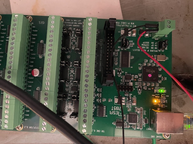

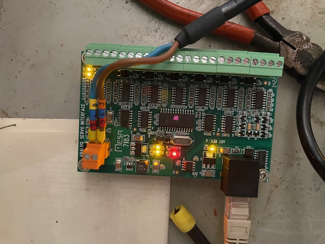

I have been working on and off for a couple of months now to get my Bridgeport Interact 412 to move with the analog drives. I've completed a mach4 retrofit and it was a breeze. I now have to admit I need a little help. The 7I95T is being powered by a benchtop power supply with confirmed 5V and the 7I83 is being powered by the machine with 24V. I am getting a Parameter or pin not found error and I have a fault light on the 7I83. I would like to know if there is a way to access or decode fault on the 7I83 and is there a database to give more descriptive breakdowns of the debug description?

You have the 7I83 connected to sserial channel 0 in your hal file:
hm2_7i95.0.7i83.0.0.analogout1-scalemax' not found
But the 7I83 is physically connected to sserial channel 1:
Board hm2_7i95.0.7i83.0.1 Hardware Mode 0 = standard
Board hm2_7i95.0.7i83.0.1 Software Mode 0 = analogout_enables
