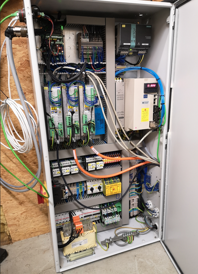

The hardware is connected, see attachted. Thats not the problem I think.

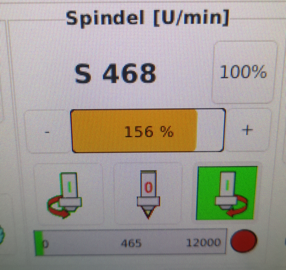

At this point I can switch on the spindle and set the speed. My spindle has max 10k RPM so 1:1 to the GUI displayed value.

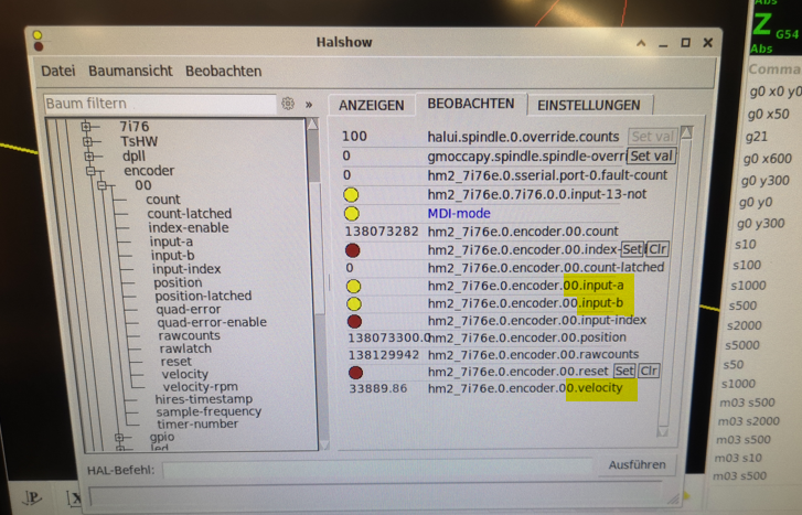

- How can I connect my encoder (spindle speed feedback) to the GUI and set the spindle is at speed window in accordance to this feedback?
The encoder feedback is working in the HALshow. Just A and B Encoder is ok. Index Signal is not wokring. The calculated velocity speed is about factor 66 to 69 (Could the factor be 2/3? I have resolver feedback in the motor. No discrete encoder). That means the velocity = 66 * real speed of motor.

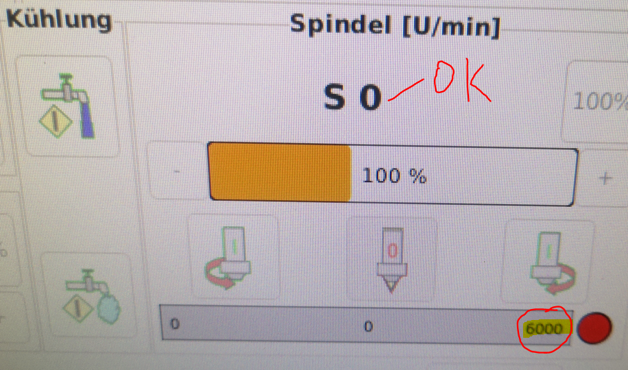

- In the GUI there is a fixed value (6.000) in the grey bar below spindle control. I think this is the feedback value, right? Here I will need my 10.000 RPM. The red LEP will change to Green, when the spindle is "at Speed" / "in defined window" , correct?
- Just for understanding: When I will try to do synchronized tapping / threading then the Z Axis will be feeded in the spindle speed by the encoder feedback, correct?!

I tried something by setting the "hm2_7i76e.0.encoder.00.input-index" Bit in Halshow.
Then I turned the motor by hand one round and the bit was reset. I marked this position on the motor wheel. It´s reproduceable. So that means my Z Signal is working?! It´s not really possible to measure by a multimeter on the Z+ / Z- Pins. I think the Signaltime is to short by turning the motor.
For the index I am not sure if I have it or not.

The spindle encoder scale can be set in pncconf or by editing the .ini file
You set the index-enable signal and check that it gets cleared in the same
rotational position when the spindle is rotated by hand. If index-enable is only
cleared at one repeatable position, index is working.
The actual index signal is often quite a narrow pulse to hard to check in other ways

Ok, I found some information out and yeah, it´s very easy to get result if you know for what you have to search for
I dind´t noticed the section "parameters" in Halshow until now. Now I found the Encoder Scale for the 7i76e there!
BTW: My Scale is 1000 / - 1000.
I was able now to get the Feedback in RPM from the Encoder and forwarding this value to the gmoccapy speed-bar.
But I am not able to get the spindle-at.speed-signal to work.
I used the near function like everybody else is doing I think. I watched the input values in the halshow. They are correct. But the output of near is everytime false. In my oppinion it should work fine?! Could somebody have a look please?
After everything works well. I will post a small summary.

Do you have:
addf near.0 servo-thread
in your hal file?
in your hal file?

Oh no, i did not had this.
Now it works.. Thank you very much PCW. You brought my maschine to life!
Main things should work for now..
