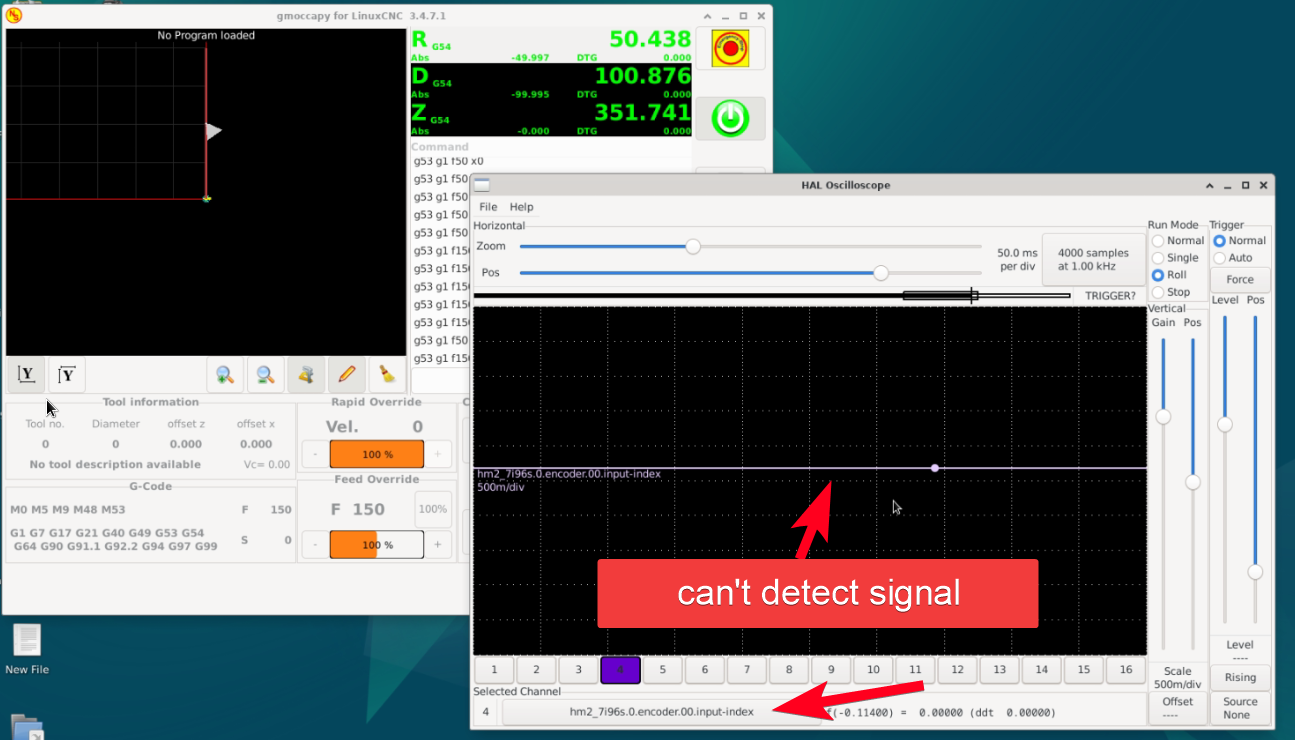

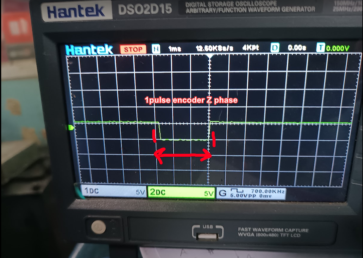

Hi
I use 7i96s for Lathe
I use encoder for X-Axis feedback control.
A,B phase encoder run good and can feedback control.
then I change in ini file change to HOME_USE_INDEX = YES , for use home index with Z-phase encoder.
I click home Z use mechanic home switch its work good.
I click home X use index home when x axis touch home switch will back off but it's not stop it's keep walking.(before change to index home i use home switch good work.).
I try use osihoscope check Z phase , scope can detect 1 pulse every 1turn motor.
I try open Hal scope in linuxcnc open signal hm2_7i96s.0.encoder.00.index-enable I run x axis and observed but no any change.
please help what i'm setup wrong in hal or ini file please.

In general its not likely that you can detect the index signal with halscope
since it only samples the hal pin at 1 KHz and the index pulse will tend to
be much shorter.
The way to test index is to (with halcmd -kf):
halcmd: sets x-index-enable
Then monitor x-index-enable (with halmeter or halshow)
to see if it gets cleared at the Index position of the encoder
when the encoder shaft is rotated slowly.

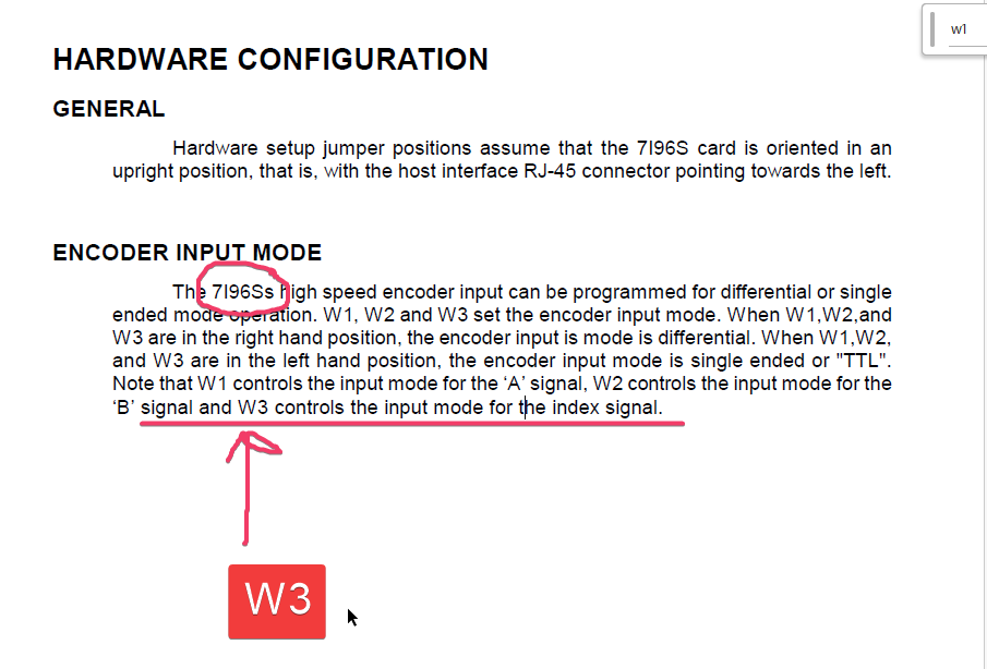

Can you temporarily disconnect the encoder, jumper index for single ended,(W1 left)
and see if grounding the index+ input changes the state of the index pin in hal?
Also can you read the firmware pinout?
mesaflash --device 7i96s --addr [ip-address] --readhmid > pinout.txt
and post pinout.txt here
[ip-address] is 192.168.1.121 or 10.10.10.10 depending on 7I96S address jumpering

You mean for I try to change signal of index encoder from differential to singlw end right ?
I check in manual , explanded about W1,W2,W3
W1 = A
W2 = B
W3 = Index
please make sure for me again change W1 or W3 to left ?
Thank you
W1 = A
W2 = B
W3 = Index

and I try
- W1 to left and try home with index result : same old
- W3 to left can't stop Jog and I think W3 is A encoder now I chnage back to Right position
and I try
