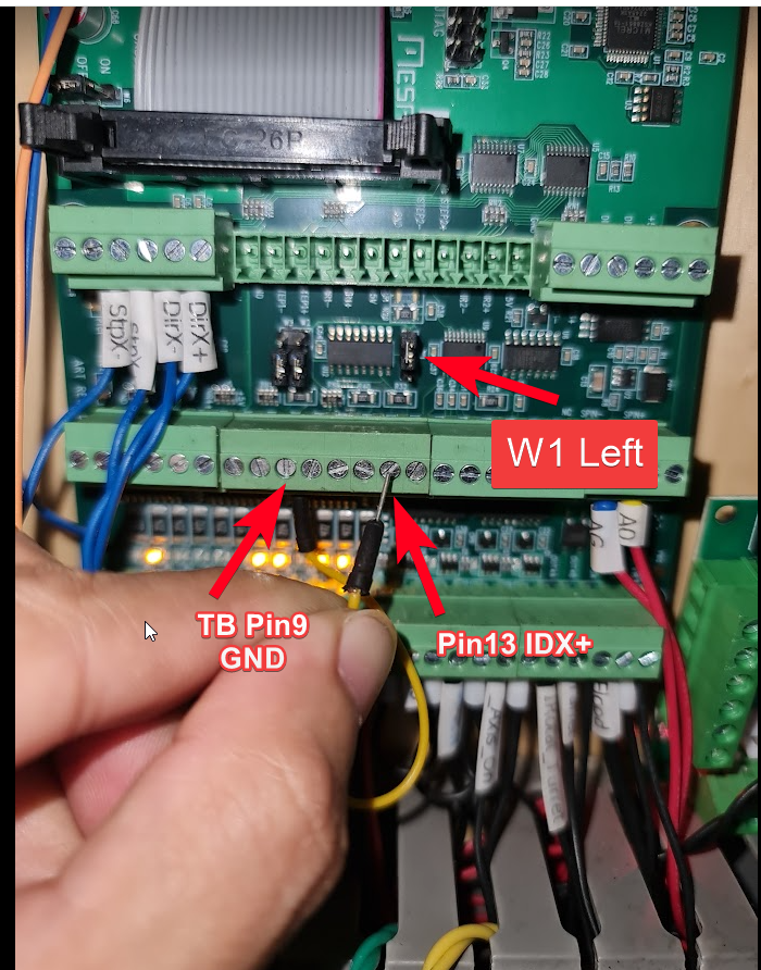

What I suggested was that you disconnect your encoder completely
(unplug the connector at the 7I96S), set the index input to single
ended mode (W1 LEFT) And then monitor the index signal with halshow
and see if its state changes when you ground the INDEX+ pin (TB2 pin 13)
If the hal pin does not change, there is a fault in the 7I96S

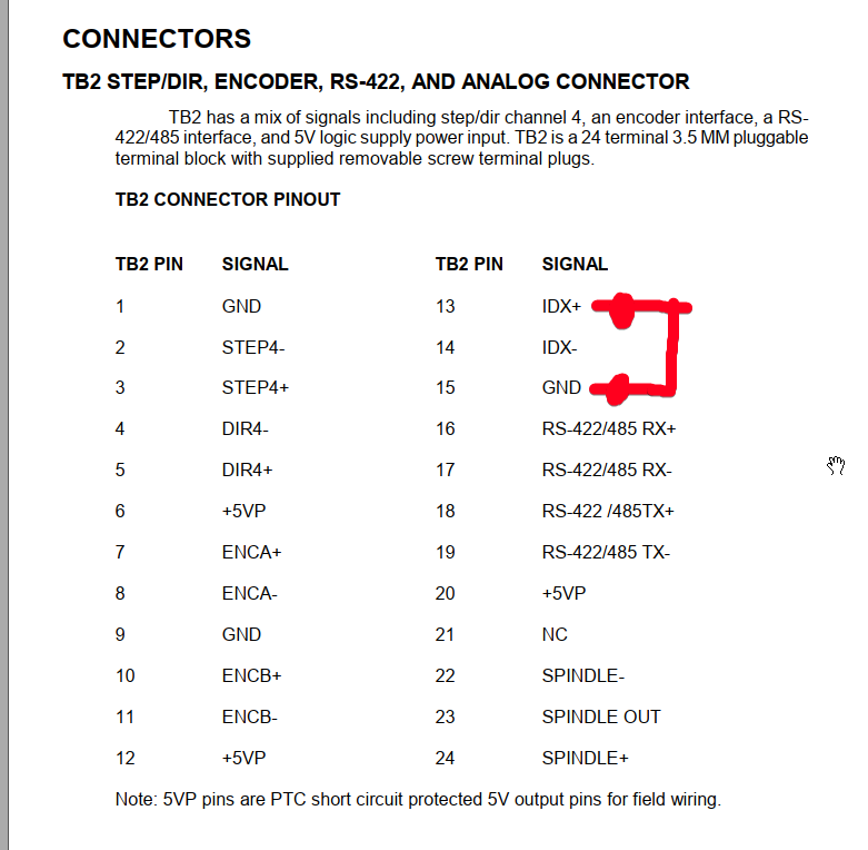

Sorry, I'm give you confirm
You mean after disconnect Encoder ,then TB2 pin 13 connect to TB2 pin 15 right(GND , ground) ?  and monitor .

02 Feb 2024 03:30 - 02 Feb 2024 03:31 #292201 by tommylight
Replied by tommylight on topic Home Index 7i96s can't detect Signal
Yes.

02 Feb 2024 03:56 #292207 by abdulasis12
Replied by abdulasis12 on topic Home Index 7i96s can't detect Signal
Yes.

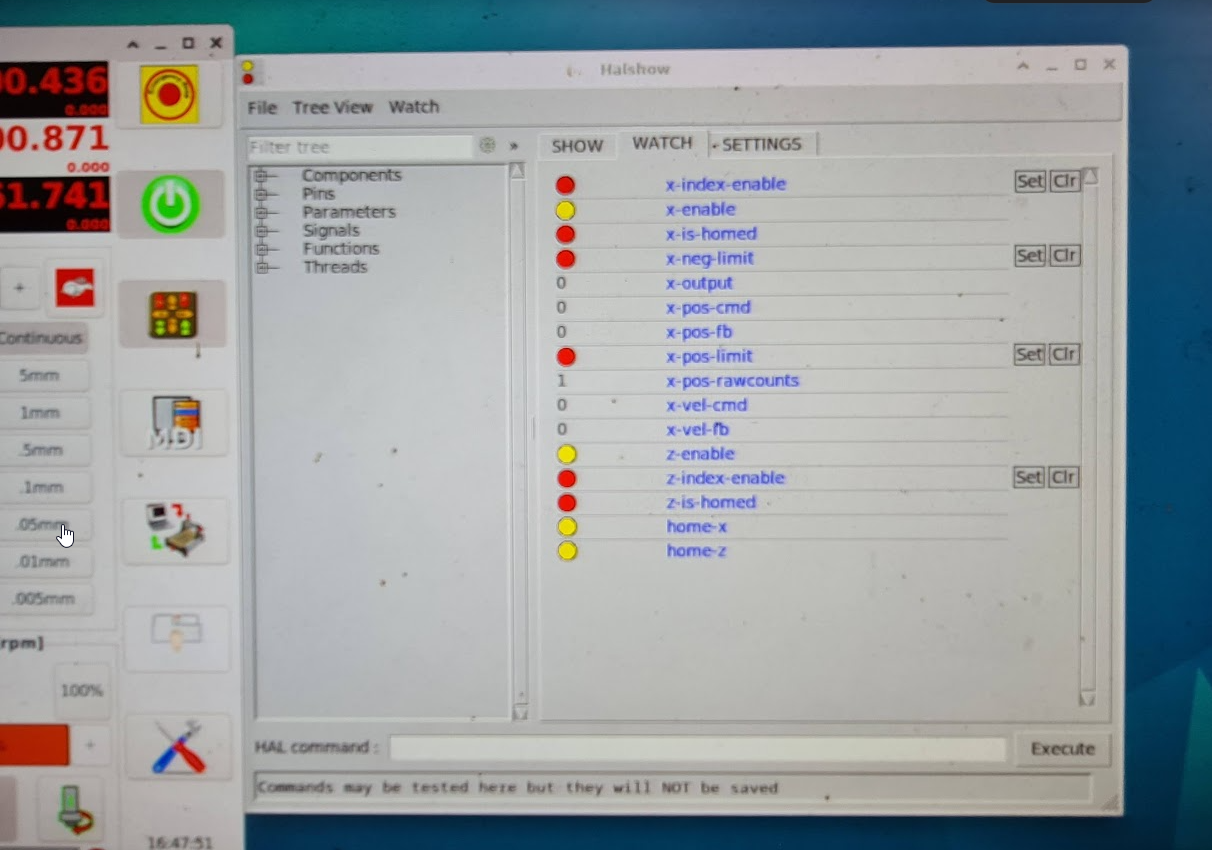

Okay, I open removed all wire terminal encoder and screw yellow wire to Pin9(GND)  and I trig to Pin 13(IDX+).
I open linuxcnc and start control , and not do anything on software only Open hallshow.
My friend behind machine and trig wire to Pin13
Result
On hall show Not any change when my friend connect and disconnect wire  from Pin 9 (GND) and Pin13(IDX+)

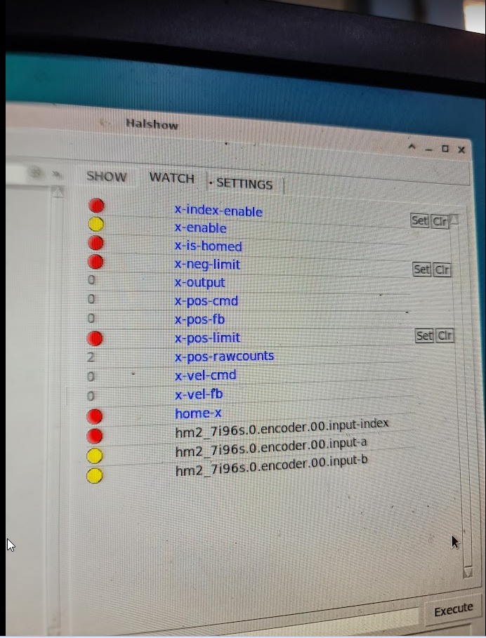

02 Feb 2024 04:02 #292209 by tommylight
You need to monitor the
encoder.0.index
Or similar.
Sorry, on the phone so can not find exact pin name.
02 Feb 2024 09:57 #292225 by PCW
Replied by PCW on topic Home Index 7i96s can't detect Signal
You need to watch:
hm2_7i96s.0.encoder.00.input-index

02 Feb 2024 19:38 #292268 by abdulasis12
Good morning MR.PCW , Tommylight
this result : No any change on index  (when wire connect and disconnect pin9 to pin13)
IC have a problem ??
02 Feb 2024 21:22 #292273 by PCW
Note: You must tighten the screws if you are touching the screw
and expecting it to connect to the input pin.
(I would have just unplugged the connector rather than disconnecting the wires)

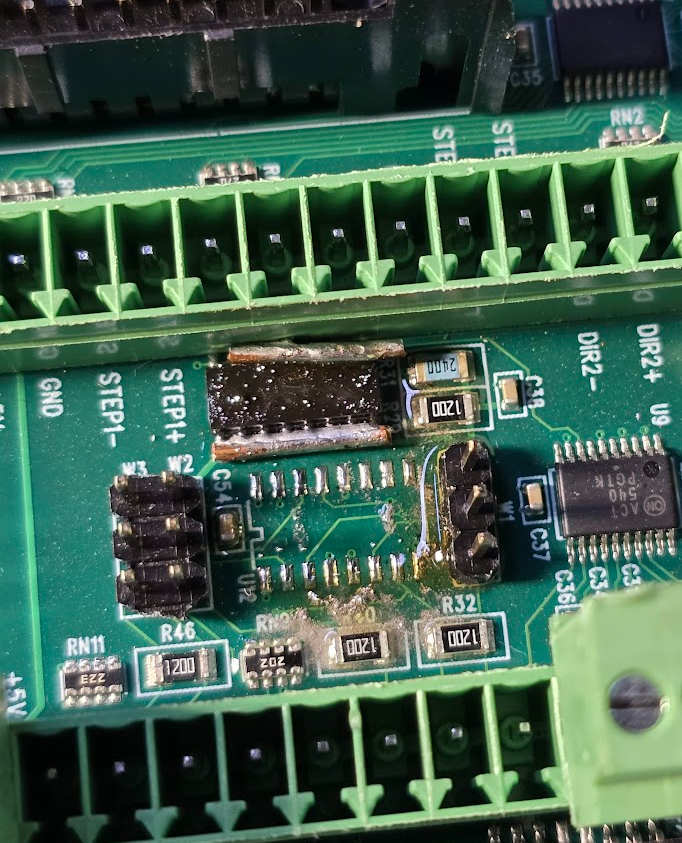

If you still don't get the hal pin to change, its likely the 26LS32 RS-422
receiver  chip is damaged or there is some other fault on the card.
If this is the case, we can send a new card (I would request the card
back for analysis but I expect base on your time zone that
shipping costs both ways would be prohibitive.)

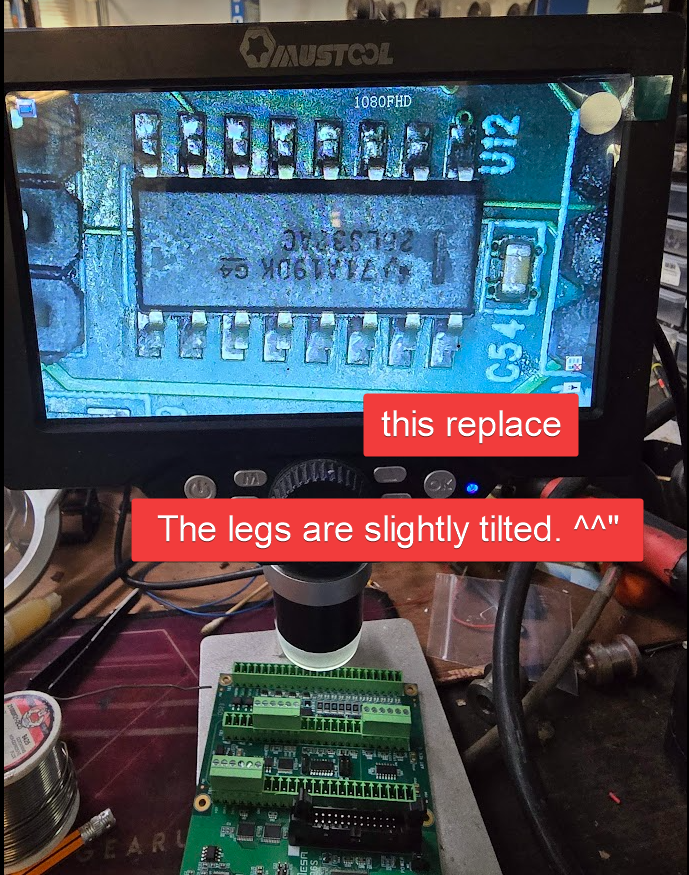

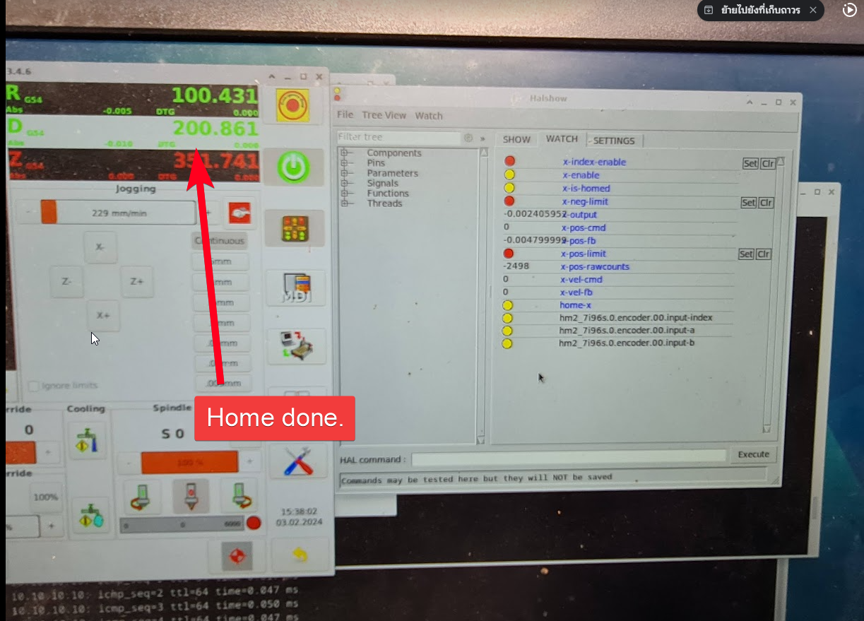

03 Feb 2024 02:47 #292285 by abdulasis12
Hi MR.PCW
I have some update after analyze from you.

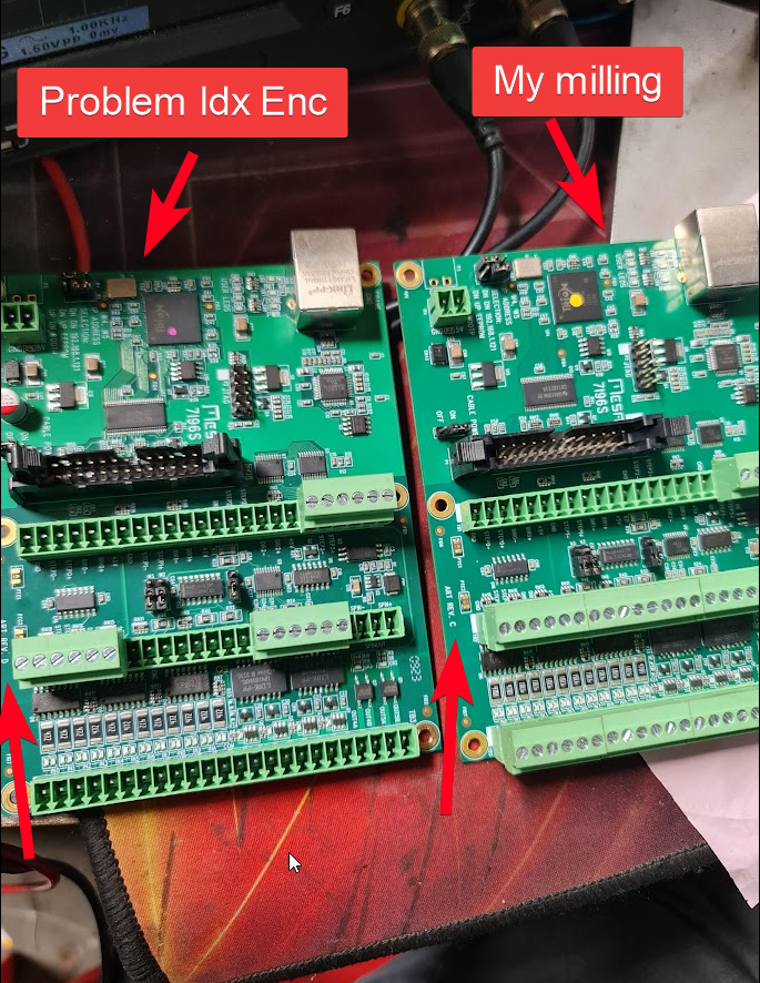

I have 1 more 7i96s  REV.C  from my milling machine I try swap board to my lathe and mesaflash for same old board.
I reconnect all terminal back and change jumper back to default (differential type).
I try Home X , Yes now can Home (DRO show green color and X axis motor stop).
Thank you for help me analyze.
I ever bought 26ls32 IC from China but I Can't find it , maybe if I found it on  next week  I will try to replace and update you again .
If sent back to you for renew board I think not good for me about shipping cost.
Thank you again bro.

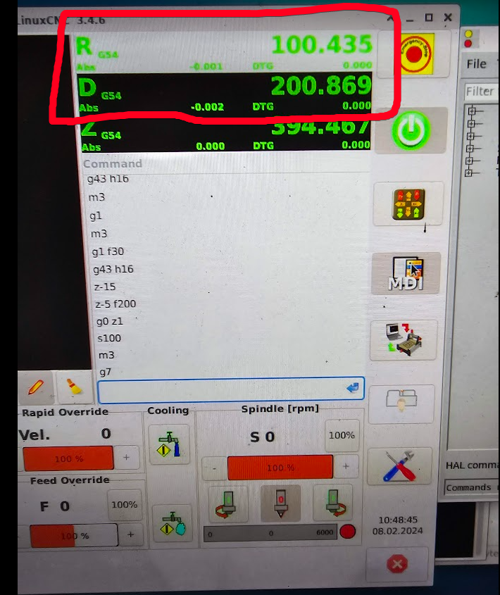

07 Feb 2024 23:28 #292821 by abdulasis12
Hi PCW , Tommylight
Update
I Replace, Now Index signal work !!
Thank you for advice.
Asis,
