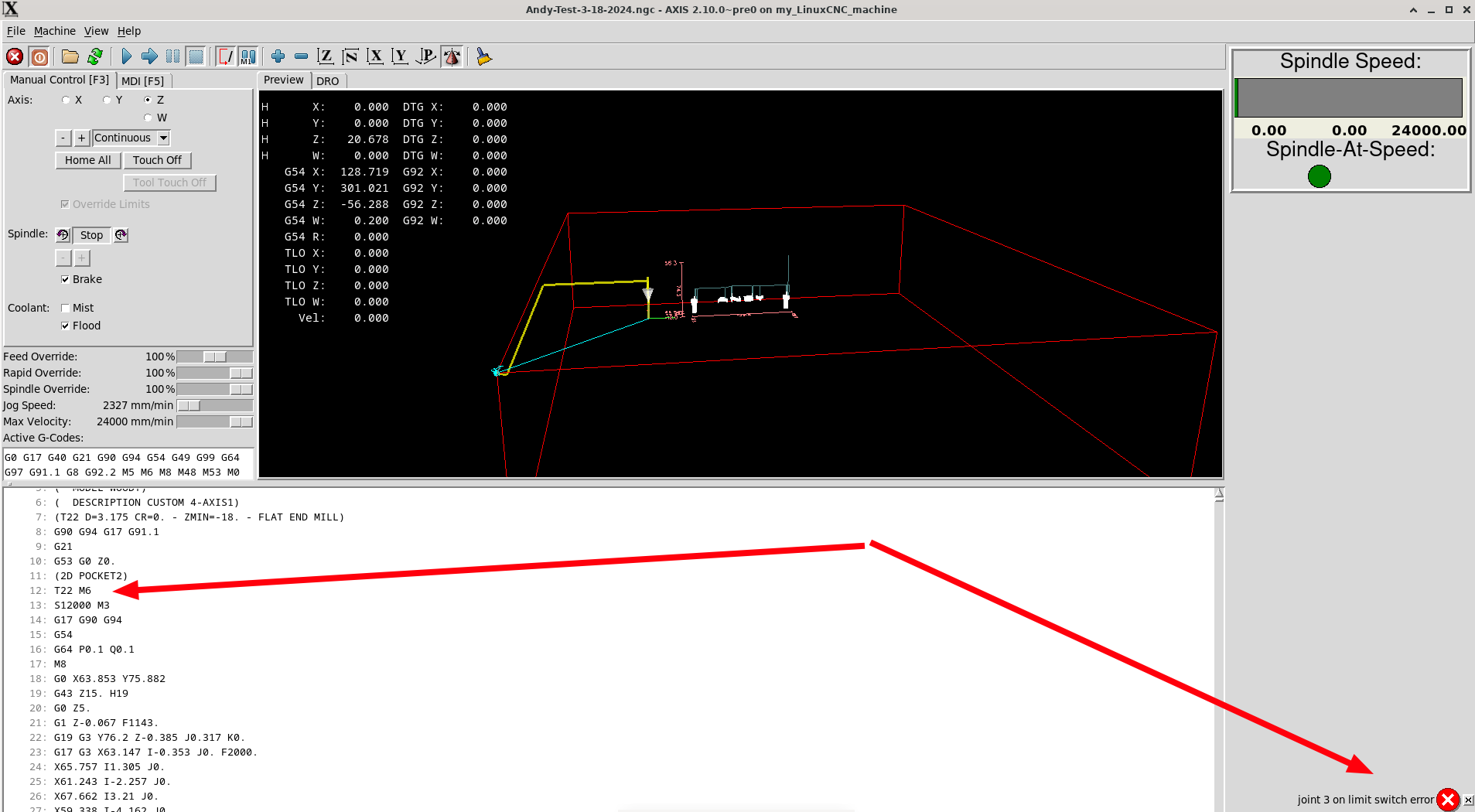

What did I do wrong on this Z -Axis configuration?
180mm travel distance. Single limit/home switch at the top. Positive travels towards switch at the top and negative travels towards the bottom.

Home must be between MIN_LIMIT and MAX_LIMIT
HOME = 8.0 is outside softlimits

Tried that but, it fails immediately when I HOME ALL.

In that case. there is something not right with the configuration of Z axis in the ini file, you must first make it home properly with home set at 0, home offset can probably be -3, but you have to fix home_search_velocity, home_latch_velocity and home_final_velocity so it home properly. All this is done by setting all those to very low values (like 5 for metric) and carefully watching what the Z axis is doing while homing, but first make sure page down on keyboard moves Z axis down, then, when home all is clicked/pressed Z should start moving up, hit limit switch, move down a bit till switch is released, move up again till it hits the switch, then move 3mm down (this is the home offset that you have at -3).
If any of those are not correct, change the value for search, latch, final by adding or removing - in front of the value.

This is what I currently have, the final move which I assume is HOME_FINAL_VEL travels in the plus direction when it should be going to the negative position. I can't tell you how frustrating this is after 4 months of trial and error. However I do appreciate the help!

No, the final move is the offset, you have it negative, try making it positive by removing - in front of 2.

Worked!
