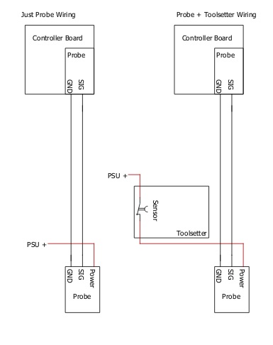

Previously, I have had a tool setter n/c and a two wire 3d probe connected in series to pin 15 of my BOB
I replaced my basic probe with a 3 wire, still n/c one
Wiring instructions
Red - Signal positive
White - Signal negative
Shield ground
I have attached the wiring diagram I have used to hook it up to pin 15 of my BOB and ground. (One on right)
Following the instructions, I don't get the probe internal led to light in standby as it should. If I
swap the white and red wires, the led lights up. Neither configuration will toggle pin 15 as I watch
the HAL pin.
I tried using 5vdc as the source voltage, and 24 vdc. No change.
All of the other limit switch pins are working with proximity detectors at 24v
I have tested pin15 manually with a jumper and Hal toggles.
I have verified with the mfg of the probe that it's in fact n/c. He verified yes, and that the led should light
when not tripped as it's wired in series with the device.
Any suggestions?

Replied by zmrdko on topic New 3d probe
The following user(s) said Thank You: routerman22

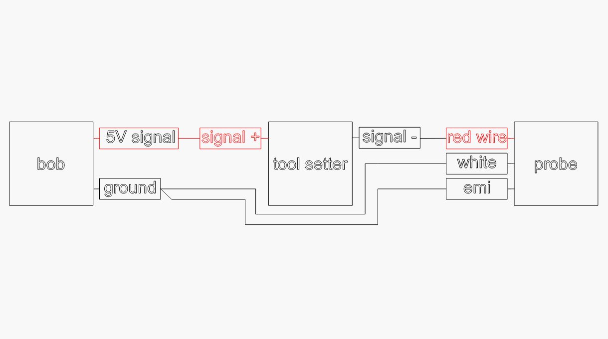

Thank you for your time. It seems that your other way of wiring didn't produce the fix.
I am wondering if I need a pull up or pull down resistor on pin 15?
This probe, when connect to a power supply for testing... supplying 24v to the red wire, against the shield, doesn't illuminate the internal led. But if I connect a meter to ground and the signal out lead, white, the internal led lights. What are your thoughts with this?

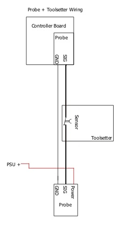

Not sure about the LED but aren't most of these probes NPN? Are you expecting 24v+ out of the signal wire? If it's NPN the signal wire will be ground, not 24v+. If your BOB has a sinking input, you won't the output of an NPN sensor won't trigger it.
Try connecting ground to the shield if that's where it goes, 24v+ to the red wire and measure voltage between the red wire and white (signal) wire with your meter, if you see 24v your sensor has a sinking output (NPN).
If that is the case you can get your BOB to see it by pulling up the BOB input with something like a 10k resistor to V+ then the signal wire of the sensor will pull it down when it's not activated (NC). When it's activated and the sensor switch opens the resistor will pull the bob input back up and you will see an active high

Solved!
Thank you both for your assistance. After a lot of experimenting, trying to get this probe integrated into
my tool setter, the seller / mfg sent me a suggestion. (see attachment) It works.
I would have never thought to try wiring it this way, but it just works. I also have a connector on my gantry
that I use to connect the probe to when setting up a job. When not using the probe, I have a shorting
plug that I put into the connector so that the tool setter still works. With this wiring, that plug works fine.
Great forum.
