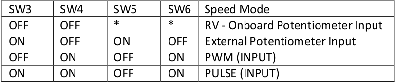

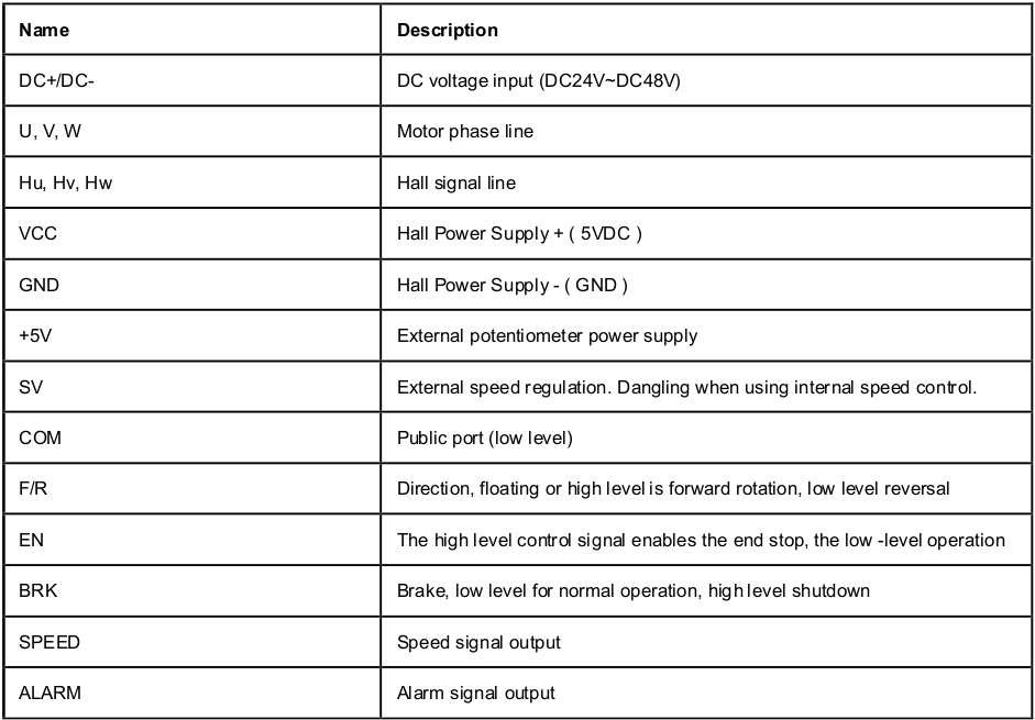

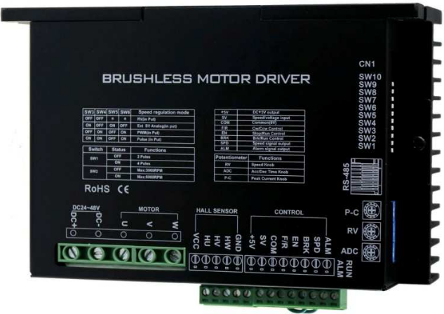

Hello,I have Rhino motion controls 400W BLDC motors with hall sensor and supporting 750W drives that I'm planning to use for 3 axes of the CNC mill.
I'm confused with the PWM input mode and PULSE input mode. 7i76 step and direction signals are pulses right?
TB2P1(GND) ==> COM
TB2P3(STEP+) ==> SV
TB2P5(DIR+) ==> F/R
TB2P6(+5VP) ==> 5V
Is this wiring right after selecting the dip switches on the drive to enable pulse input? or should I do a PWM input with 7i77 instead of 7i76?
TB2P1(GND) ==> COM
TB2P3(STEP+) ==> SV
TB2P5(DIR+) ==> F/R
TB2P6(+5VP) ==> 5V

Yes, that seems the correct wiring.
Mesa 7i77 does +-10V, while your drives seem to be 5V PWM, so using a 7i77 would require limiting the output to +5V only, in hal.
Better use step/dir with 7i76.
You can use 6i25 and 7i76 for 5V PWM, does also require tuning and complicates things a bit compared to step/dir.

Do you have a link to the drive manual?
It looks rather awkward to control via the SV input
since it seems to be a 0 to 5V signal that needs
a separate direction input (F/R)
It honestly does not look like a servo drive
but rather something more suited to fans or
pumps etc.
pumps etc.

Replied by pmchetan on topic Help wiring up BLDC drives with BISSC linear encoder to 6i25_7i76_7i74
robokits.download/downloads/RMCS-6611.pdf
I assumed 7i77's analog signals could be used very similar to an external potentiometer while ordering the drive. They do mention using PLC, PC and modbus for controlling it.
