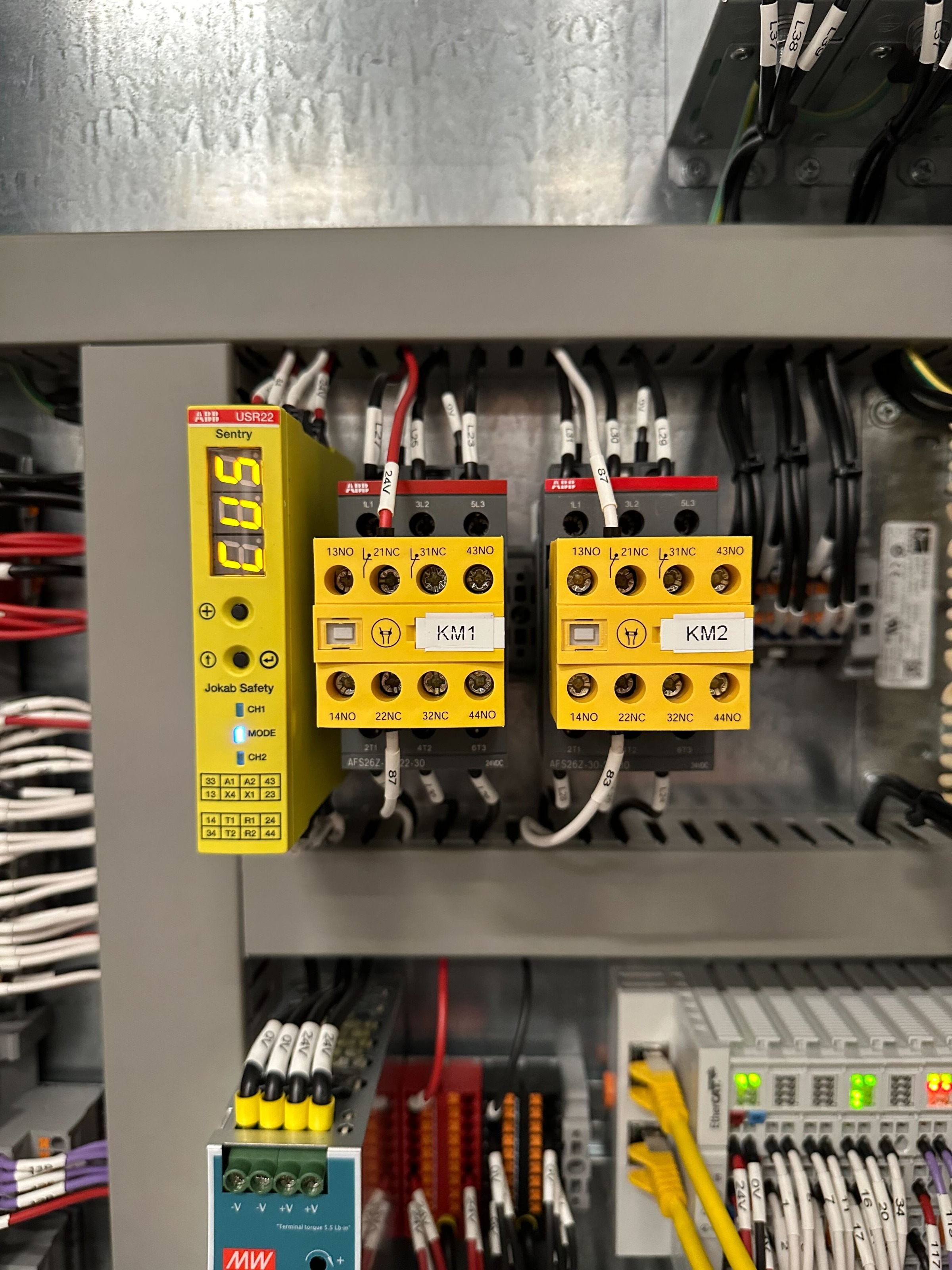

After advise from this forum I built my machines estop functions around a safety relay from Abb Sentry USR22. So i have dedicated hardware just for handling the latching, i have redundant safety contactors to take power to all moving parts and so on. Everything works all by itself and doesn't need LCNC to function. I can run the estop functions with LCNC completely turned off, just as i think it should work.
But I choose the USR22 since it have 2 groups of relays with a timed delay between them. In case of a estop, i'd like to first tell LCNC via the first relay that "shit has hit the fan, stop everything!" This happens via a simple IO-pin. Then after 400ms or so the safety relay will kill the power to servo-drives nomatter what via the 2nd relay...regardless of what LCNC do/did. The idea was that i would give the software a small window to command the servo-drives to do a estop via software(or do a "quickstop", whatever i can make work) and also the possibility to stop anything else that might need stopping, but isn't "deadly"(e.g. floodcoolant pump, liquid cooling system etc)...
But i'm unsure how to wire this in HAL for it to work properly inside LCNC. It seems like all examples are assuming that i just have the estop-button connected directly to a IO pin and then need LCNC to do the heavylifting in software. But this is not the case here. I want LCNC to do a "software estop" as fast as possible and likely also turn off other "non-critical stuff". I would also want LCNC to accept that the estop-condition is resolved whenever the IO-pin changes back again(no extra latching in software, i got all that in hardware). So the estop-latch examples doesn't quite fit as far as i can tell.
The signal from my safety relay is either high or low depending on the state of the estop. I tried to wire this to iocontrol.0.emc-enable-in, but this isn't quite right and i was curious if others have found a good way of doing this "properly"? Or has ideas how to do this?

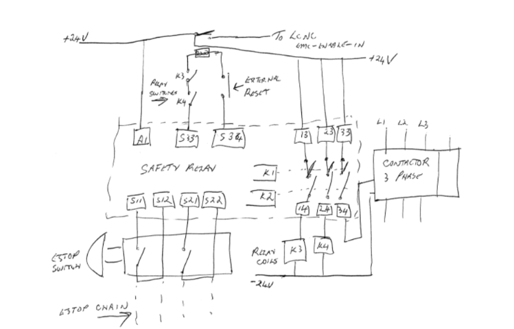

There are two ways to do this. You can either run an external latch (which is a momentary switch) that resets the safety relay. In this case, you should connect a signal to a Linuxcnc input which is connected in hal to iocontrol.0.emc-enable-in This is the approach I took.
There is no need to press anything in Linuxcnc
The other way is to  use iocontrol.0.user-request-enable instead of your external latch. Linuxcnc sends a pulse on this signal to act as the latch when the on screen estop is reset (S34 in the diagram).
When I researched this, this was compliant provided you isolated Linuxcnc (your controller) with redundant relays (K3 & K4). These needed to be force guided relays where a non conducting pin is forced between the contacts when they are triggered to ensure the contacts cannot become welded closed.
It's good that you used a safety relay with a timer in it can retain control until motion stops.

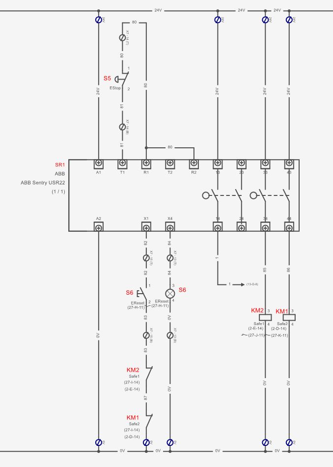

I should have posted a diagram in my previous post, but better late than never. This is my safety circuit:
I'm starting to think that i have to change this. So instead of the resetbutton(S6) goes directly to the safety-relay it actually goes to LinuxCNC. Then LinuxCNC is the only on that can reset the safety relay, just like in Unlogics case mentioned above. The question is then if should have an additional latch inside LinuxCNC or how should i structure the HAL?
A whole other can of worms is that the drives are connected via EtherCAT and uses CIA402, so i need to manage their state when the estop is reset. I have to re-initialize them after a reset, i'm not even sure this is doable via HAL logic...

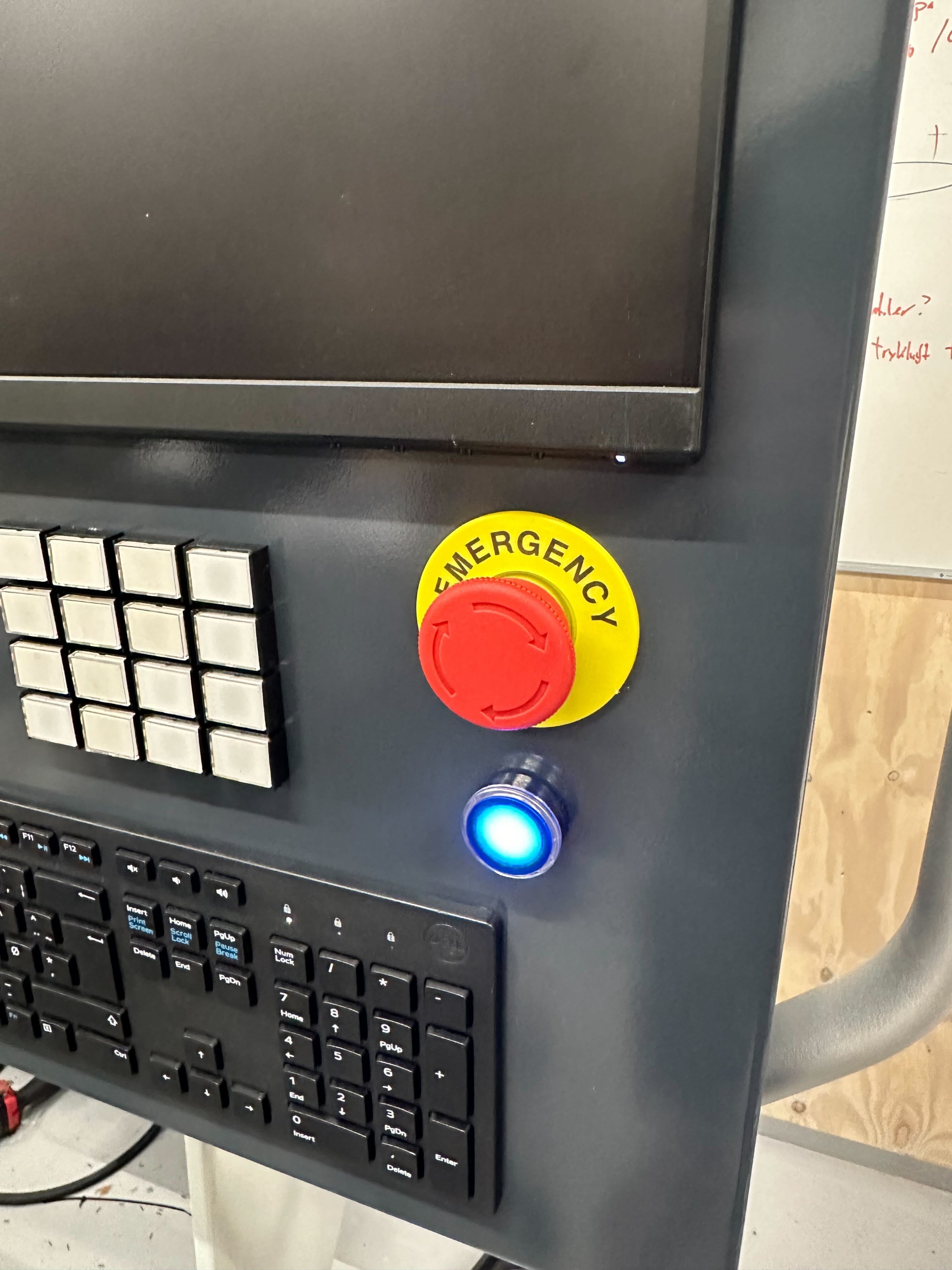

17 Jul 2024 04:16 #305464 by thomaseg
Replied by thomaseg on topic Safety relay and e-stop in LCNC?
Just to give a bit of "physical context", here is how it looks in "real life":
17 Jul 2024 07:19 #305479 by rodw
Replied by rodw on topic Safety relay and e-stop in LCNC?
Looks Good

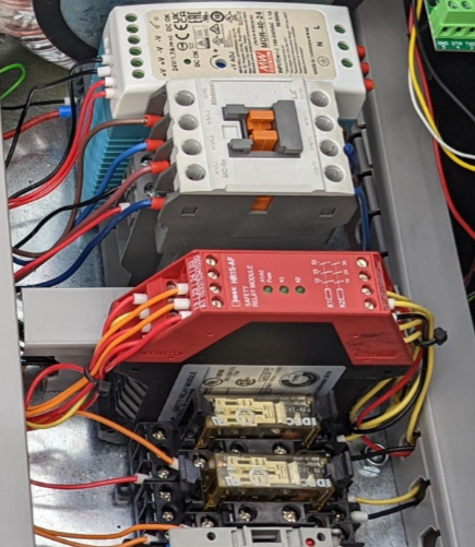

This is mine on a Mesa setup but also have the same on an Ethercat machine
Red Safety Relay, two force guided relays in front of it.

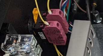

The only thing I can see a bit different is your estop does not have dual circuits. I bought new ones for these safety relays that did. Back of switch shown here. (Brand is Idem, same as relay)
On my ethercat machine, I drop power to the steppers but also use the disable signal on the motors.

Yeah i saw your description in another post and they look very similar. After seeing the discussion you had, i've already decided to do a minor change to the estop-button-circuit. The button itself have a NC and a NO connector, but i'm going to change the NO-contactor so i'm getting 2xNC instead and then put them in series and make that part redundant aswell... thanks for the inspiration ;-)
