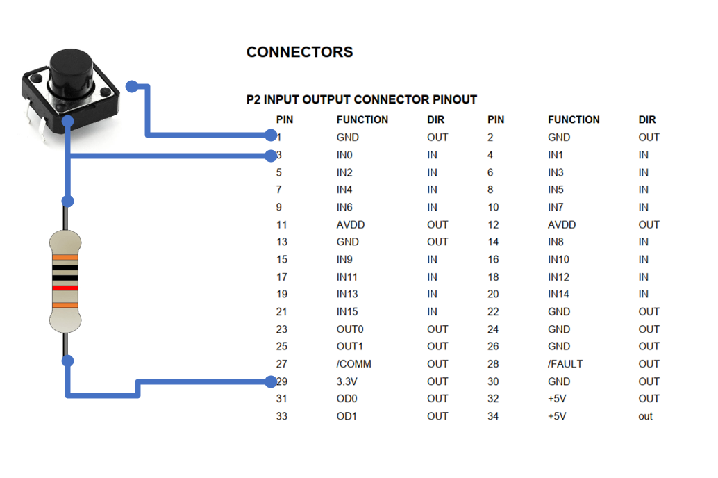

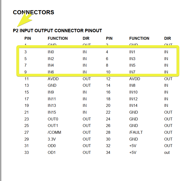

Hi
I use 7i73 and now I use IN9 - IN13 for pendant input(For Sellect X, Y,Z, x1 , x10) and use IN14 and IN15 for encoder pendant
Now I use all bit input.
Now I connect resistor IN3 -IN7 for pull up done.
I want to use IN3 - IN7 for bit input but it's can't recieved 0 , 1 for trig signal (IN3 - IN7 analog input).
How to setup ini ,hal for use IN3 - IN7 for bit input or trig signal ?
Thank you ,
Asis

Replied by PCW on topic 7i73 P2 IN3 - IN7 how to setup for bit input ?
What is the issue with inputs 3..7?
They work as expected for me
(they do need pullup or pulldown resistors for use with switches however)

Hi, PCW
Thank you for fast respond.
Before this problem I use 7i73 input for this
# The Axis select inputs
net axis-select-x <= hm2_7i96s.0.7i73.0.3.input-15-not
net axis-select-y <= hm2_7i96s.0.7i73.0.3.input-14-not
net axis-select-z <= hm2_7i96s.0.7i73.0.3.input-13-not
all work correct
But now I want input 14 and input 15 for encoder 1more , then I try use any input .
I go to input-00 and input-01 for input select axis.
I'm use pull up on input-00 and input-01 (show picture in clip) and try input signal for select X and Y axis
net axis-select-x <= hm2_7i96s.0.7i73.0.3.input-00-not
net axis-select-y <= hm2_7i96s.0.7i73.0.3.input-01-not
I use hall show LED can change when select x-axis and y-axis (Z axis too) from my pendant but can't work for output on input-00 and input01 but input-13 work fine
have any idea ? I will try again .
youtube.com/shorts/ryRGpOwS6_Y?si=10v7SAaK9OYonX4i
Thank you,
Asis

14 Aug 2024 21:32 #307763
Can you post your hal and ini files?
Note that because inputs 0..3 are used for
analog inputs, you may need stiffer pullup
resistors because the input sampling cause
higher leakage currents.

14 Aug 2024 22:51 #307765
by abdulasis12
I try pullup with resistor 4.7kOhm and 10kOhm not difference.
Replied by abdulasis12 on topic 7i73 P2 IN3 - IN7 how to setup for bit input ?
How to stiffer ?you may need stiffer pullup

15 Aug 2024 01:14 #307769
Do the inputs 0,1,13 work correctly?
(as shown in halshow)
Does the encoder count in all modes?
have you set homing for any channel
(you are jogging joints which will only work until homed)

16 Aug 2024 09:44 #307922
Yes, that looks correct.
The following user(s) said Thank You: abdulasis12
