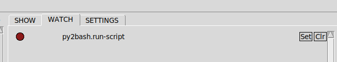

1. Save this as 'py2bash.py' to a folder called 'python' in your config folder and mark executable (You should not need to modify this):
2. Save this as 'script.sh' to your config folder and mark as executable (you will need to change 'halcmd loadusr -W hal_input -K +Keyboard:0 ' to load your component)
3. Add this to [HAL] section in your ini (No need to change this):
4. Run your config and check for a pin 'py2bash.start-script':
5. If you force this pin HIGH the python component should run 'script.sh'
Replied by Aciera on topic Modbus VFD startup delay?
Ah, forgot about that. Here is a solution with a python component that does not rely on MDI:I'll have to turn off forced-homing so LCNC can run an M-code after machine-on but before homing... but that should be fairly simple.

raise SystemExit2. Save this as 'script.sh' to your config folder and mark as executable (you will need to change 'halcmd loadusr -W hal_input -K +Keyboard:0 ' to load your component)
#!/bin/bash
halcmd source myhal.hal
exit 03. Add this to [HAL] section in your ini (No need to change this):
HALCMD = loadusr -W ./python/py2bash.py4. Run your config and check for a pin 'py2bash.start-script':
